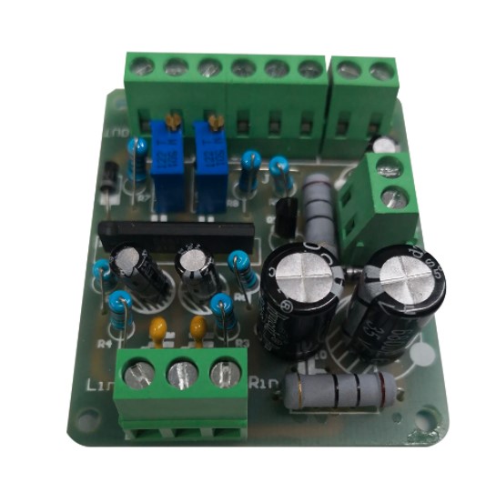

Hi Luca, did you get to use the vu-meter?hello, is possible to connect this vu-meter board to amp outputs?
It seems to have common ground...
