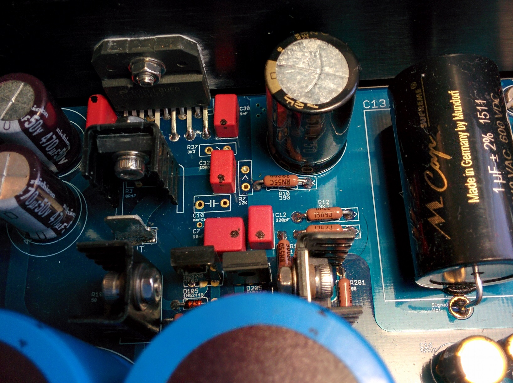

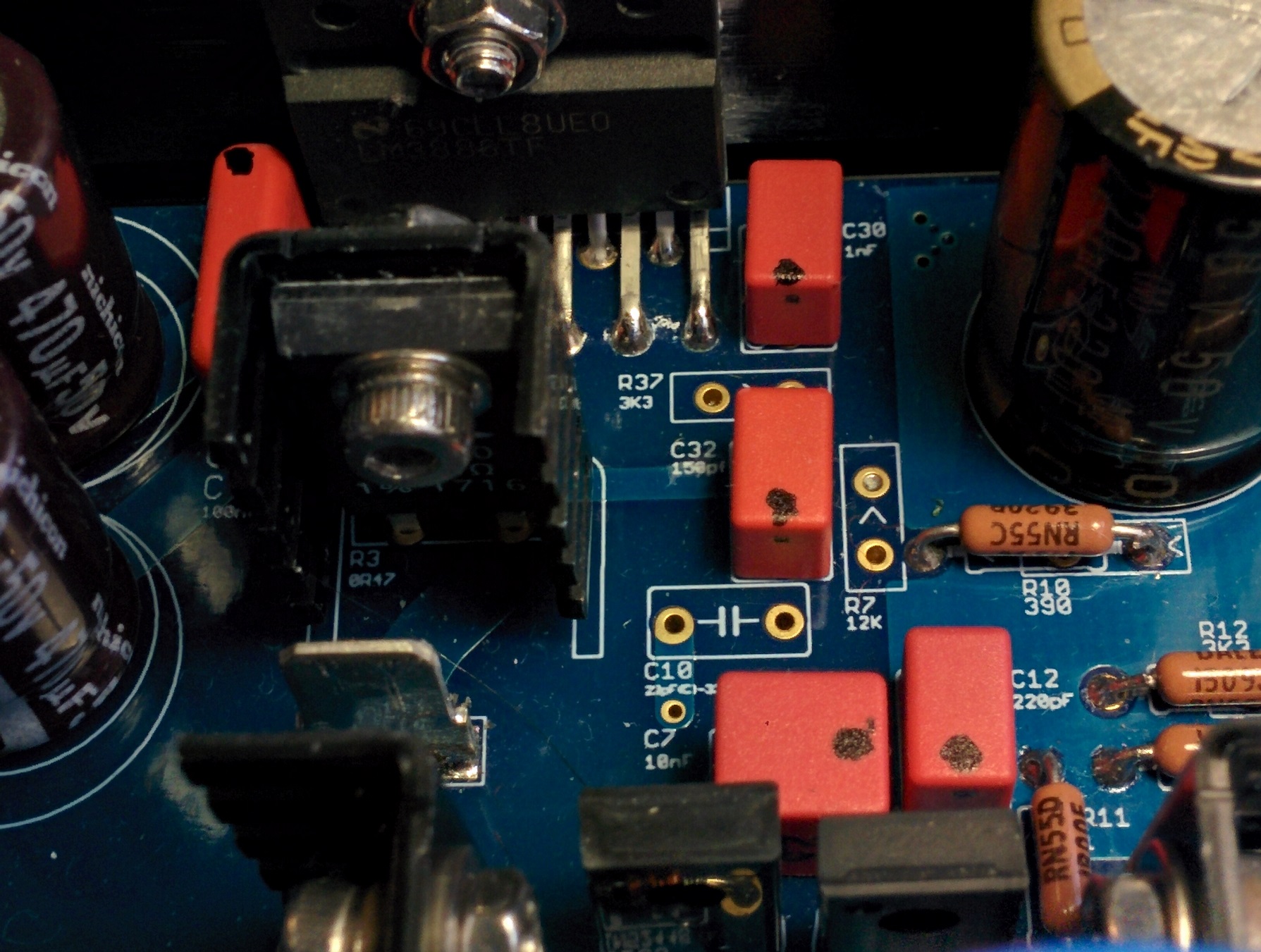

I'm afraid I was wrong about the orientation of film caps.
In his tutorial Dario explains that Wimas orientation can be identified by a small sign.
In the attached picture I've made a black little dot in correspondance with these signs.
Can you help me to understand if I have respected the right orientation?
In case I want to try the Amtrans, can you post a picture of their correct orientation?
The images and captions published in the excellent tutorial of Dario are not entirely clear to me (yes, my age! ...)
Thank you for help

Dario will sauté me in olive oil and top with fresh basil for saying this, but the polarity or orientation of film caps is live the polarity of wire or resistors.
If you believe it makes a difference it does. If you do not believe in this it is not audible. I do not know, but orient all mine the same way with respect to signal flow. But never have changed them all to see if it is right or wrong.
There is a little science here. Some feel the outer layer needs to be connected to the source. Others say the outer goes to the load. This is spiral wrapped caps.
I use a lot of stacked film caps and orient the printing to read with signal flow. But they look identical in construction.

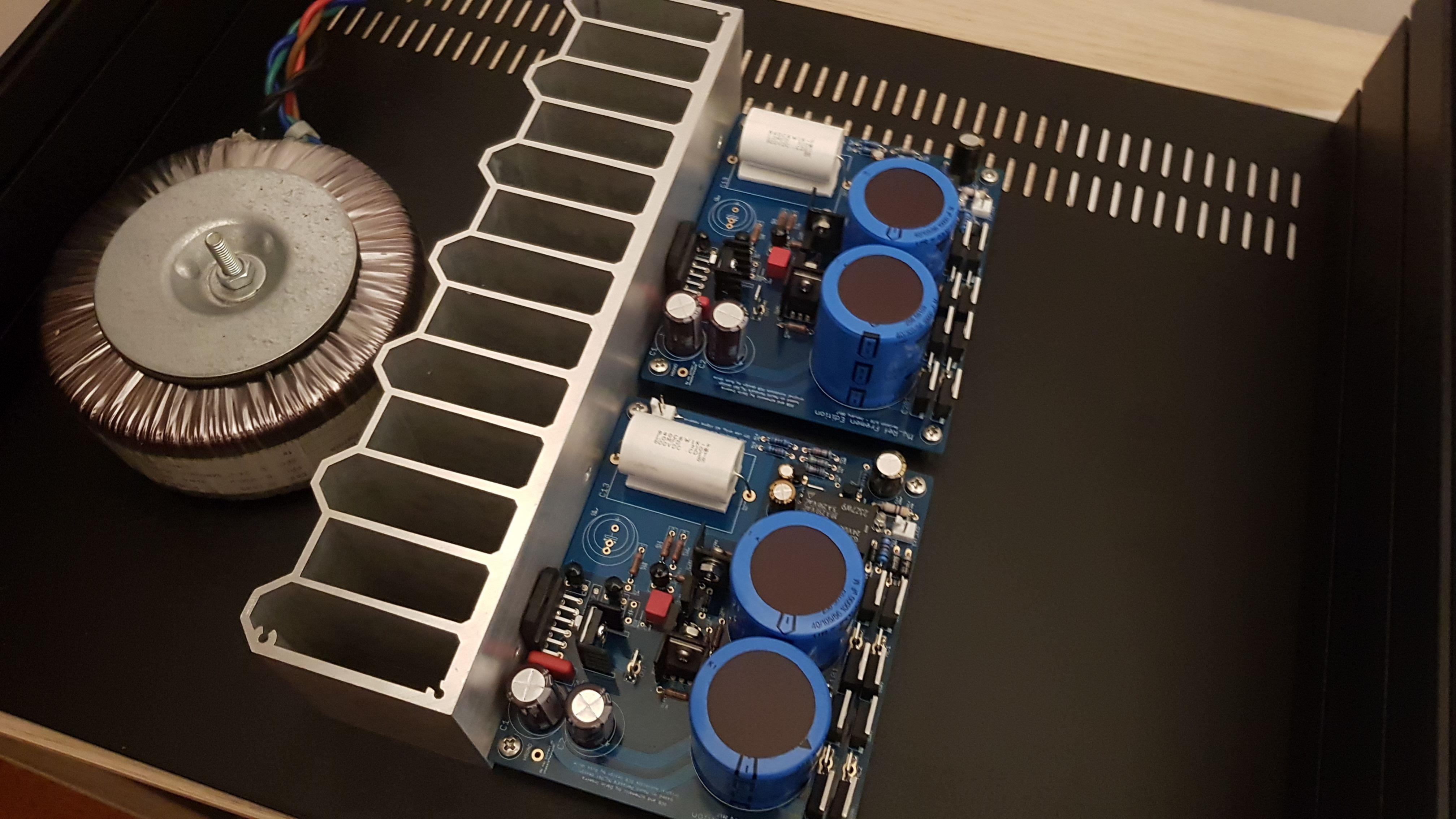

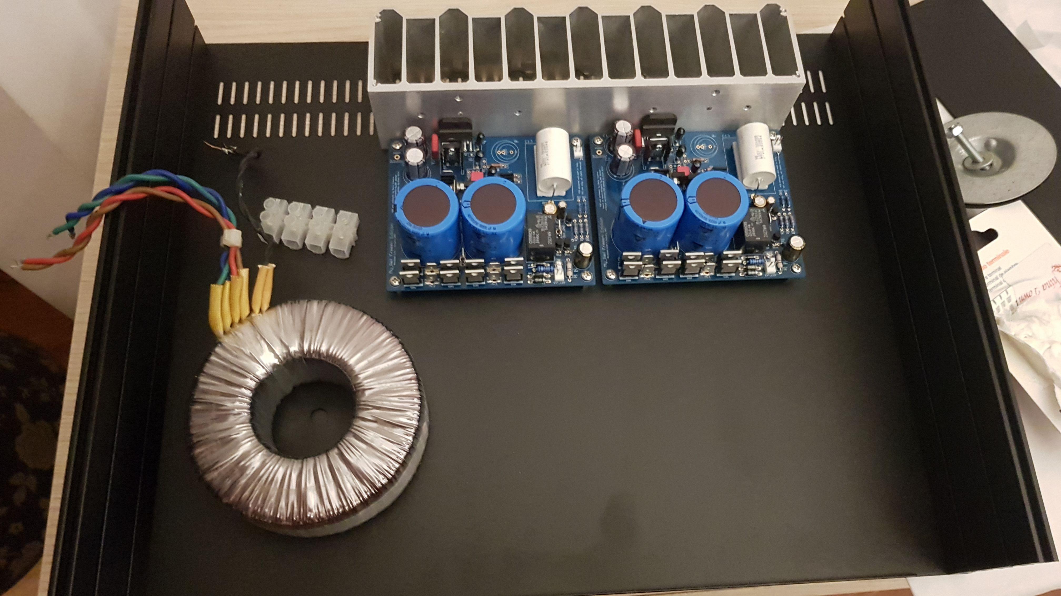

Hi everyone. I am waiting for the arrival of the two cerafine capacitors to be able to start testing the amplifier. I have two doubts one on the power supply, I have a dual 24v 250VA transformer according to you I can use it? and then better the layout with the transformer behind the sink in order to use it as an interference screen or the second layout? Thank you all for the answers.
