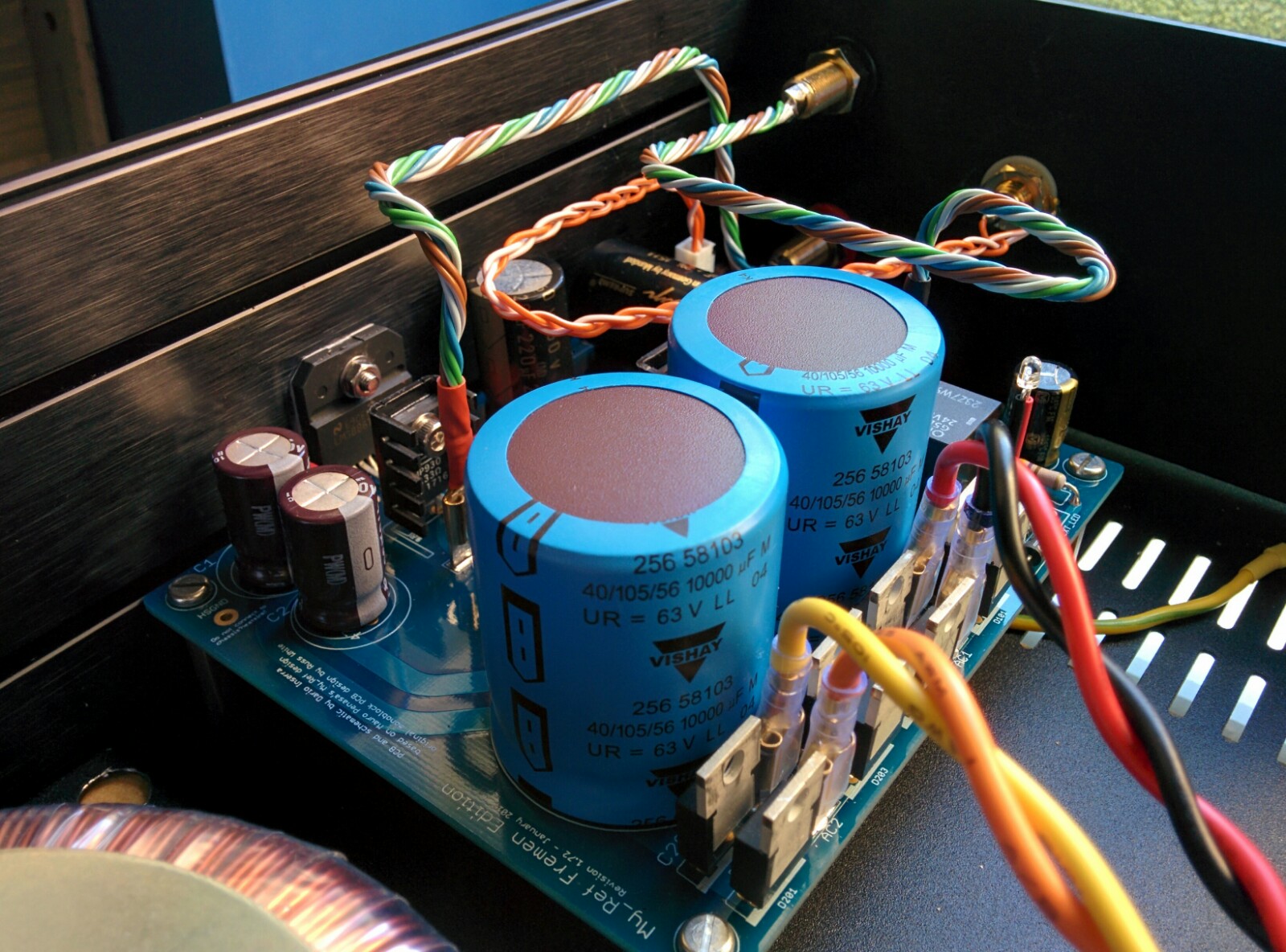

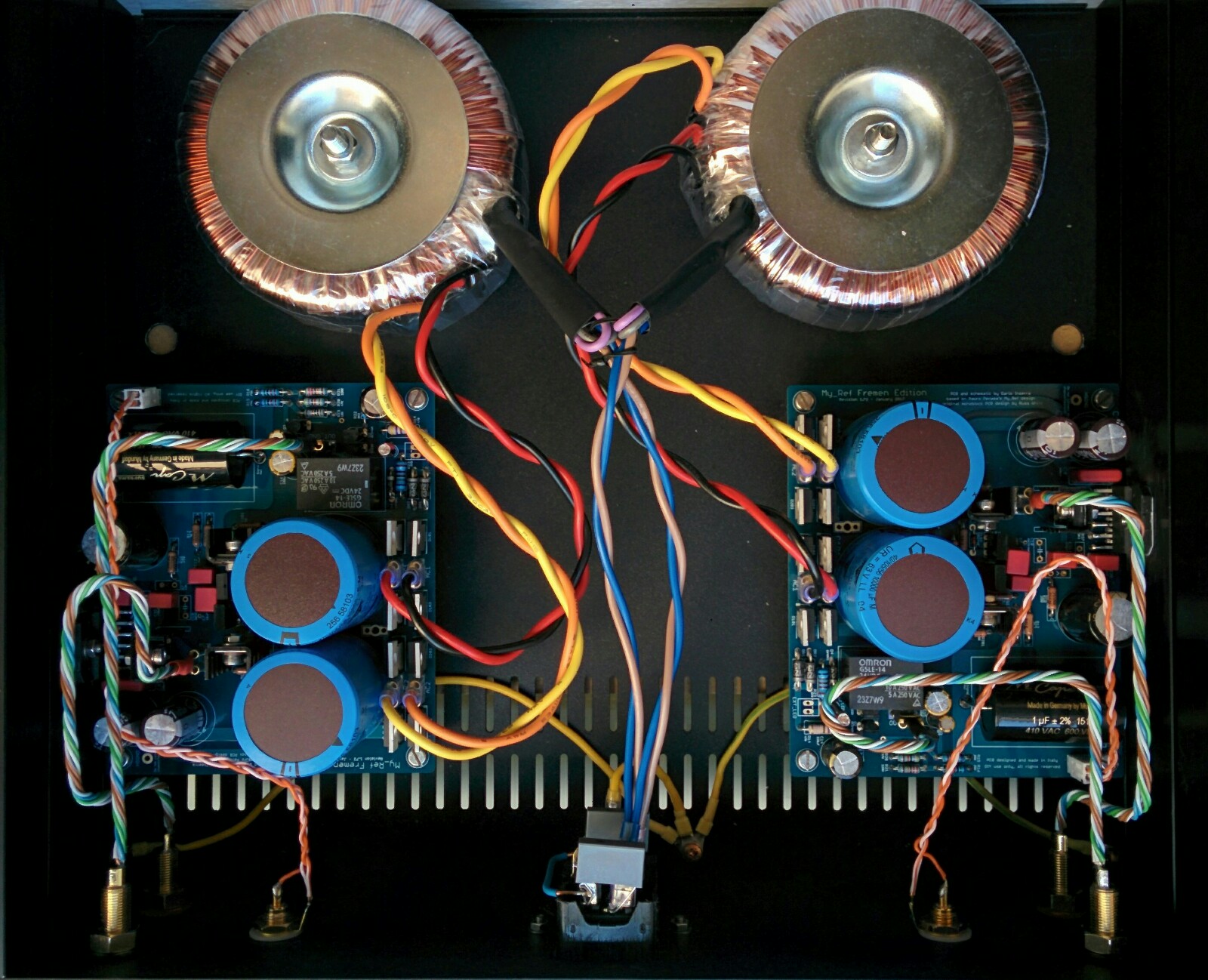

Also I planned on using two power transformer that only have single outputs, four output wires. Is the dual windings neeeded to reduce switching noise on outputs?
Figured if using single output I only need four rectifiers per board and not eight. I can hunt up some Antek iron if needed to reduce power supply hash.
The original stereo My_Ref boards had the polarity going to each channel inverted. Mauro said it lowered the current spikes from the power transformer.
I figured how to optimize the power transformer connection to the boards. But one question about Mouser.

Sincerely, I don't know, I've missed that point on Mauro's boards.Also I planned on using two power transformer that only have single outputs, four output wires. Is the dual windings neeeded to reduce switching noise on outputs?
Nevetheless Mauro's boards always used a single diode bridge per channel (per LM3386 on My_Evo) so it's different.
Apart higher cost I suppose 4 trasformers will work as well.

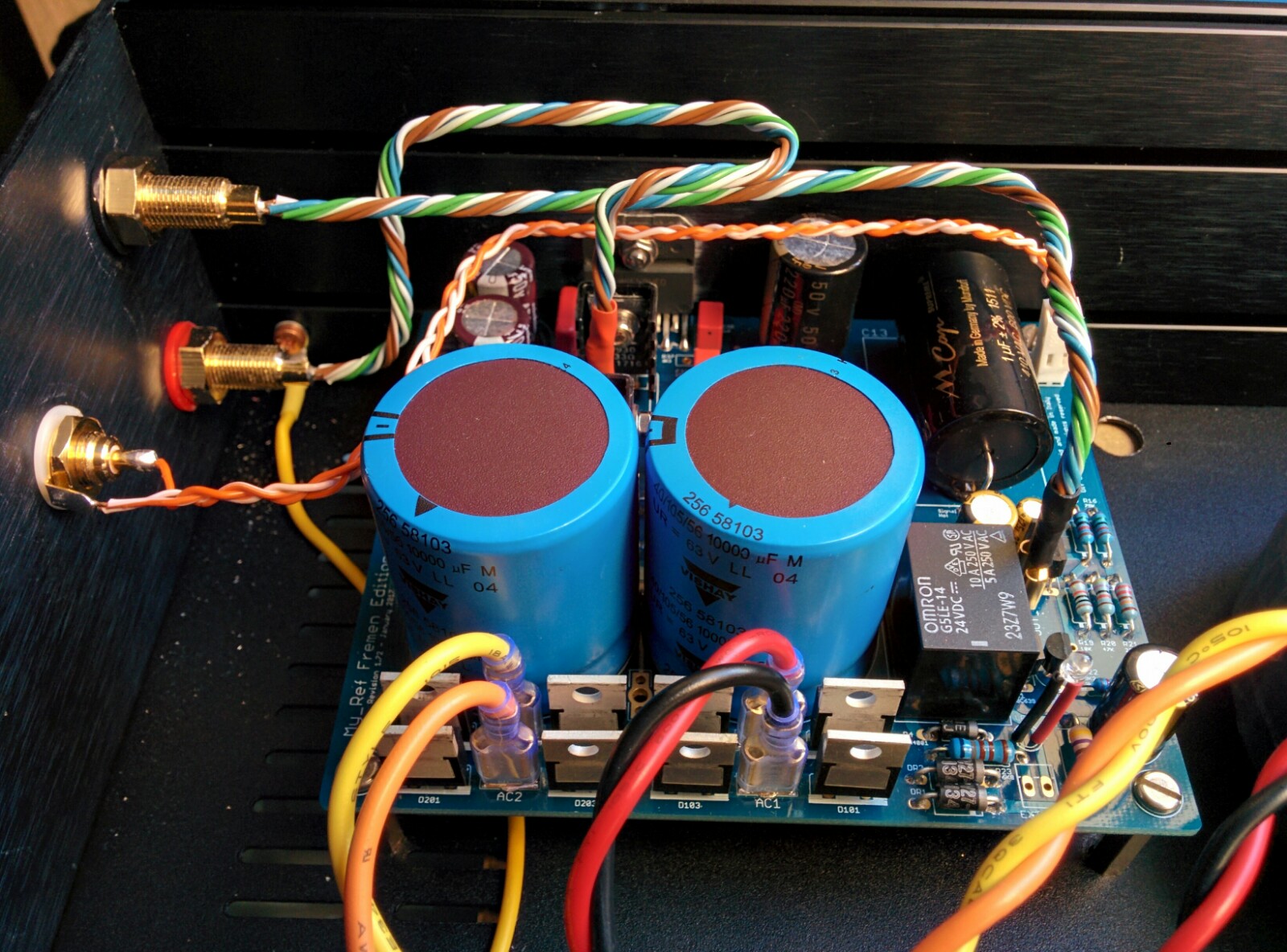

Hi!
A week ago I finished the construction of the My_Evo Rev. A.
After over 40 hours of listening with a passive TVC preamplifier, I am very impressed with the sound quality. Sound control is remarkable.
For less than 450,00 Euros, I think it's almost a miracle.
I would like to remember and thank Mauro Penasa's brilliant intuition on how to use in an original way a LM3886 and the great work of implementation and fine tuning done by Dario Inserra. What have they done!? My god, they did!
For budget reasons I used the Mouser industrial BOM with the exceptions of C9 (Cerafine on Ebay less than 6,00 Euros) and C13 (a friend of mine gave a couple of Mundorf Supreme to me). Transformers are Triad Magnetics, the cheapest ones found by Mouser. Nothing less than other more expensive and famous, they work perfectly.
Always for budget reason I choose as enclosure a Galaxy 31x28x8cm (less than 40,00 Euros). According to Dario, this is the minimum solution to contain the amplifier. The only recommendations are to use 20mm spacers to bring the LM3886 to a height that does not encounter grooves on the heatsinks and use high quality thermal compound (I used Arctic MX-4) to achieve the best thermal coupling.
The last week in Rome, where I live, we have had very high temperatures, over 35 degrees Celsius. Under these conditions, the heatsinks were warm, but not very hot.
Now the temperature is near or below 30 degrees Celsius and heatsinks are tepid-warm. My speakers are three-way closed box, 91 dB, minimum impedance 4 ohm. Not a very difficult load.
After first power up DC offset were about -4,0mV and -6,5mV. After 30 hours of listening were about -4,5 and -8,0 mV (this is the only value I don't like too much). I hope DC offset will stabilize (possibly within + or - 10mV)...
The amplifier has never made noises, electric discharges, it is totally silent and has not presented any anomalous overheating.
My little problem is the fuse: I've bought Schurter ceramic ones, slow blow (from datasheet: time-lag T, high breaking capacity - ceramic tube, 1,25A 250V).
In a week, three times, turning on the amplifier, I found the fuses broken. What do you think is the cause? Can I use a 1.6 or 2 amp fuse in the hope that it will last? Or is it dangerous?
The only thing I added to the project are two X2 capacitors (0,01uF 275VAC) mounted on the bipolar switch to avoid burning the contacts. Are they the possible cause? Or I was wrong to choose the type of fuse?
