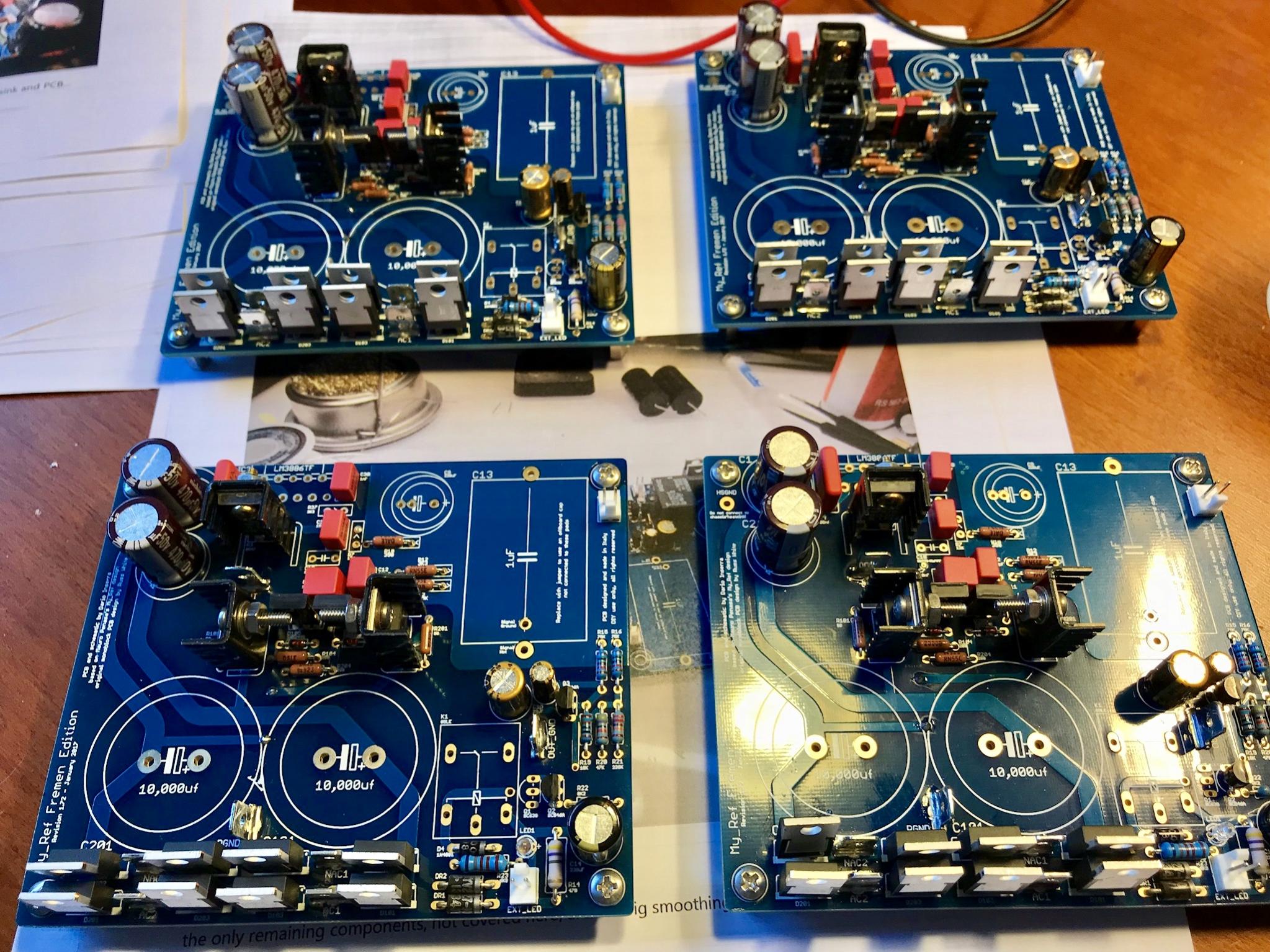

I´m currently assembling 4 amp boards and have come to the Wima FKP2 caps, but I´m a bit confused about the correct way they should be mounted.
Should I look for the small dimple in the plastic, and orient that dimple to the left of the marking on the board ?
Thx Dario
I made some progress today and now I just have to wait for the last parts to arrive from Mouser.
The BOM and clear instructions really make this build as easy as a kit build.
Now I need to decide what to use for cabinets for these amps.

Hi Kim
You have 4 ampboards, are you planning to make a balanced version ?
I am asking as I have 4 boards unassembled with that (balanced and more power) strategy in mind.
