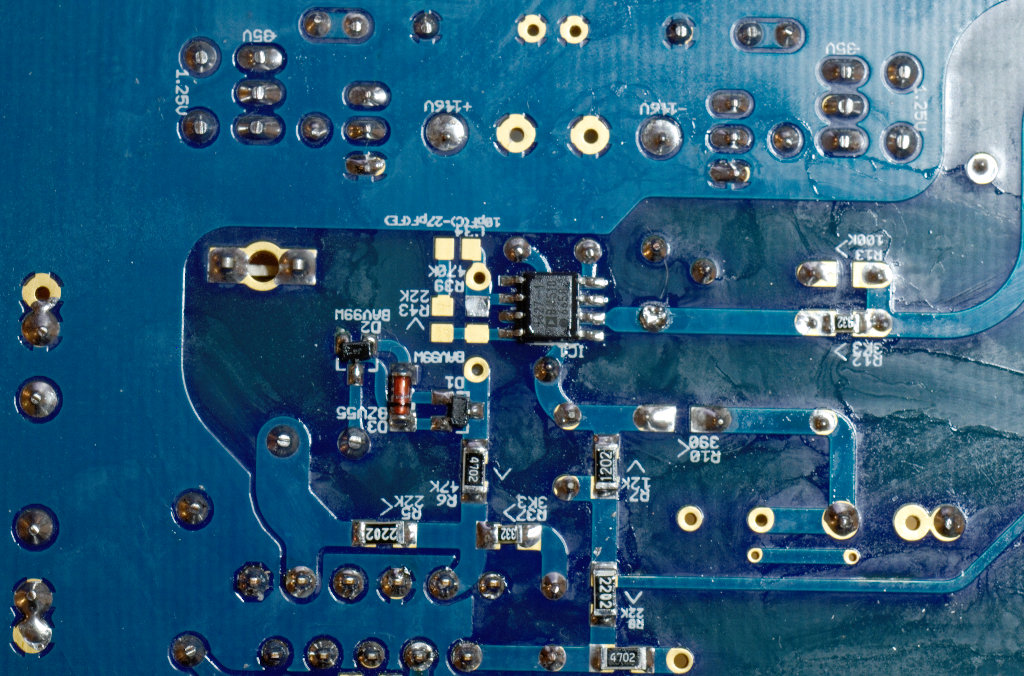

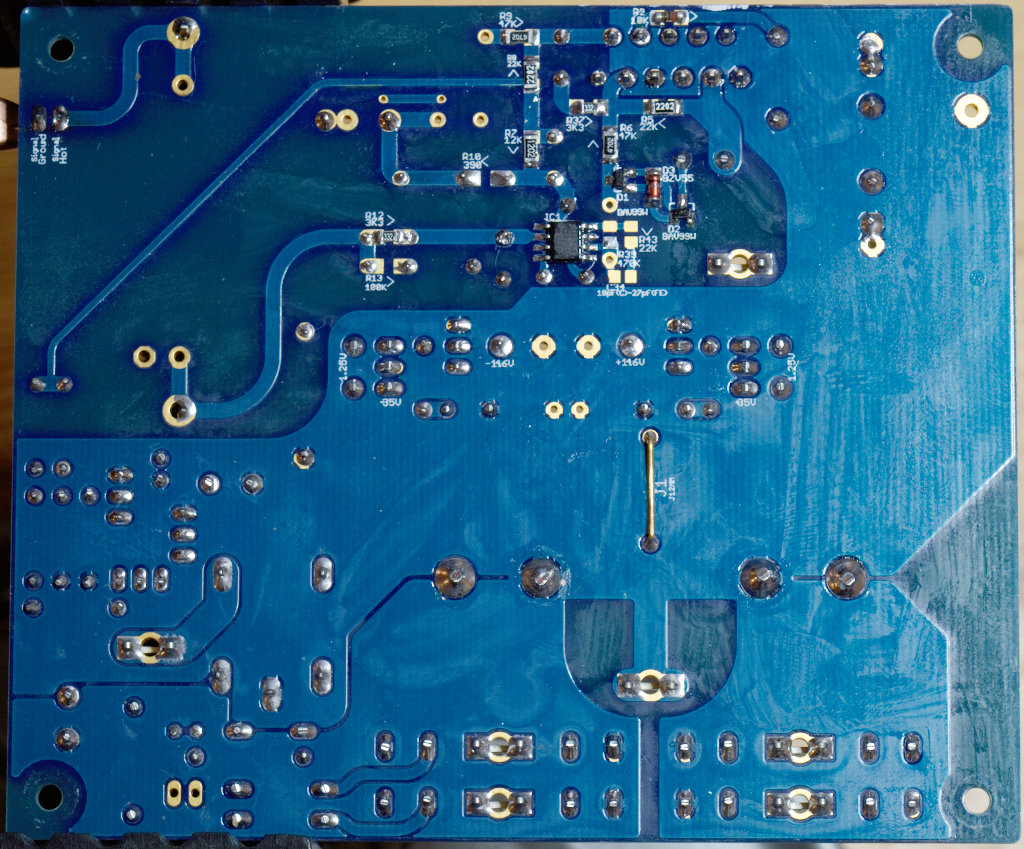

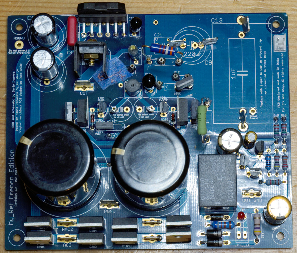

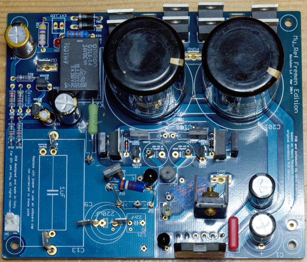

This is the board with the DC offset issue. V1.2 boards. As mentioned, I am using sockets for several resistors to be able to compare BOMs. Right now the components are from the old BOM circa 2012. I also have faston tabs for C9 and C13 so that I can use the same components on both sets of boards. I removed the caps for the photo because they block the view of the other components.
Photos below.
Photos below.

Jac, I see a very nice build..
And don't see errors.
Just some note: A load would be nice to be in place, while experimenting.
Do You have anything from 4 to 10- 15 ohm, 5 -10 - 20 W resistor..?
5W for seconds only..
May I ask had you checked the zone of LM3886 compensation, 3,3k-1nF, R37 C3x, for good contact? The same way, good continuity at the input zone, 100k; 3,3k (R12);
Finally, a smaller feedback cap would not hurt, (pin2 - pin 6, from -IN to OUT) though probably OK. (like 4,7pF)

Some of the soldering topside does not look good. You want to have the solder flow on the pads and pins on both sides of the board.
R11, C9, R10, R7, R3 and the connections to the IC1-3 IC2-3 are a good place to begin.
Thanks guys. Problem solved. Now a nice steady 2 mVDC offset.
I checked continuity in all the places George suggested. I touched up the soldering on several places, especially the LM3886 as Mark had suggested. I also found that I had bent the legs the little Caddock in R13 (100k) and I guess that it had developed a weak point at the bend. When I went to remove it, one of the legs came off. I'm not sure what fixed it, but if I had to guess it was either the Caddock or the soldering on the LM3886.
