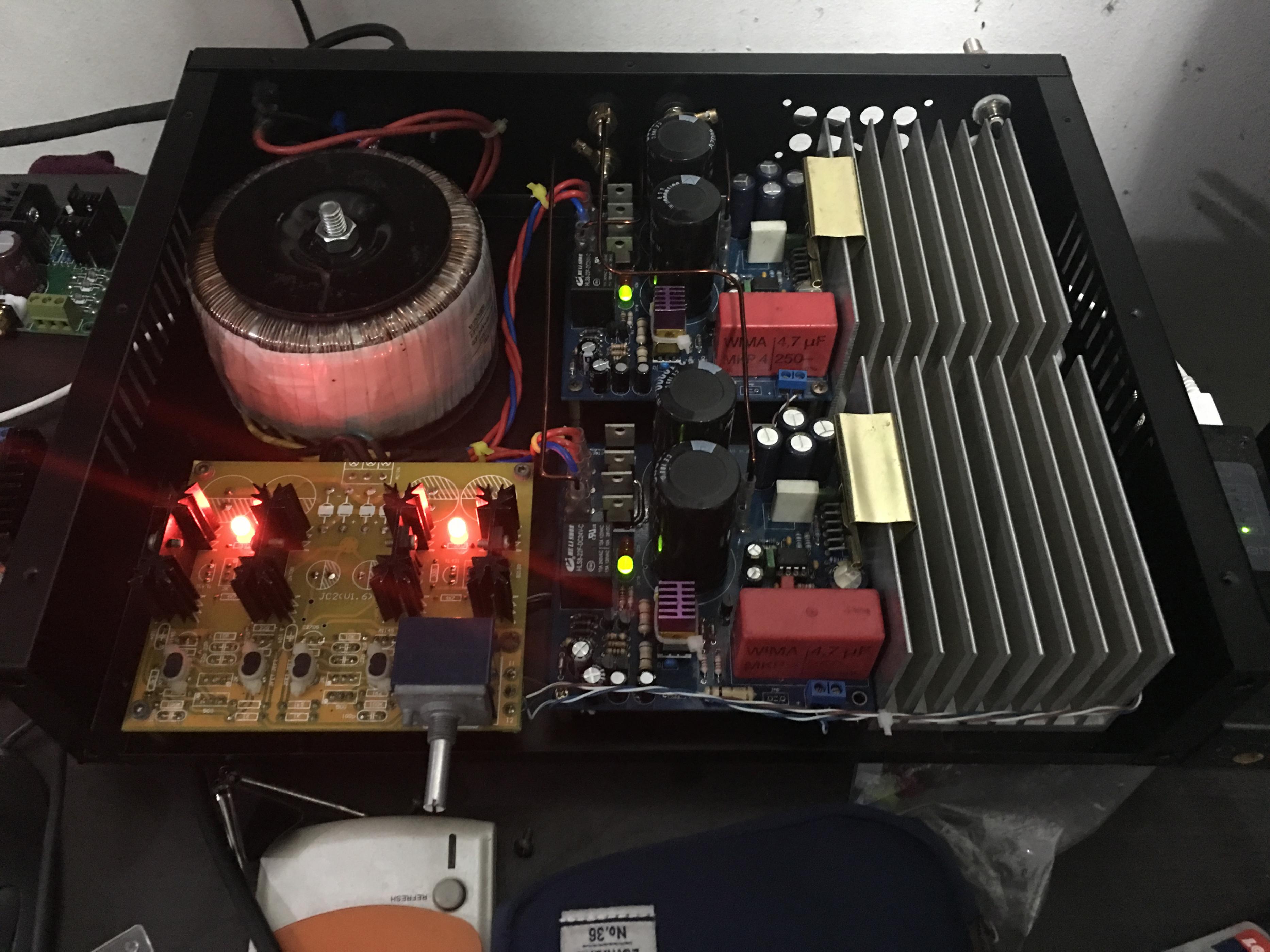

Getting closer on the first two boards. Soldered up the relays and all the rectifiers last night. I only get an hour or so to work each night after the kid goes to bed, so it's slow going. But I'm making progress. 🙂 On to all the electrolytics next, then some chassis work, then transformers!

Wired up one of my toroids for a quick test on one board last night. Relay clicked on the first power-up! I guess my soldering skills aren't so bad after all. Also, I was reading .01mV offset on the output. I'm VERY happy with that. Other voltage readings were pretty much on spec except for R101, which is only reading 1.1V. R201 is reading 1.2V. Is this an issue? Also, ground to the LM317 is reading a few volts below 35V, but I would assume this is attributable to the fact that I am using an Antek AS-2222 with 22V secondaries. Let me know if anyone has any thoughts on my voltage measurements. I haven't hooked the amp up to a source or speaker yet.

Congratulations! No smoke and a relay click.
Regarding the voltage across R101, I would check the voltage across C102 and C202. They should be within 1 volt of the +14V/-14V respectively. Also flip over to ACV at the same time and make sure there is very low AC. The difference you are seeing is probably nothing, just component variation in the regulator circuit.
When you are talking about ground to LM317, I assume you mean the voltage across C101 and C202. If that's the case, then yes, with the 22 VAC secondaries and no load, you will probably be around 30V. It will likely drop a bit when you start running current through the amp.
If I were in your shoes, I would wire up an expendable speaker, feed the thing with some sort of volume control of pre-amp, and see if music comes out.

Thanks for the tip Jac. I tested both boards with a makeshift speaker (Dayton PS95-8) and my phone as the source. They sound fantastic!!! Can't wait to get them playing through some real speakers. Thank you Dario and everyone that contributed to the My_Ref, especially the late Mauro Penasa.
A few updates. I'm working on mounting all of the components for the cleanest look possible. Here's why I soldered the Faston terminals to the bottom of the board. I wanted the look of a tube amp's exposed components without all the wire clutter. I'm really happy with the way its coming together so far. All the wires will be concealed below the 1/8" thick aluminum plate. I'll build a wooden frame for the aluminum plate to sit on and recess the input rca's, mains plug, and speaker output terminals into the wood frame.
