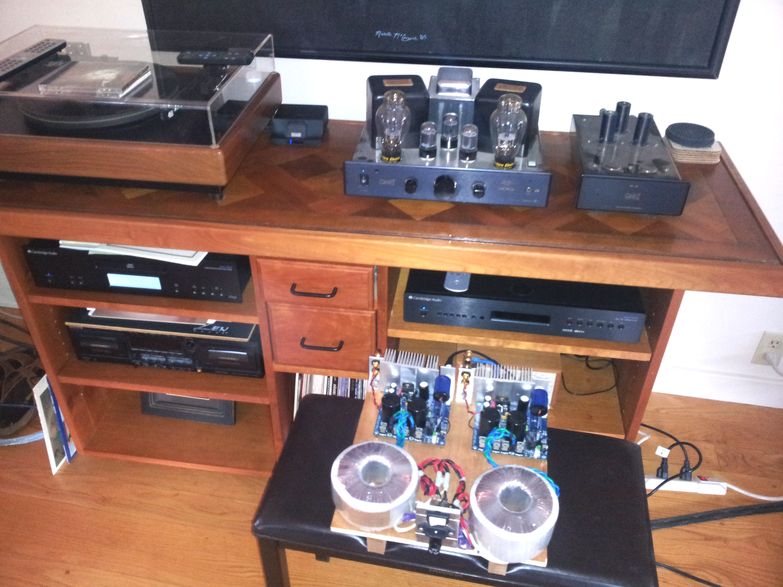

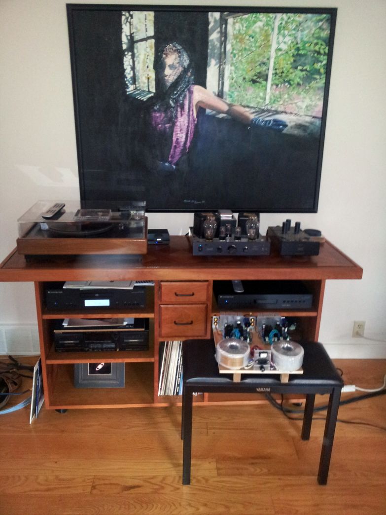

Said I’d do it and did – finally.
After months of teasing forum members, I did catch up with my friend John (all the way back to High School) to compare an LM3886 amp to a high quality tube design. The problem seems to have been him and his wife saved their money so they could travel in retirement, while I spent all mine on silly DIY projects and can’t afford to leave the house. Anyway, a little salt on the bird’s tail did the trick.

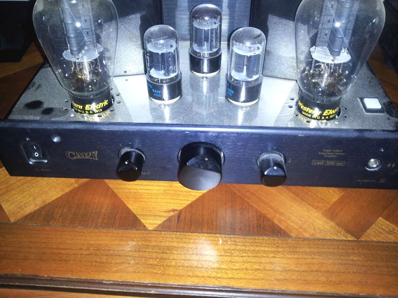

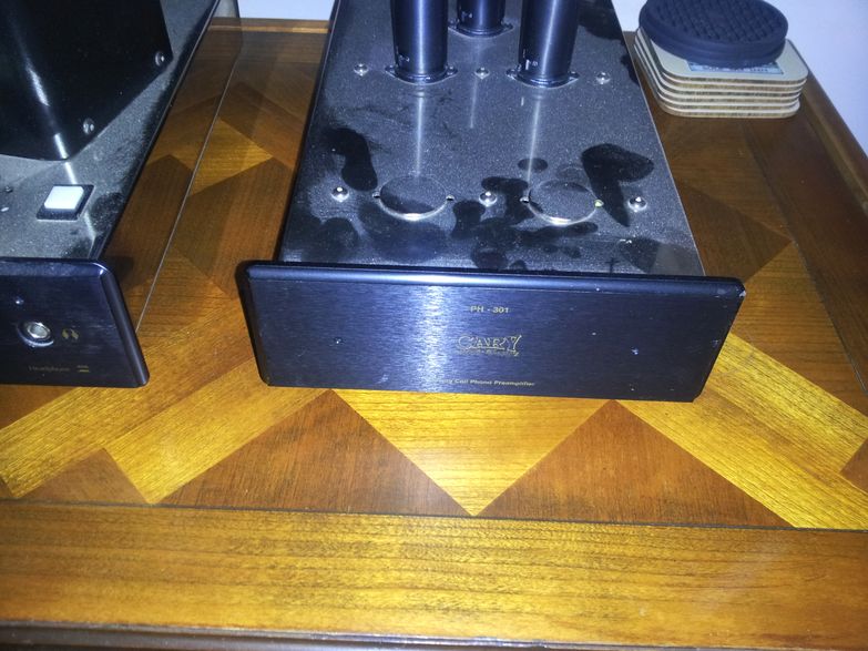

The tube amp is a Cary Audio Design CAD-300SEI integrated amplifier. His system includes some other very nice equipment including a Cary PH-301 moving coil phono preamplifier, top end turntable and cartridge and a Cambridge CD player with the ability to feed a separate DAC or other digital boxes.
Again, the source was flac files fed from a Samsung Galaxy S II. It was connected directly to the tube amp and the FEs via standard RCA interconnects. I tried to collect a wide variety of music – some being native uncompressed, and others reformatted to the flac format. We didn’t try any standard CDs.

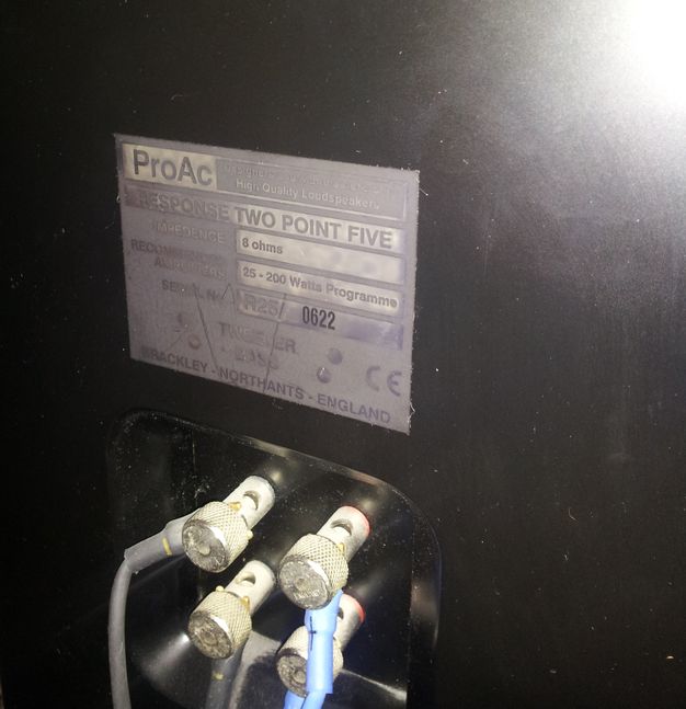

The music flowed from a pair of ProAc Response 2.5 loudspeaker bass reflex speakers through some $600 + cables in a bi-wire configuration. To keep things simple we didn’t do any double blind stuff. Just played the selections on the Cary first and then the FEs.
In general, the Cary is probably the cleanest and most accurate amp I have had the pleasure of hearing over an extended period. As I expressed to John, my intention was not to do a critique of the Cary – more correctly a chance to detail the similarities and differences between the tube and the LM3886 approaches. (Though it would have been fun to thump Mr. Cary)

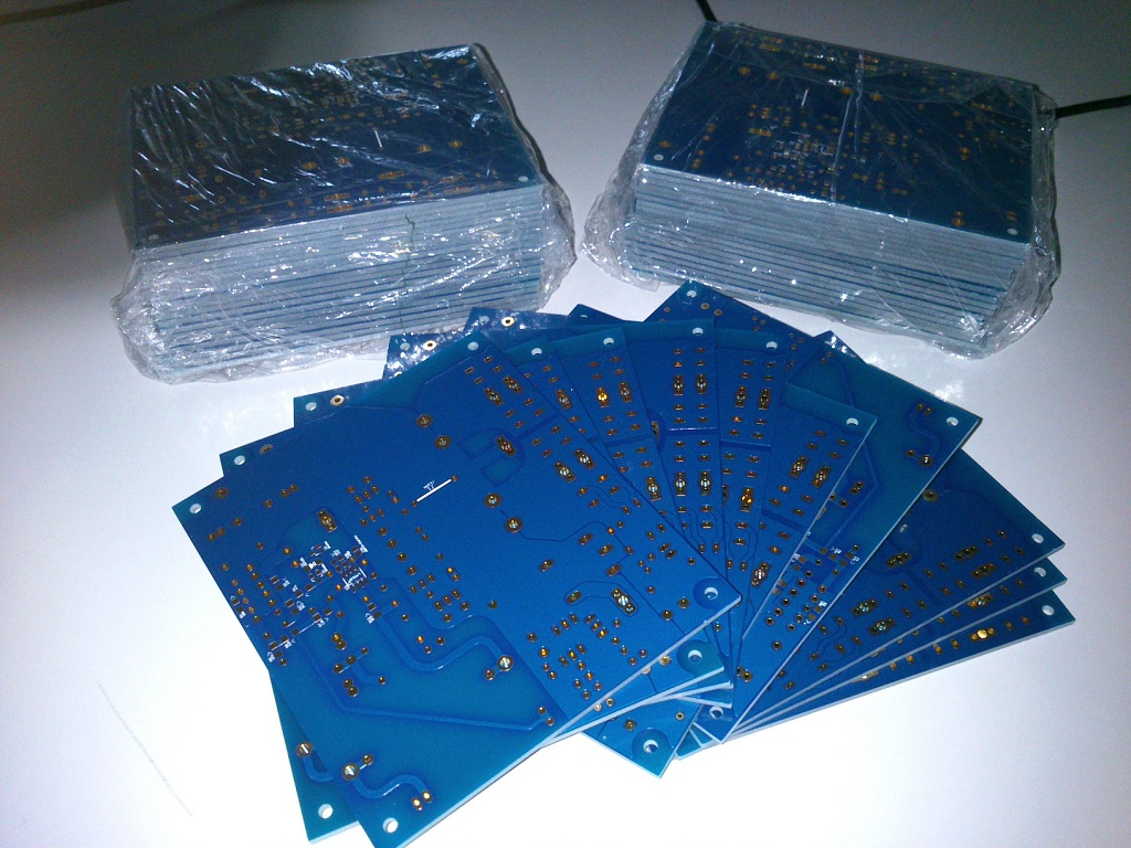

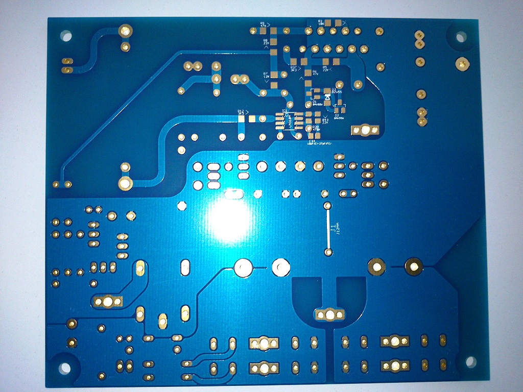

Boards arrived!
I've boards in my hands:
attachment.php
Same great quality of green ones.
I'll try to start shipping tomorrow, by saturday all boards should be shipped.
Now that blue boards are here I can communicate how I intend to manage the 'excess' green ones.
I'll sell them at 20€/couple and after enough are sold all RC partecipants will receive a 10€/couple refund so that they pay their blue boards 20€/couple too.
Partecipants that want to buy green boards have precedence over all others and can have their refund immediately paying them 10€/couple (price valid for the number of blue boards buyed with the GB).
So, please, every partecipant should post his preference (refund or extra boards at special price).
I'll start shipping from partecipants that express their intention.
Whoever else wants green boards please express interest.

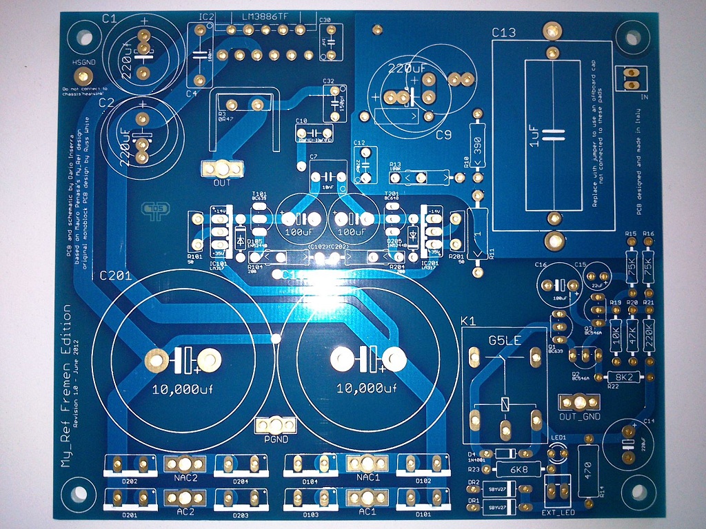

I've been planning to build myRev since almost the beginning of the year :D by reading aboundance of topics and looking for a small enclosure to match my DAC/ Preamp. At last I have found a decent toroid and good to my mind enclosure. Just few questions to be clarified:
- is it possible to use one toroid for both channels?! this has already been asked here, has anybody done it that way? Were there any problems with virtual ground/ hum?
Alternatively I could use 2x 80-100VA toroids and put one on another, though that makes me looking for a higher case...And I'm not sure if that is a good solution in accodance to hum?!
one...Thus probably will stay with two boards.
Let me attempt a more detailed answer.
First, although successful MyRefs have been made using 160 VA transformers, both MyRefs and FEs seem to benefit sonically from larger transformers. Of course, it all depends on what your speakers need to drive them.
Both MyRef and FE use a bridge between the voltage stage output and the feedback loop. In the MyRef, the bridge is a capacitor which is more robust against hum. One of the sonic improvements of the FE is the use of a double diode bridge. Mauro, the original designer of the MyRef concept, strongly suggested that this increased the hum risk, so the FE was designed with one transformer per amplifier channel.
To my knowledge, no one has experimented with driving two FE boards with one transformer. My long term plan is to build some 3 way speakers with an FE amp driving each speaker. Naturally, I would be happier if I could drive 3 channels with on transformer. With that in mind, I will be doing some experiments, once I get my FE built.
In the end, I will use one for one, FE to transformer if needed, but I'm hoping that careful experimentation and grounding design may let me get away with a single transformer.
I hope this helps.

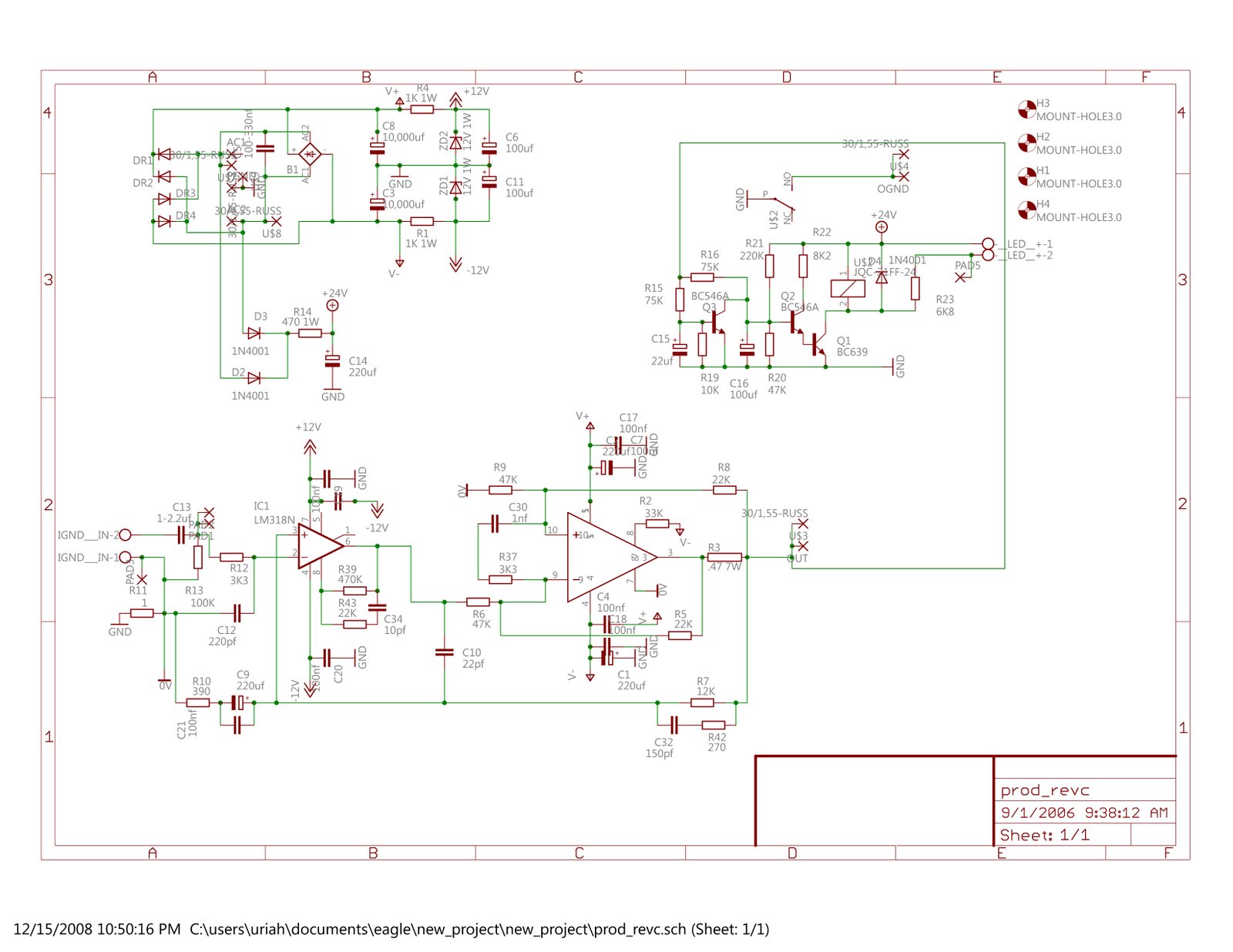

Regarding the bridge cap in MyRef, could you please point me on the scheme which one is that?

i got it, the bigger toroid is the better dynamics would be. thanks!
I may need some back up from the experts, but here is the way I look at it. Both MyRefC and FE have C10 which acts as a bridge. FE also has D1, D2, and D3 which together form a double diode bridge.
Any of you experts want to take a crack at how the bridge changes both the FE sound and may reduce hum resistance?
Jac
