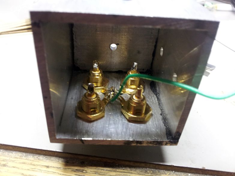

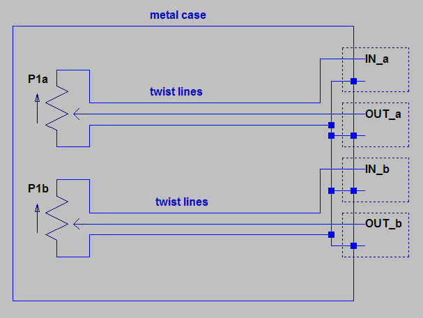

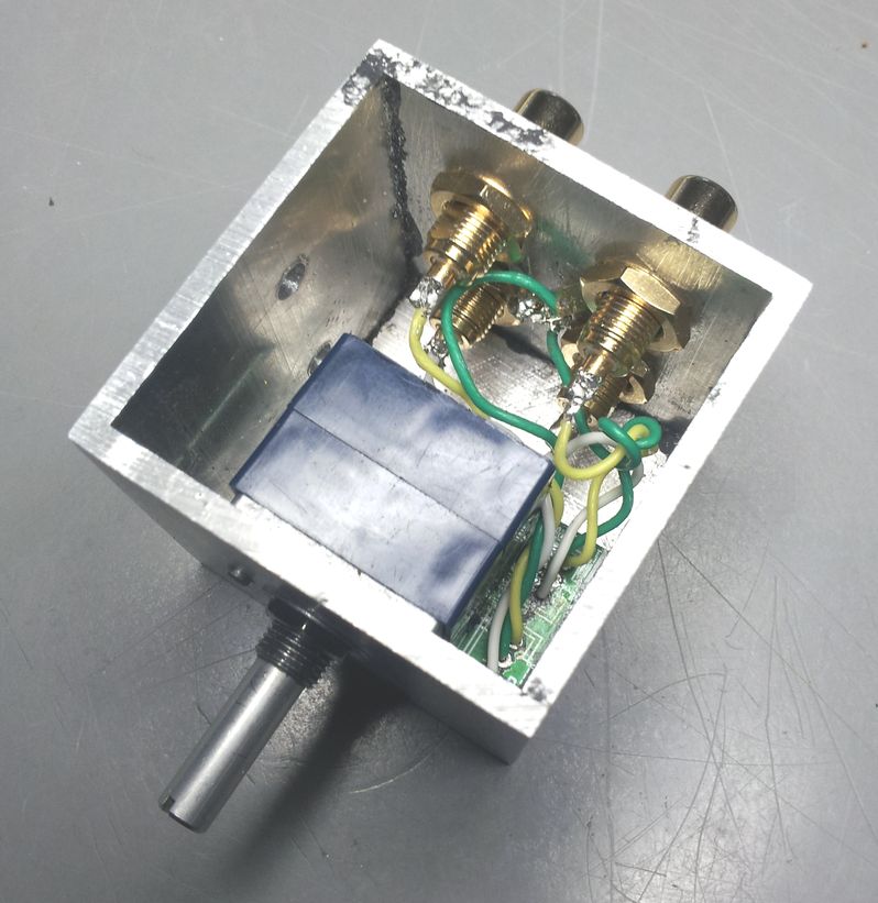

For the same reason the GND shall only be connected at one single point -- solder the four lugs of the RCA's together, the RCA barrels will provide the contact to the box.
It's all about keeping sending and receiving loop areas as small as possible.![]()
Thanks Mr K. That is very clear. I'll be building one soon.

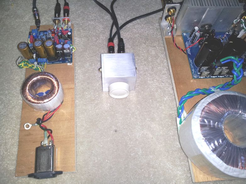

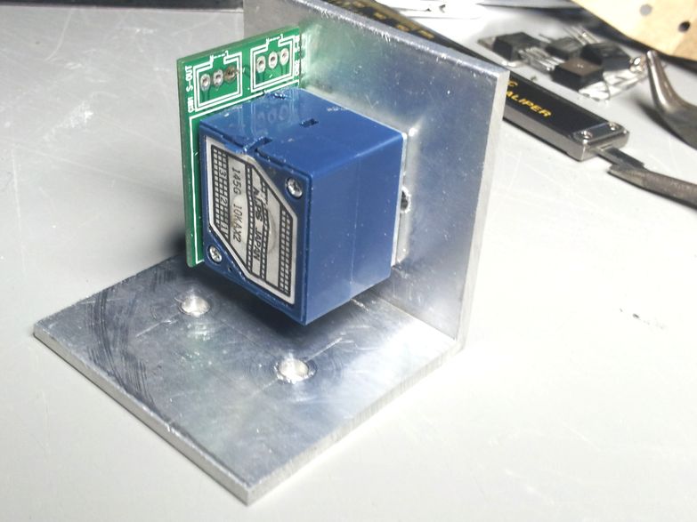

Well, what some people won't do while waiting for RC boards 🙄

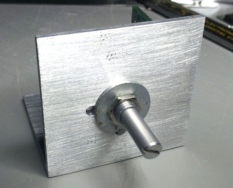

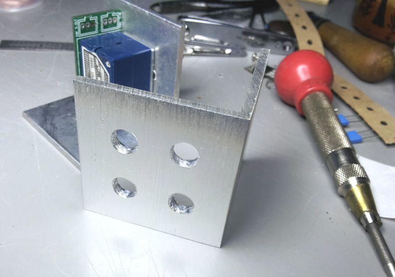

2" x 2" x 1/8" leftover angle from hardware store.
Pre-building.
THE SECRET SAUCE (maybe snake oil) used as both glue and conductive filler. A line painted on paper doesn't indicate continuity but does read 1k resistance
ThinkGeek :: "Wire Glue" Conductive Glue

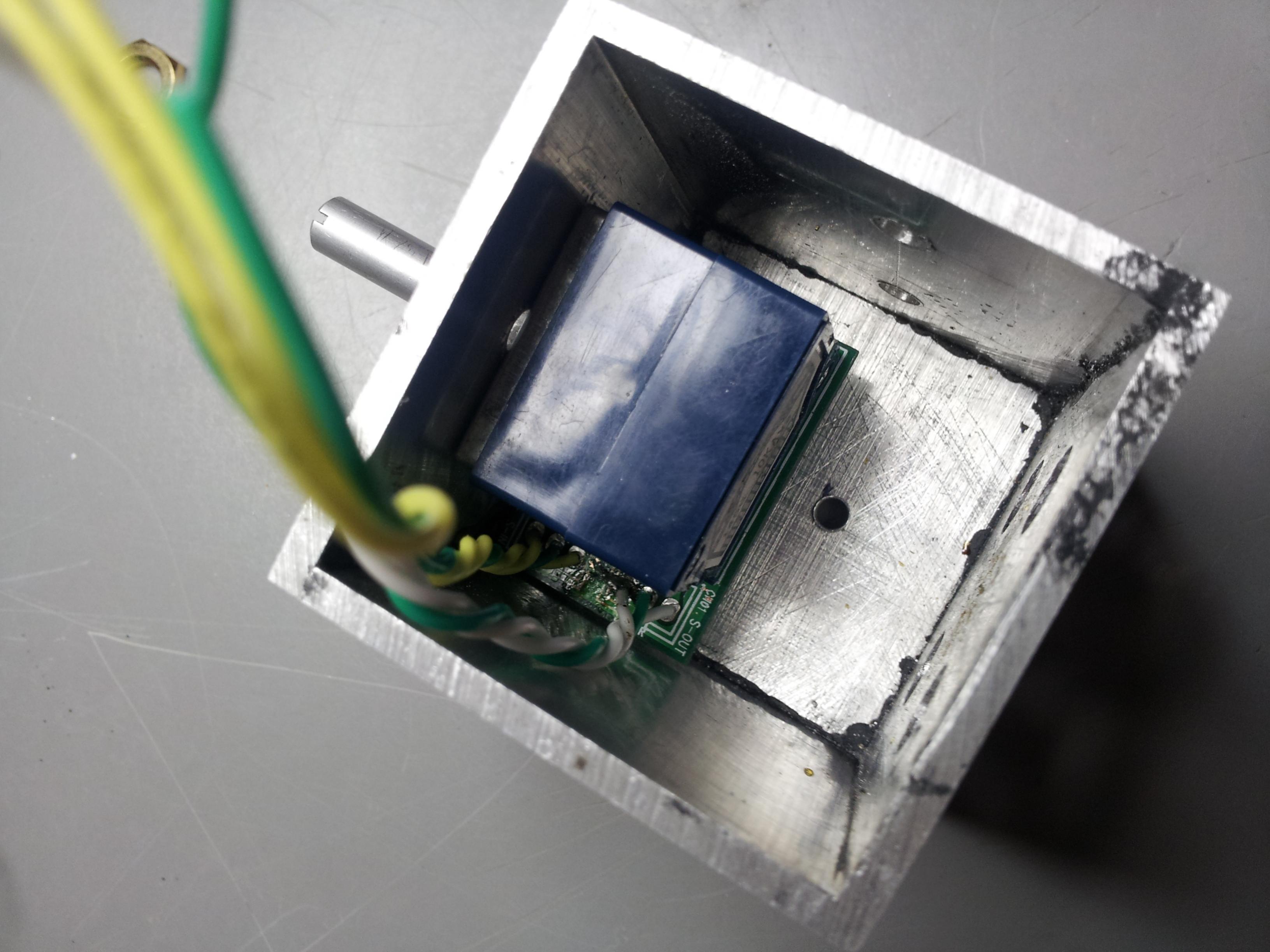

Needle nose pliers and thin tips are a blessing.

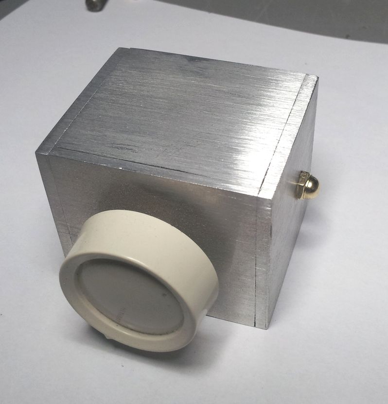

Sides have lip cut on router table with carbide bit.
Closed up with 6-32 rod and fancy nuts.

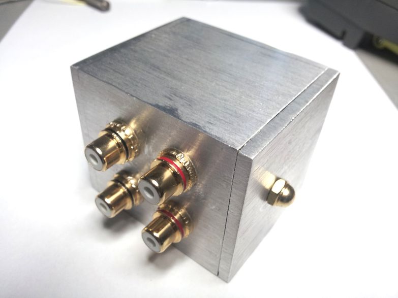

If I did it again I would use RCAs with hex on both sides. Note marks from pliers.
Well, You know what is said about idle minds.
Works as expected - sounds great!
Might make one for the eBay SMD pot.
Thanks, it was fun to figure out how to keep it as small as possible. Been listening for an hour or so and the results are very impressive. Will prove to be a useful tool.
