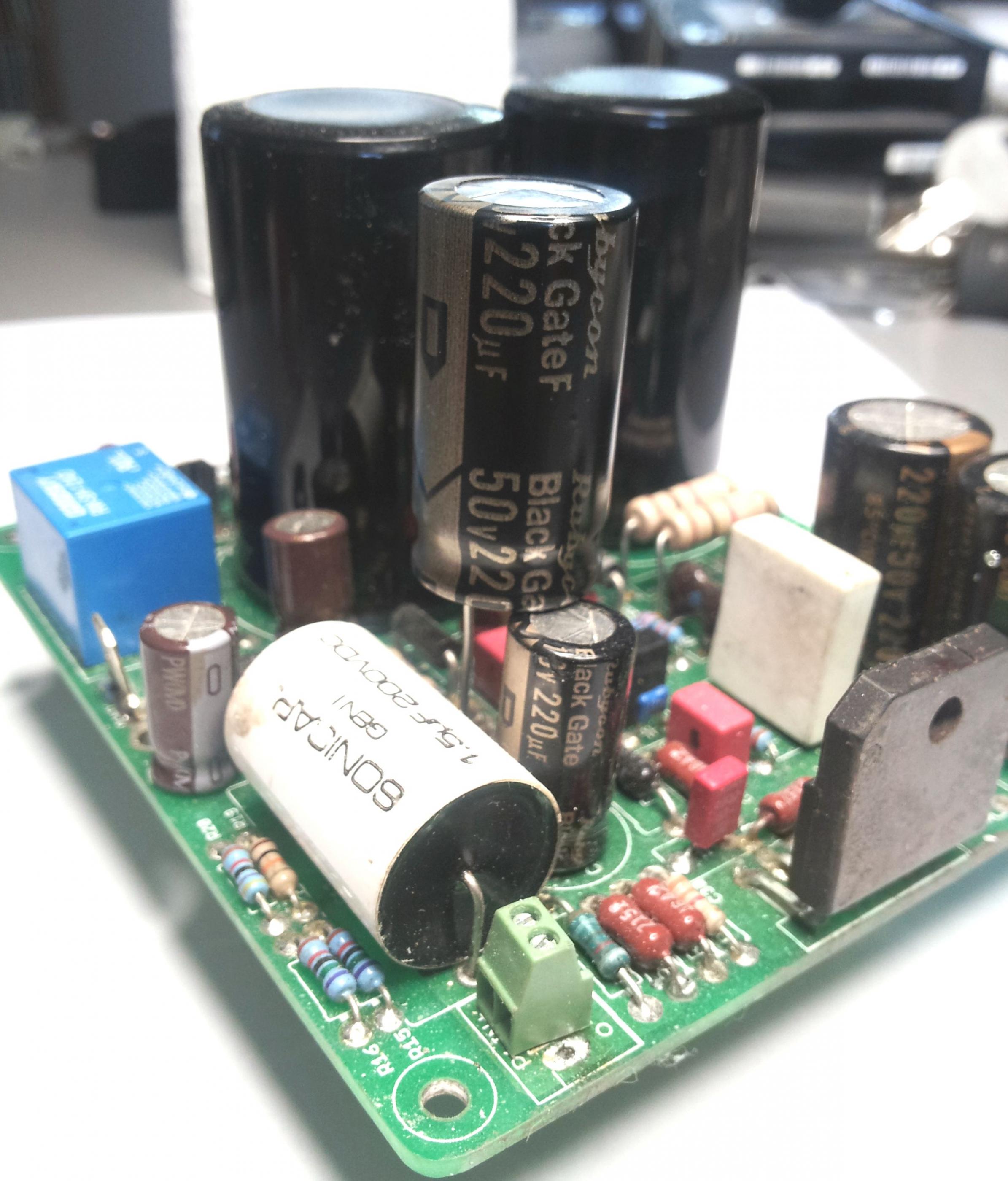

Black Gate F caps are Ginormous. FE boards have proper spacing if standard placement is used.

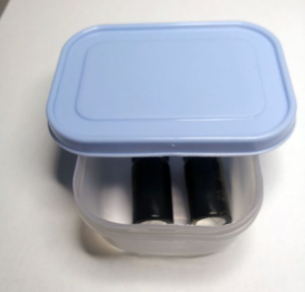

Earned - "Best Shipping Award" - they came inside non-static bags, inside bubble wrap, inside this container, inside bubble wrap, covered with paper, inside plastic bag, in a cardboard box stuffed with shredded newspaper - SERIOUSLY. Half way through I thought I was going to find a fortune cookie saying "April Fools!"😀

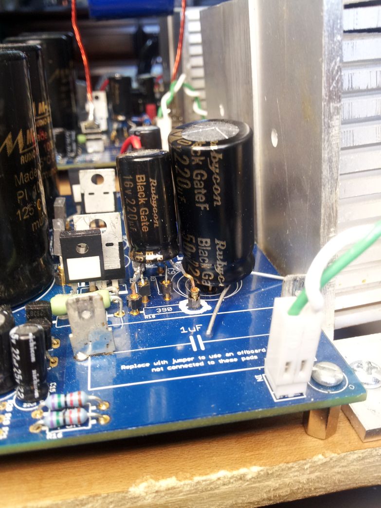

Standard vs F Black Gates for C9.
I couldn't do all the swapping I wanted as several sockets are weakening. Will order more.
To my ears there is a clear difference. Started with the reverse placement and immediately heard a richer, fuller sound. I stopped for the IsoTek process and an hour later, found pretty much the same - some, but not a large difference with burn-in.
Next was original placement and the sound was more defined but still had the same new warmth and fullness. In both positions dynamics sounded a bit more active and pronounced. The floor shaking low tones held their heft but gained more of a physical than audible nature - not a loss but a noticeable difference.
Replacing the standard caps only confirmed my impressions. They are still great sounding caps and I think they still offer the better cleanliness in the internals of placement across the stage. It will take some time but I think the depth of stage is also a tad deeper with the standard.
I'll do much more listening when I get some new sockets - but the total impact of these quick tests bring it back to the same old story. What a builder uses will be a subjective choice.
For me, the F series in the original placement get the nod. Acoustic guitar and small string group fans might indeed make a different selection.
In any event, no builder should feel they missed out by not getting their hands on the Standard BG caps. The F series are just fine and any differences can probably be mitigated by adjusting other caps and resistor in the build.
