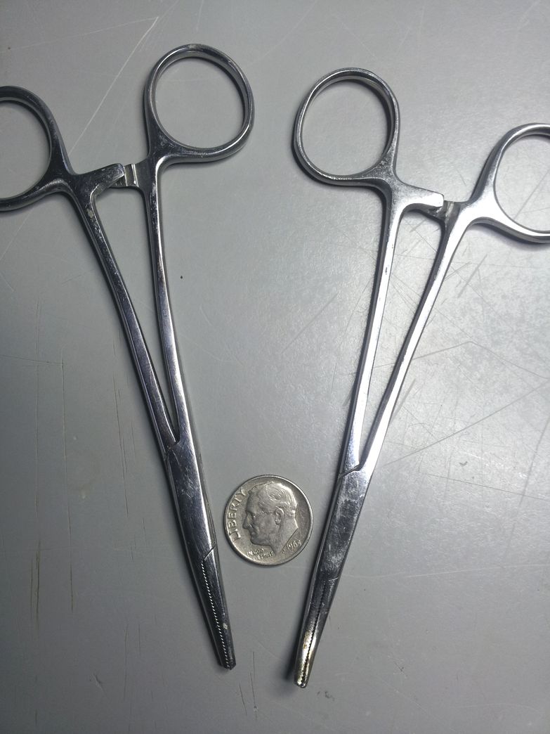

On the subject of soldering and tools, Andrew T recommended the concept of heatsinks on the leads when soldering a heat sensitive device. That sent me to the internet where I learned that some people think an alligator clip works just fine for this task. I also found these which are interesting because they are narrower than an alligator, aluminum (sorry Andrew, aluminium), and reasonably cheap.
heatsink_clip - My Photo Gallery
Soldering Heat Sink (2) | eBay
To each his own, but I just don't think you have to go that far. Remember those SMD parts are installed in some pretty hot applications.
Again, the local CVS eyebrow section gave me a cheap solution for heat sinking.

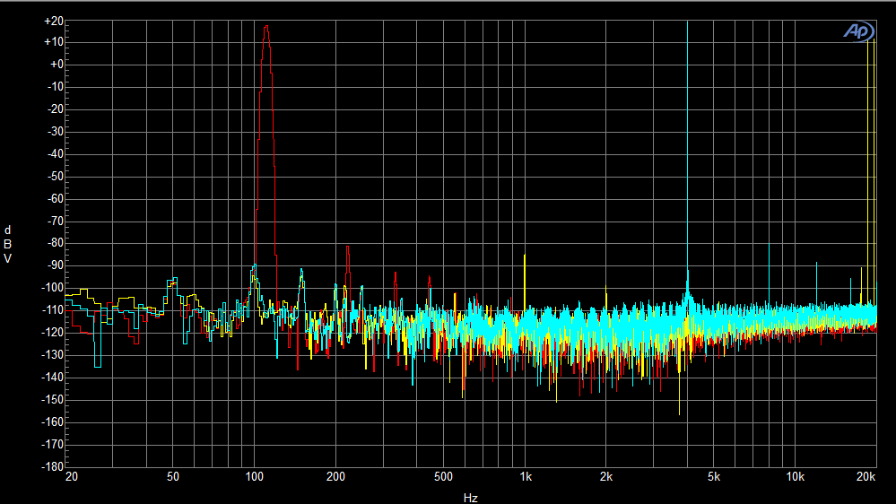

I was able to do some measurements of the (shielded and grounded) FE proto on the AP rig.
Rload was 3.67R, Supply 18Vac toroid (+-24V rails), standard bridges, 4700uF. Speaker return at PGND (relay unused).
20R source resistance, no input cap (C13), floating drive (no leakage currents through R11).
A teaser here :
attachment.php
Red : 111Hz @250mVrms input (8Vrms/17W out)
Cyan : 4kHz @300mVrms input (9.6Vrms/25W out -- close to the maximum with the supplies I used)
Yellow : IMD 18.5kHz+19.5kHz (150mVin each)
Harmonic distortion is around -100dB (0.001%) with a nice monotonic decrease of higher orders.
At lower levels the HD quickly vanished in the noise floor.
IMD is better than -90dB.
Hum/buzz components with these signals are 110dB down (and effectively non-visible with no input signal).
A very respectable performance !

Hi Klaus,
It means R11 shorted?
If so it would be interesting to know if with R11 populated results are different.
R11 was in place. Floating was referering to the AP's output (xfomer coupled), no current can establish in R11. And as I stated before, any current through it will cause a voltage (1V per ampere) and that voltage appears 1:1 at the output. It does NOT provide ground loop "isolation".
For the other two questions, yes and yes.
