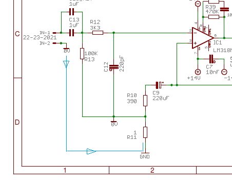

I did see what I think soongsc is refering to with R11. The blue path can't be completed because R11 performs "Groundes Interruptus". Correct? :D

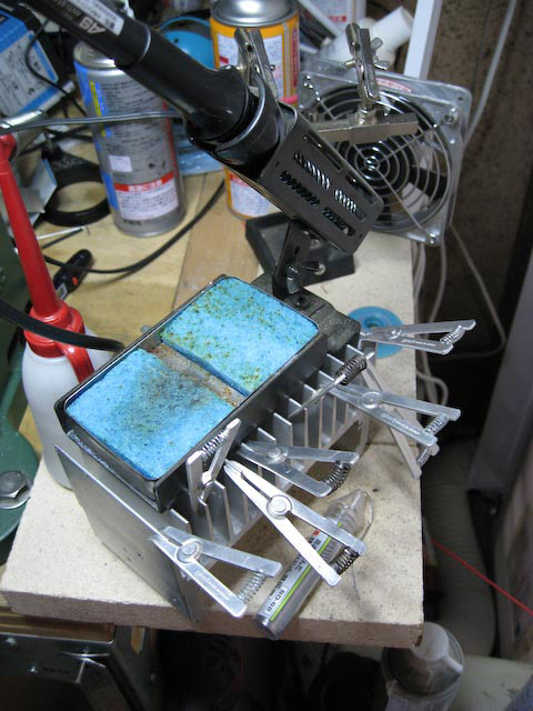

Andrew mentioned heat sinks for soldering heat sensitive capacitors, I keep mine clipped to the fins of an old heat sink, they cool down really quickly after use. Bench is getting messy eh!
Bill

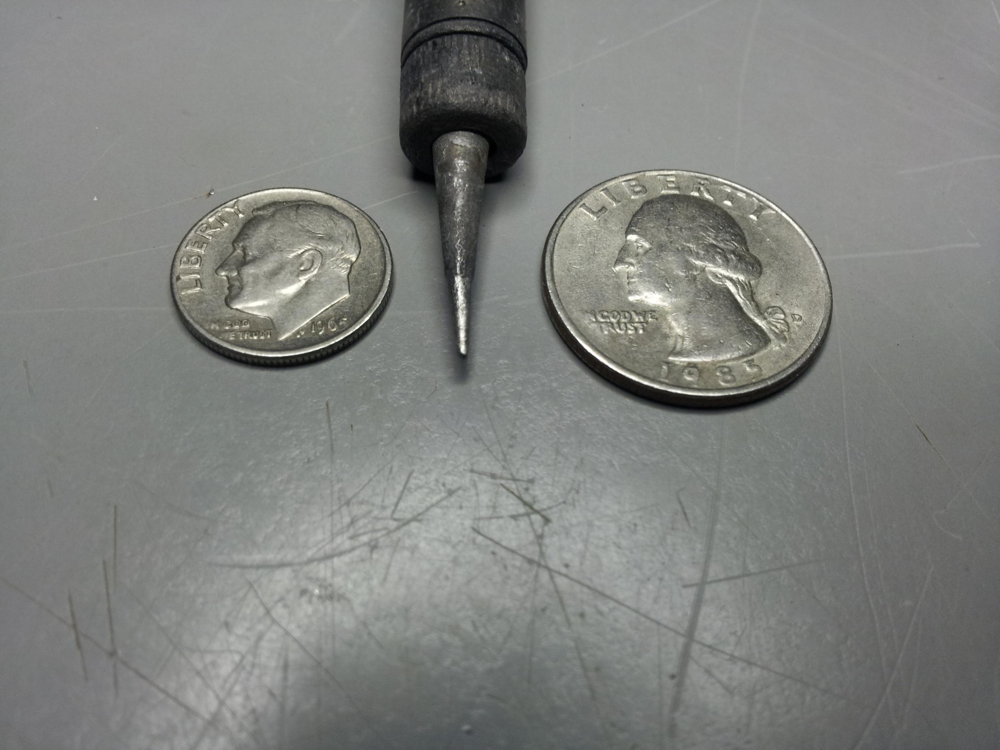

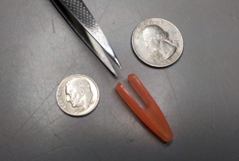

Stahl Tools SSVT Variable Temperature Soldering Station 374-100
The tip came with the station and has a replacement package identical to the one included.
Stahl Tools SSRT 4-Piece Soldering Tip Kit for STSSVT 374-102
Tweezers came from my local CVS drugstore.
