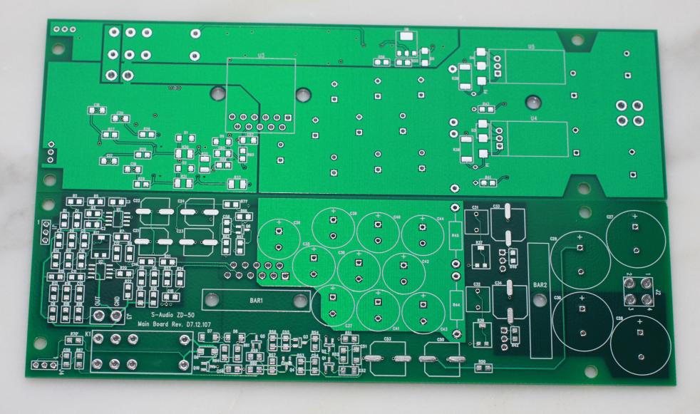

I have received the new boards, now soldering and assembling the amp. Read my blog here http://www.s-audio.com/

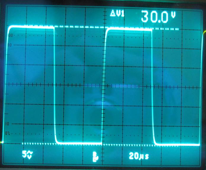

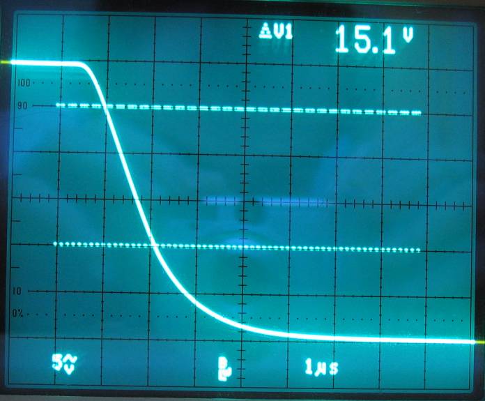

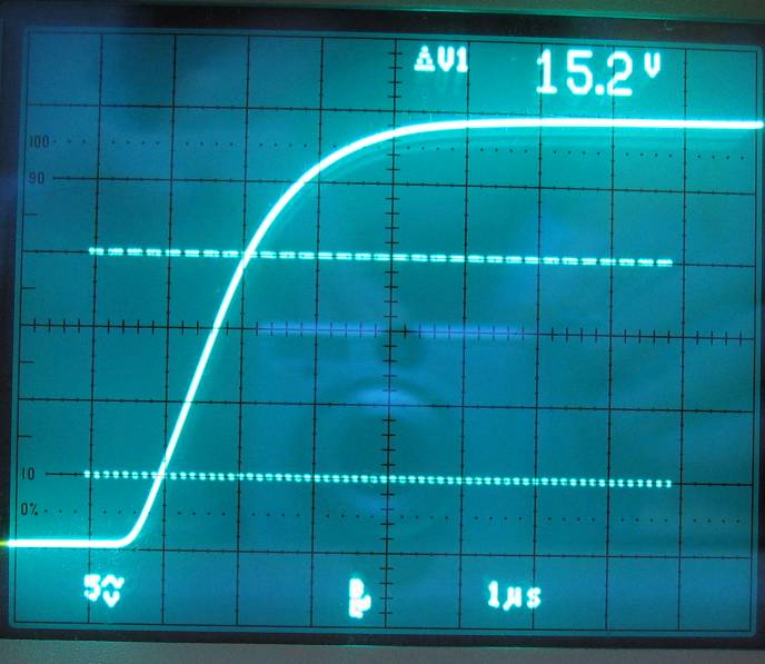

Square signal without input/output filters:
PS. The input filter is phase linear too (Bessel's).

Dear Nickolay,
Thank you for your responses. I believe firmly in your concept. My own experience with nested feedback chip designs are the same as yours. Extremely detailed and bass so tight that it is shocking.
One last questions. I see your PCB layout, excellent! Did you ever tried to use one whole ground-plane instead? Maybe in attempt to reach a even lower ground impedance.
There is of course not "Right or wrong" in this and many concepts will work. Lately I am studying a lot about ground-planes, and I wonder if there are even more benefits with using a whole ground-plane for the whole board without interruption.
Again congrats with your great design! I think you would do the DIY community a big favor by producing and selling your boards.
