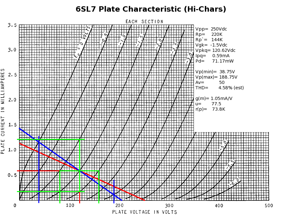

If that's the case, then that Russian 12AX7 is no good. It happens, though not to me. I did a design using RCA 6SL7 plate characteristics (see attached) and used Sovtek 6SL7s in the implementation. The design nominal gain was 25V/V/phase for an LTP, and the actual measured gain was 25 for a 0% error. The only deviation was that the Sovtek 6SL7 measured a Vgk= -2.0V against the design nominal Vgk= -1.5V (the LTP used active tail loading).
In this case, the Russian 6SL7s were true 6SL7s and conformed quite closely with the RCA characteristics.

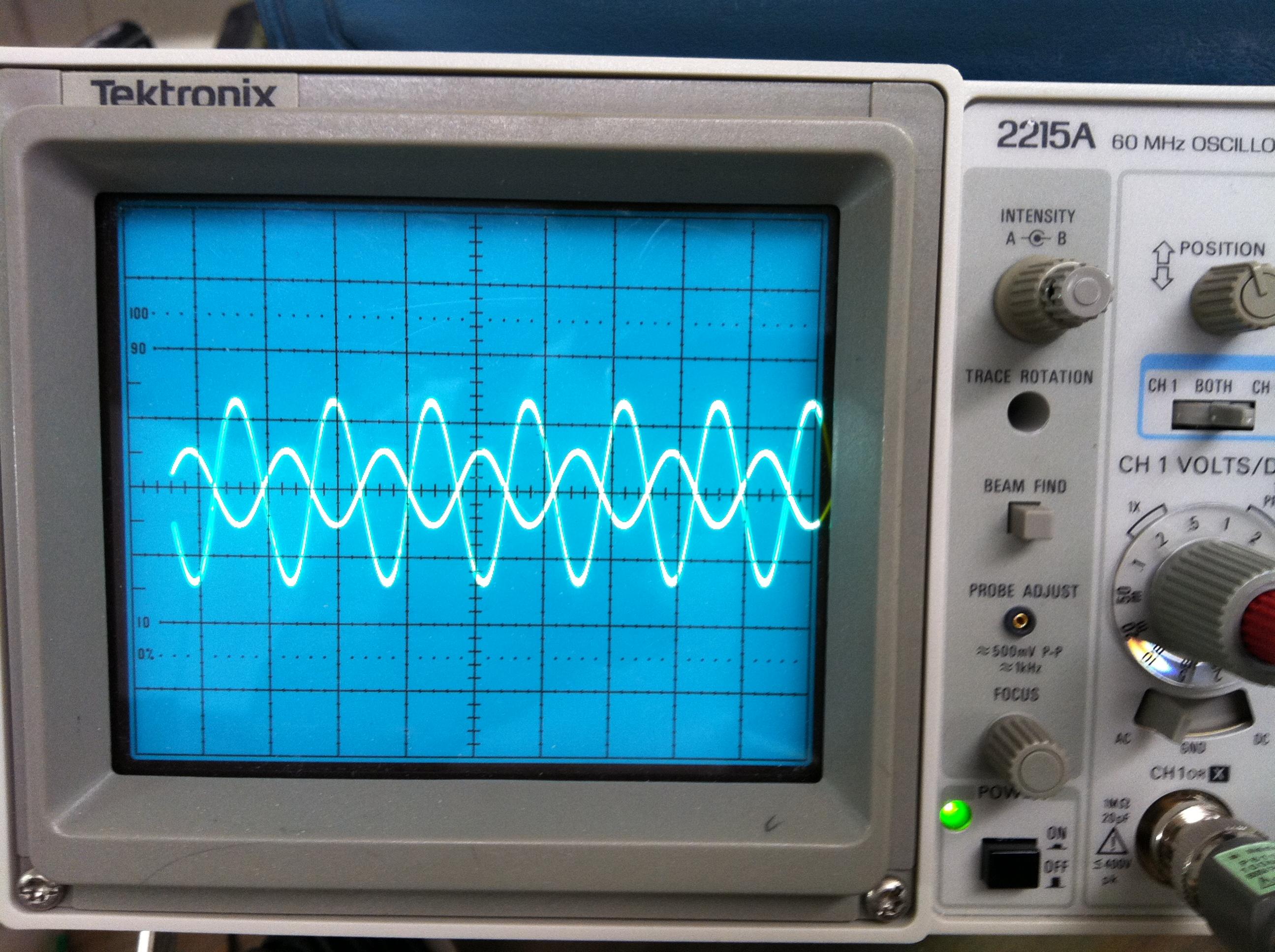

My LTP is out of balance and I can't seem how to balance it. I've tried changing load resistors but that changed the gain but the out of balance seemed to remain the same. Any suggestions would be helpful. I've attached a sketch of the circuit and a pic of the dual traces tapped at A and B on the circuit.

Your LTP may be out of balance because the supply is too low or the input voltage is too high. The Mullard ECC83 LTP splitter runs the valve along a narrow channel between cutoff and grid current. If the anode voltage gets too low then in order to maintain the anode current the grid bias gets smaller and this creates grid current. This causes a voltage drop across the 1M2 resistor so the second triode is biased back. Having too high a voltage at the anode of the EF86 first stage also causes this. You can't deviate too far from the Mullard voltages (e.g. 70V at first stage anode).
