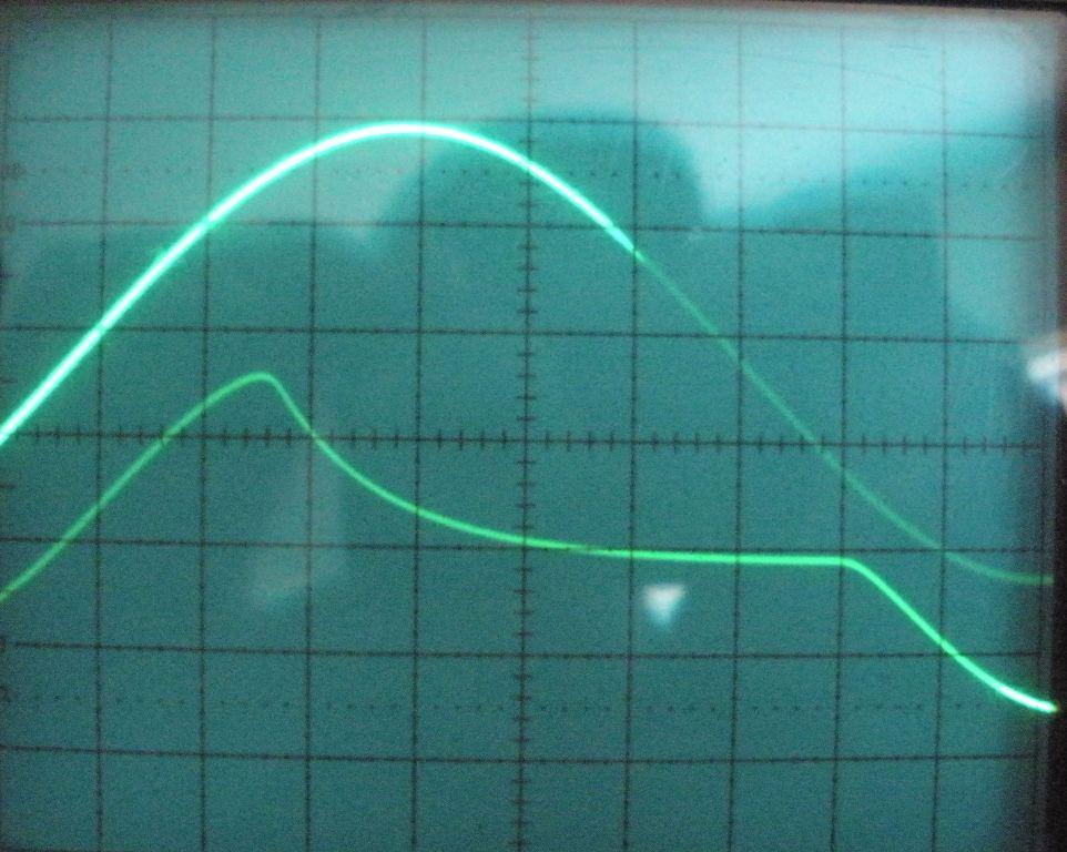

The overshoot is clearly visible. Last and not least, it is a 1kHz square and time axis is 200us/div, compared to 10us/div I have shown. I hope I do not need to explain such elementary issues.

I realize I need to eliminate the over shoot and ring but how far can you round the edge before comprising HF? I know listening is the final proof.

You need to look at the TRANSFORMER! (And how it behaves driven by a pentode) Open loop... Until you accept this you are just chasing your tail.. 😀
I don't think square wave test of audio output transformer have much of usefulness, especially taking into account that interpretation of the result is quite difficult (and not so obvious). Square wave composed of leading/falling edge (rise time of several MHz), and DC between them. This is not something large audio transformer supposed to work with. Take for example overshoot. Formula for calculating overshoot is quite complex, but combination of lower leakage inductance and lower distributed capacitance lead to higher overshoot. So, almost perfectly looking 2KHz square-wave on output may be a sign of not so good transformer after all.

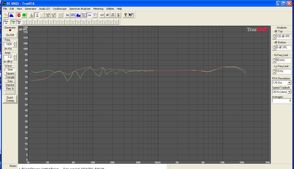

I did a sweep with the only tool I have. You might recognize it. It is designed for speaker analysis. Which I don't think works well for this application.
Tested at 1 watt. The green line is with NFB, the red no NFB. Questioning the results I looked at in and out at 41 hz. The wave shape appears to support what the sweep shows. If I remove the NFB the input sensitivity goes way down and both shapes become flatter (less pronounced) (no photo, sorry). But the output is still distorted.

The amp does sound better. Or so I thought. Looking at the sweep results I don't see how it could. I didn't sweep before I changed the coupling cap so maybe it alone helped the bass response.

LF -3dB 70hz, HF -3db 55khz (55khz can that be right?)
What on the square wave indicated poor LF response, the slope of the line from leading edge to trailing edge?
What else did you see that suggested the OPT was inexpensive?
By the way, my trace was very slightly rotated (low on the right) when I took the photos for my first post.
How did you determine I'm having HF oscillations, from the rise in dB between 10k and 20khz on the RTA sweep?
LF drop 3dB at 70 Hz is too much (may be you meant 17 Hz ?). BTW, no transformer is capable to make good-looking LF square-wave because DC component is too "long". The only transformer capable of transferring DC is a shorted one between primary and secondary - not something you are looking for.
Once again, square-wave is not suitable to test audio transformer.
One test which is useful and can tell something about core construction/material quality is to unbalance idle current of output tubes (+5ma for one and -5mA for another) and load amp with 20 Hz sine-wave at max power. Small cross-over distortions are OK, but core saturation will point to poor material or construction quality.
3dB down at 70Hz is a pretty significant and early roll off, and is due to insufficient primary inductance for pentode mode operation. I would try UL operation as the local feedback should improve low frequency extension at least a little at no significant penalty in output power. Triode would be better still, but at a huge penalty in output power. I would probably go that way anyway.. 😀
