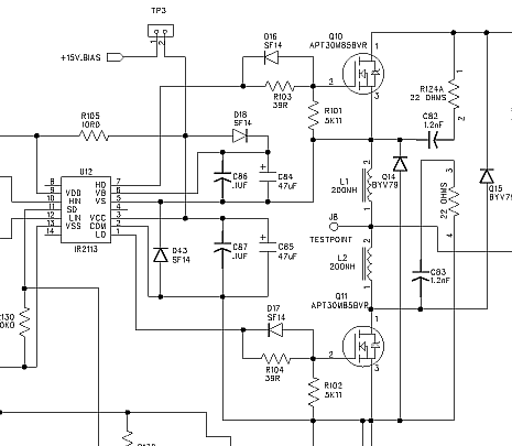

After studying the Crest LT schematics a little bit, here are some thinks I would like to point:
-The circuit is fairly simple, specially if you remove all the fancy protecions (Autoramp, IGM, ACL, refer to Crest webpage for details).
-The output stage is accomplished with a simple level shifter using a PNP transistor, then it is inverted with an XOR gate (the other non-inverted branch is also passed through another XOR gate to equalize delays) and then goes to a IR2113 driver. It is exactly the same as IR2110, which is the very similar to the above discussed IR2121/25 pair.
-The output filter is very clever: it uses a 2-pole LC filter (L5/C93) and then a notch filter. This can be adjusted to cancel just the switching frequency.
-The dead-time is only accomplished with a diode and a resistor in the gate of the mosfets, relying on the gate capacitance to form the time constant. It effectively delays the rising edges thus minimizing the shout-through effects.
The circuit can be very simplified and still work. I have noticed also that it doesn't use strange or sophisticated components as fast comparators or opamps.
I think the output stage is basically the same as the Crown cct that I used. I wonder how they got around the patents? I think the gate resistors for slower turnon is to reduce reverse recovery effects in the diodes that carry the inductor current, not fot shoot-through problems which this topology does not have.

Well, Circlotron, you are right in that the BCA topology doesn't have shout-through problems, because botch mosfets are not ON at the same time (except for 0V input). The driving signals for the high and low side mosfets are obtained, respectively, by PWM modulation of the input signal and its inverted version.
:att'n: BUT, the Crest LT topology is a conventional Half-bridge output. That is, the driving signals are, for the high/low side, the PWM modulation of the input signal and the inverted version of the modulation. Thus it CAN have shout-through problems.
I am not sure if the diode and resistor in the gates is for the dead time control or for the effects of the diodes as you suggest :scratch2: , but what I am sure is that the Crest LT output topology and working principle is not the same as the BCA amplifier's.
I think that I will try with the conventional half-bridge topology first. I am doing some tests with a SG3535 as the modulator, now that the level shifting stage and mosfet driving is clear. I will tell you how it goes.
