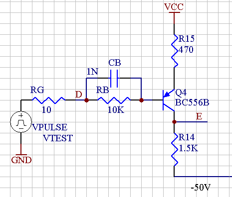

Whel, now I think I have things much clearer. I have done some simulations and designed the level-shifter stage, based on PNP transistors.
I am going to build the PWM modulator with a MAX038 triangle wave generator and MAX912 comparators.
I will make it flexible so I can try the BCA and plain "half bridge" output stages.
Let's see how it works.
By the way, Circlotron, do you have measurements of the quality of the sound you are getting from the amp? I mean bandwidth, noise, etc. How does it sound at very low volume?
Have you tried to make it full-range (20Hz-20Khz)? Do you have much ripple?
I will post a proposal of the schematic as soon as I have drawn it.
Best regards.
ssanmor

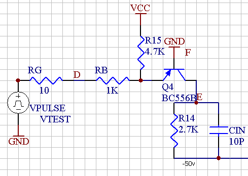

May I give some suggestions:
If you use PNP transistors for the level shifting circuit:
1.) use them in commom base circuit and not common emitter
2.) don't turn them fully off during the "off" phases
These two measures should make the circuit faster.
Regards
Charles
I would try to simulate the following for comparison:
Connect the base to ground and drive the emitter via a properly sized resistor. Connect another resistor from the emitter to the positive supply that keeps the collector current during the OFF phase at about 5% of the ON current.
Regards
Charles
Thanks,
I have tried this (see image)
The results are nearly the same. The (on) current is 5mA, while the off current is 300uA.
The problem in both setups appears when you load the circuit. I don't know what the input capacitance of the IR2110 is, but with a 10pF load (CIN in the circuit), you get about 100ns rise/fall time, and it must be bigger, I am afraid. What do you think?
The advantage of the common-base circuit is that it doesn't invert the TTL signal.
Best regards
