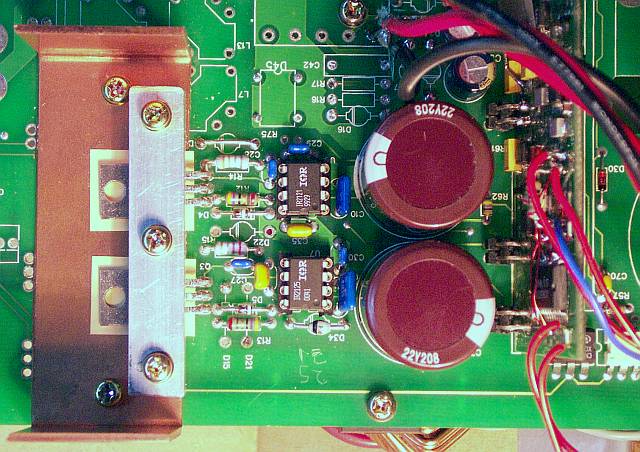

My very first Class D pwm (switching) amplifier.
You need a duty cycle limiter to prevent shoot through on clipping.
The cct isn't subject to "normal" shoot-through, in fact at zero output both fets are on 50% duty cycle, but are on *at the same time*, not alternately. That would be curtains for a normal totem pole pwm output stage. If I have missed your point please tell me.

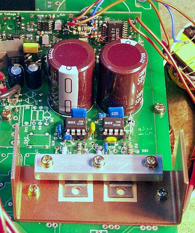

Meanwhile I'll go out to the shed (it's about 9:25pm Sunday night here and heading toward Winter) and take a few photos like I promised. Should have them posted in 20 minutes or so.
Birds eye view
z

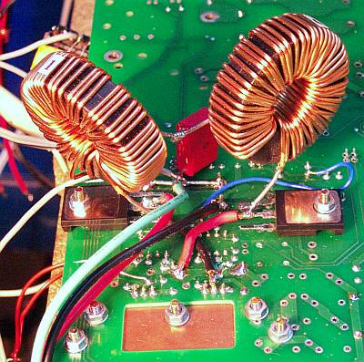

Aww, that's cool djk. 🙂 Anyway, fired it up again tonight with a more robust 40-0-40 volt supply, changed the current sense resistors to 40 mR and organised a better quality audio feed. Power output is now 133 watts into 6 ohms (my test resistor) woohoo! That was 40 volts peak. from about a 41 volt rail. There is still something tricky though. I could only get that power output on a tone burst. If I ran it continuous tone I could get perhaps half that power and then it would go sort of unstable. One clue though is if I touch the metal tab of the schottky that is under the pcb furthest from the edge, the one who's tab is flapping up and down 80 volts, the fuzzy distortion I spoke of the other day gets worse, and if I touch it harder the amp cuts out till I let go. The input wires to the pwm chip are unshielded and only about 2 inches away. Maybe some HF is getting back into there. Have to have a look-see another day.
80v p/p on the load resistor was a sight for sore eyes. :nod: Oh yeah.

Tried a 33k and 1nF LPF at the input to each comparator on the modulator just in case any noise was getting in. That was it! :idea: Sounds much much better now. None of that fuzzy crossover-like distortion. Also earthed the centre of the +/- 40v rails - that fixed the problem when I touched one of the schottky's and the amp would cut out. Then I gave it my 6 ohm load and fed the loudspeaker at the same time via a 100 ohm resistor so I could listen to it while it was pumping some real power to "Sultans of Swing". 🙂
Anyway, I noticed something interesting. The amp doesn't have any negative feedback which probably helped the situation, but when driven into clipping on music signals you can hardly notice it at all! Often the wave would flatten for as much as 1.5 mS at a time. Peak output at clipping was +/- 39 volts, but for the last 1.5 volts the wave would slow down exponentially and then hit the clip point, or rather it would approach the clip point and then gradually slow down almost asymptotically and gently stop right on the line. When it was time to move away again it would move away at a right angle. No fuss, no bother, no rude noises or oscillations. As a result, on voice signals in particular, the apparent loudness could be wound up quite a bit further than what maximum power would otherwise dictate. Would make a great PA amp I reckon.
When running like this for about 15 minutes the schottky's got to just above skin temperature and the mosfet heatsink to about 35 deg C at about a 15 deg ambient. Judging from the load resistor temp, the average power output would have been about 35-40 watts so I was shoving it reasonably hard. Ahhhhhh....... niceness is radiating out of this amplifier indeed. :clown:

I didn't really calculate the output filter, I just used something from my junk box that looked about right. :cannotbe:
Schottky diodes should have a voltage rating of whatever the total dc voltage rails are. I will eventually have + / - 50vdc so I have used 100v diodes. Schottky diodes are MUCH better than normal fast recovery diodes here - you don't have to worry about reverse recovery current and all the noise that goes with it.
