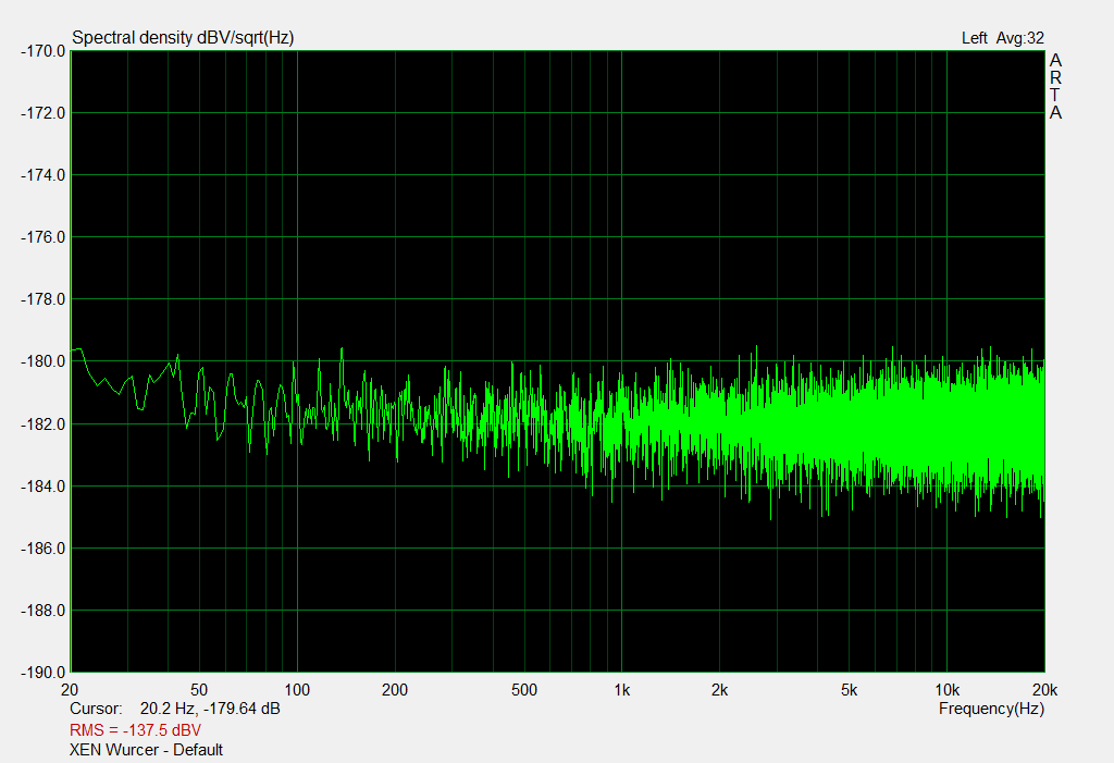

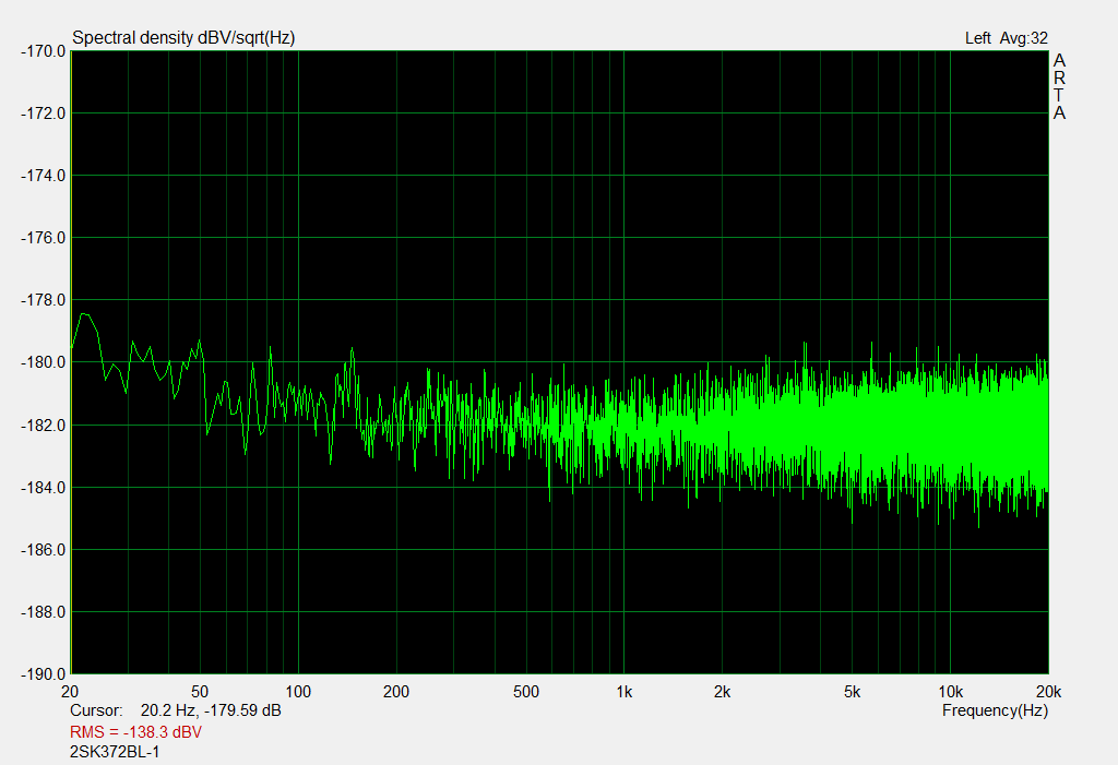

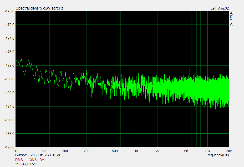

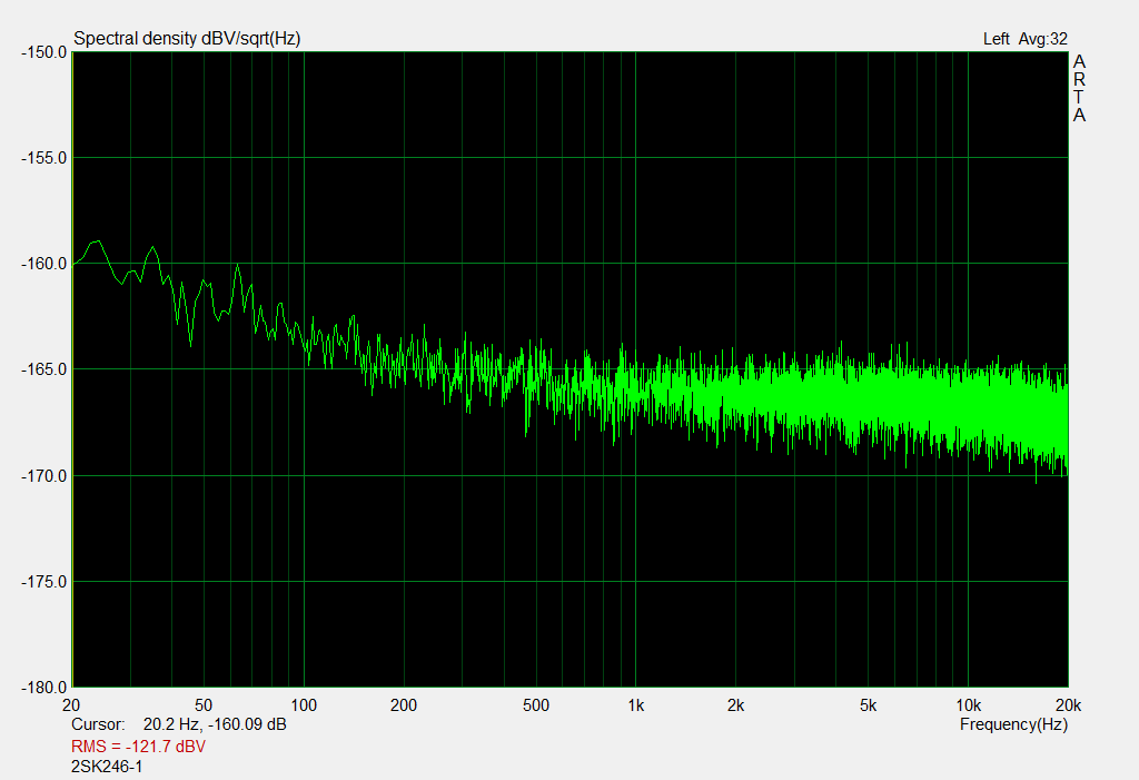

JFET measurements in action.
2SK372GR ~0.8nV/rtHz).
2SK372BL same as 2SK372GR.
2SK369GR ~0.89nV/rtHz
2SK117BL ~1.26nV/rtHz.
2SK246BL ~4.5nV/rtHz.

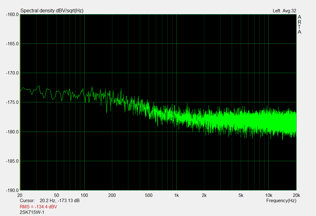

2SK715W ~1.26nV/rtHz

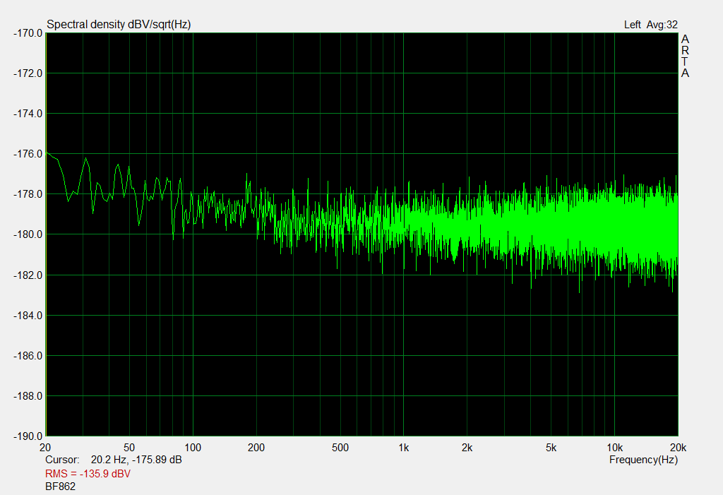

BF862 on TO92 adapter board ~1.12nV/rtHz.

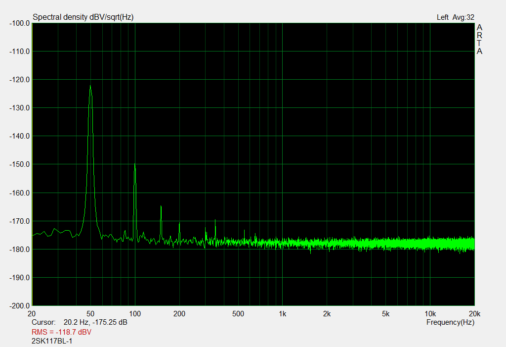

Please ignore the 50Hz stuff for the 2SK117.
It was because the legs were too long and hence the case was not covered fully.
These measurements are extremely sensitive to grounding and shielding.
Taken that into account, the 2SK117 is surprisingly good.
Patrick
Patrick
did you try the new On Semi parts, and those they inherited from Sanyo?
They now have at least one in the BF862 class.
What is the frequency for the measurement?
Gerhard
Gerhard

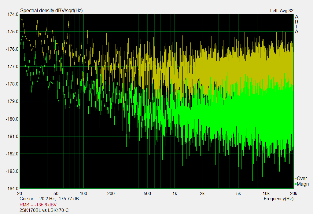

Another interesting one -- 2SK170BL vs. LSK170C.
Yellow is LSK.
And we have measured multiple devices to make sure it is not just a bad example by chance.
Luckily we have lifetime stock of Toshiba's. 🙂
Patrick
A couple of things for everyone's information.
1) The 2SK715 plot nicely shows the GR noise signature.
2) The 2SK246 probably has a low enough GM that the fixture BW is starting to roll off at 20kHz.
3) The SK170 comparison would be fairer if it took into account the gm. Both 2 & 3 are addressed by something like a QuanTech where the DUT sits before the preamp amplifying it's own noise with its own bias setter. Unfortunately the comparison here would indicate the LSK part would need 4X the current to equal the Toshiba. The LSK's I have are a little closer but beware the first samples of SJ74's are far short on their beta parameter. The more recent date code was far better. Generally I don't fault a FET on noise if it fits the theoretical value (~.7/gm noise resistance) and does not exhibit excess low frequency noise.

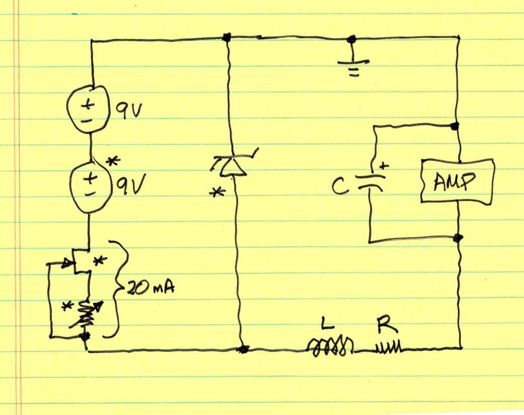

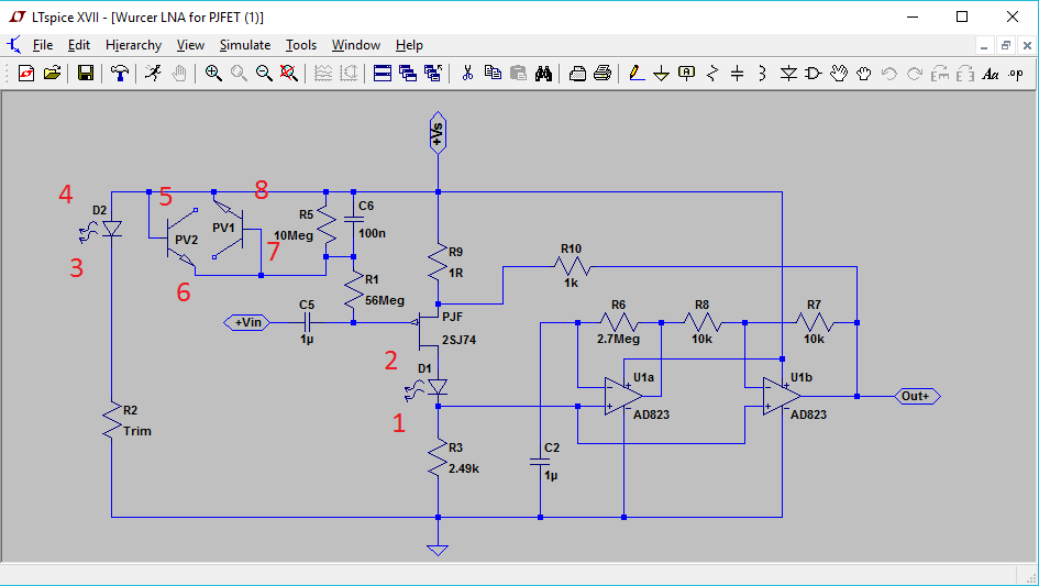

Scott,
Before I made some stupid mistakes, I thought I better ask the inventor first.
How would you change the circuit to measure noise of P-JFETs ?
I guess only the front end needs reversing ?
Thanks in advance,
Patrick
Thanks in advance,
Patrick
If you are using this to measure noise for the Jfets I would borrow from the Quantech the selectable resistor to ground. - short, 100 Ohms, 1K Ohms 100 K Ohms and 1 Meg. You can then get voltage noise and current noise. Probably to get meaningful 10 Hz noise you will need a larger coupling cap.
