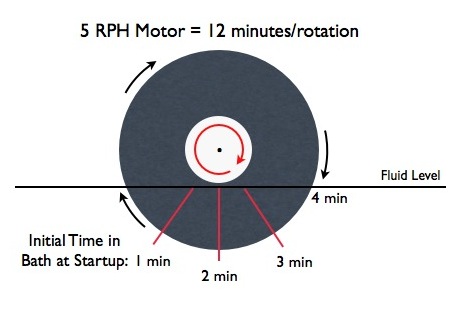

BendBound: What is the rotational speed of the Vinyl Stack unit you are using? Too fast can also reduce the cleaning effectiveness. If I remember correctly they were like 1 rpm vs the 1/10 th rpm needed.
Zg925 asked: What is the rotational speed of the Vinyl Stack unit you are using?
My version of Vinyl Stack allows you to set the voltage. I use the lowest setting of 3V (it goes up to 12V in a series of steps). I put a stop watch to it to see how long it required for one complete revolution. That was 6 minutes 12 seconds.
I normally employ a cleaning session at 13 minutes. That permits two complete revolutions. My thinking since half of the lp is out of the solution, that 13 minutes time means each side is fully exposed to US energy for only half that much time.
If you are submerging the record all the way up to the spindle then you would be correct. However if you are only going up to the edge of the label then you are only submerging only one third of the record at any point in time. So on a 6 minute rotation any portion of the record is only submerged for two minutes. You can verify this by making a mark when the record first goes in and time till that point exits the water.
You are quite right. I just worked out the math for that given a standard record diameter of 11.75", the chord length at the water line at 4" height (just over label in my case) is 11.14". If I did the math right, the surface area of a record is 108.38 inches square per side. The surface area submerged is 32.57 inches square per side. So 30% of the record surface at a time is exposed to US energy per 6.25 minute revolution or ~1.9 minutes of exposure. If one wanted a full 6 minutes of exposure, the rotation time needs to be closer to 20 minutes. If one wanted ~5 minutes of exposure, the rotation time needs to be about 17 minutes.

I recommend using a 5 or 6 rph motor and rotate 1 time, or slightly more than 1 full rotation. That gives 1 rotation in 12 minutes or 10 minutes, allowing for about 3-⅓ to 4 minutes cleaning action for a given part of the surface of the record, which is perfectly adequate in my experience.
B B
Reactions: Calvin
Thank you for re-posting those details. The Vinyl Stack at its slowest setting, 3V, is one rotation in 6.2 minutes or 9.7 rotations per hour.
Likely I'll return to 13 minutes for a cleaning, to put total US exposure time to an entire record at between 3 and 4 minutes. I could continue to use 15 to 17 minutes which would be slightly more than two revolutions and closer to 5 minutes of total exposure.
If the records are clean upfront, maybe the shorter time is best. If they are dirty garage sale finds, I'd consider closer to 20-21 minutes on my set up.
