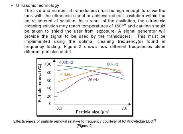

Vincent, I posted on this topic early in the thread. There is plenty of published work from ultrasonic experts on this topic. It's valuable to hear anecdotes from vinyl aficionados, but subject matter expert opinion should also be considered. Here is a very good primer that includes simple guidelines on frequency selection:
Ultrasonic Cavitations and Precision Cleaning by: Sami B Awad
The calculations for pressure and localized temperature at 20kHz are something to which, I personally, would not want to expose my favorite LPs. And please note the sections about sub micron cleaning and delicate cleaning at 60-80kHz. Excerpt:
"Cavitations are generated in the order of microseconds. At the 20 kHz frequency, it is estimated that the pressure is about 35-70 K Pascal and the transient localized temperatures are about 5000°C, with the velocity of micro streaming around 400 Km/hr (Figure 2).
Several factors have great influence on the cavitation's intensity and abundance in a given medium. Among these factors are the ultrasonic wave form, its frequency and the power amplitude. Other determining factors are the colligative properties of the liquid medium, including viscosity, surface tension, density and vapor pressure; the medium temperature and the liquid flow, whether static or dynamic or laminar; and dissolved gases.
In general, at low frequencies (20-30 kHz), a relatively smaller number of cavitations with larger sizes and more energy are generated. At higher frequencies (60-100 kHz), much denser cavitations with moderate or lower energies are formed. Low frequencies are more appropriate for cleaning heavy and large-size components, while high frequency (60-80 kHz) ultrasonics is recommended for cleaning delicate surfaces and for the rinsing step.
For example, at 68 kHz, the cavitation abundance is high enough and mild enough to remove detergent films and remove submicron particles in the rinsing steps without inflicting damage on surfaces. The 35-45 kHz frequency range was found to be appropriate for a wide range of industrial components and materials."

Another post I made on this topic earlier in the thread introduced this graphic into the URC discussion. It shows particle cleaning effectiveness as a function of frequency and particle size. As most of the particles to be cleaned from an LP surface are in the 1 to 5 micron range, the 80khz curve seems to show max effectiveness. One could presume a 60khz line would be somewhere in between the 40 and the 80 lines. Thus, 60khz and 80khz would be slightly advantageous for cleaning effectiveness vs. 40khz, and certainly better than 25khz.
