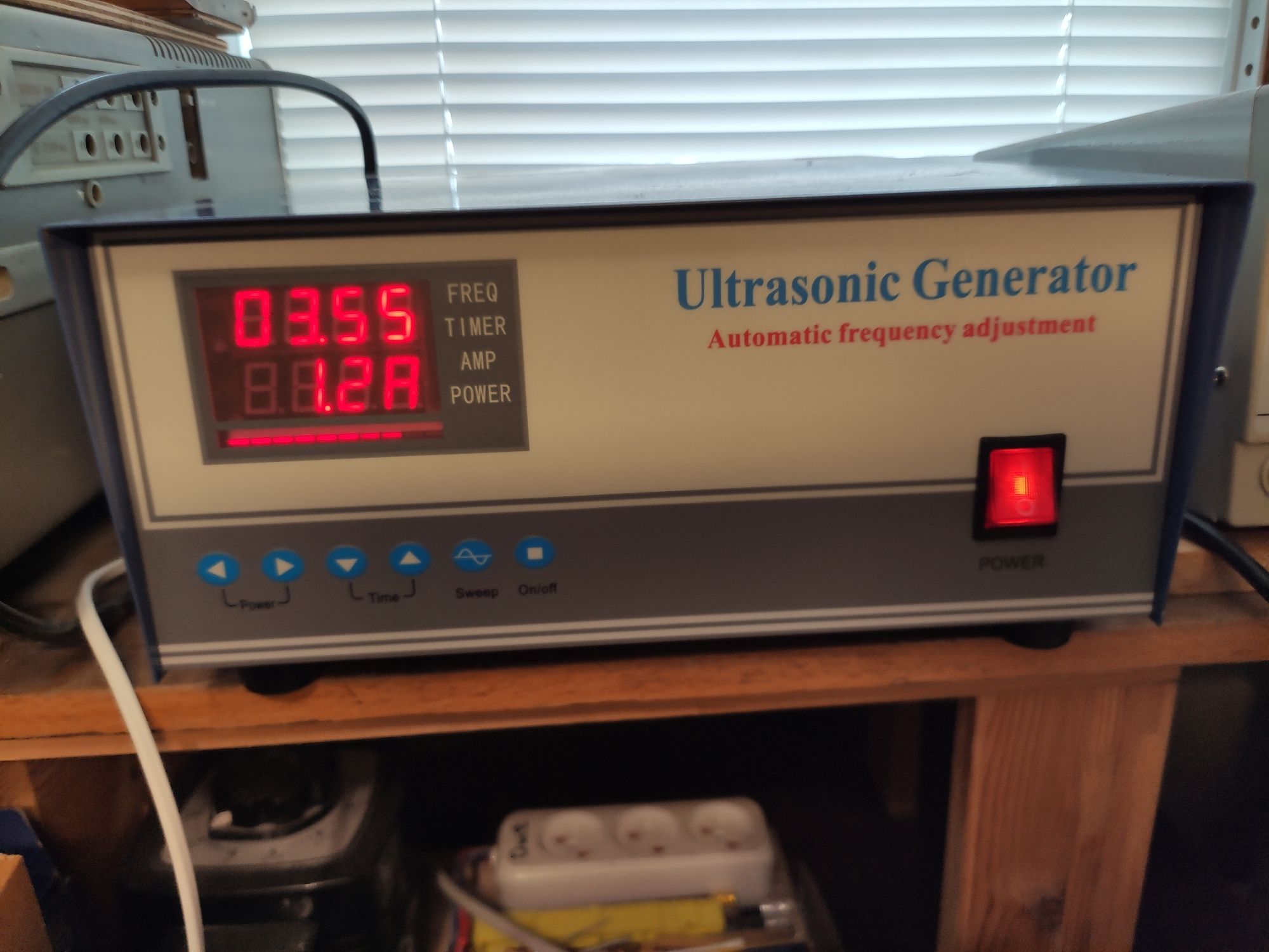

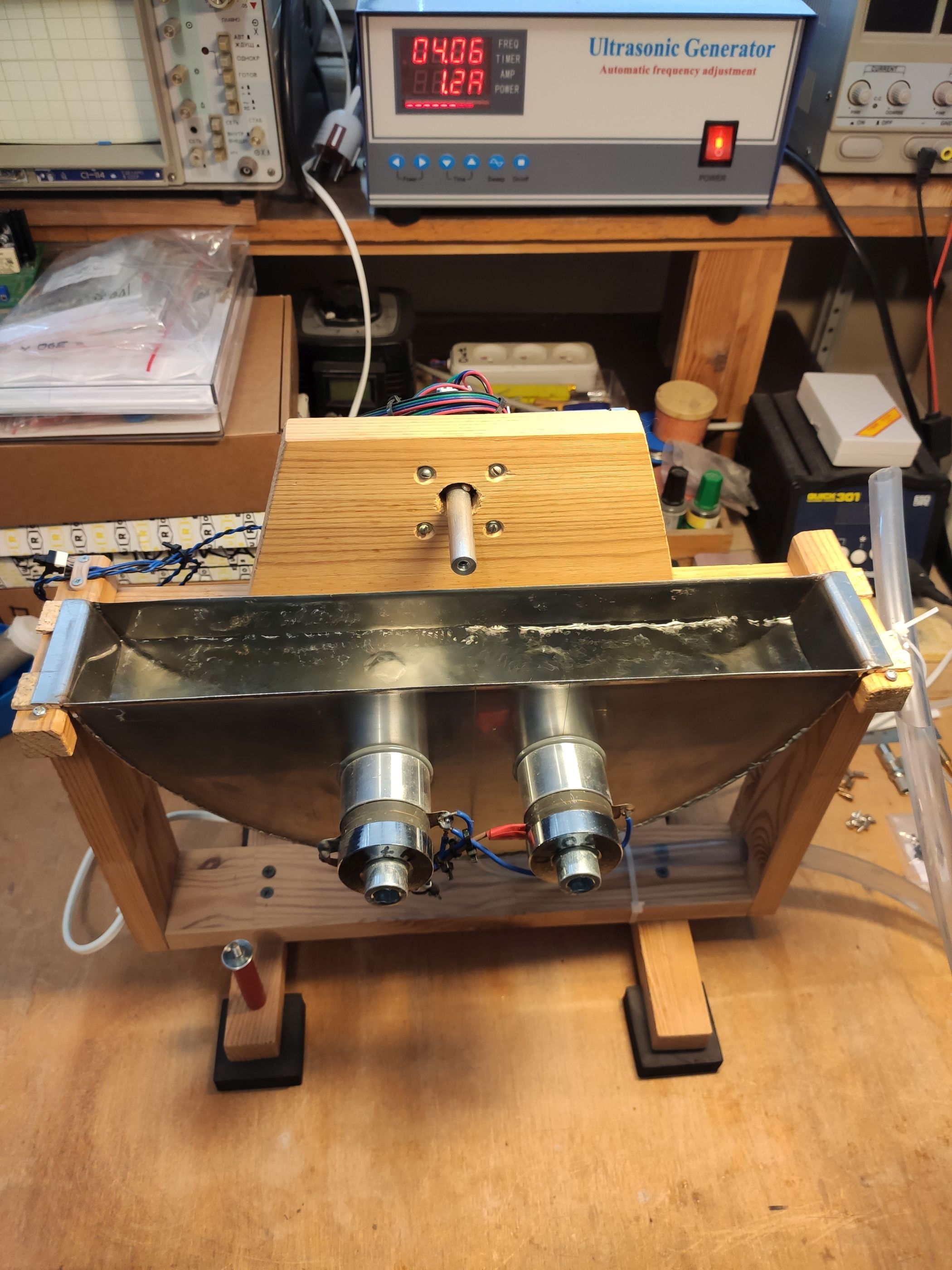

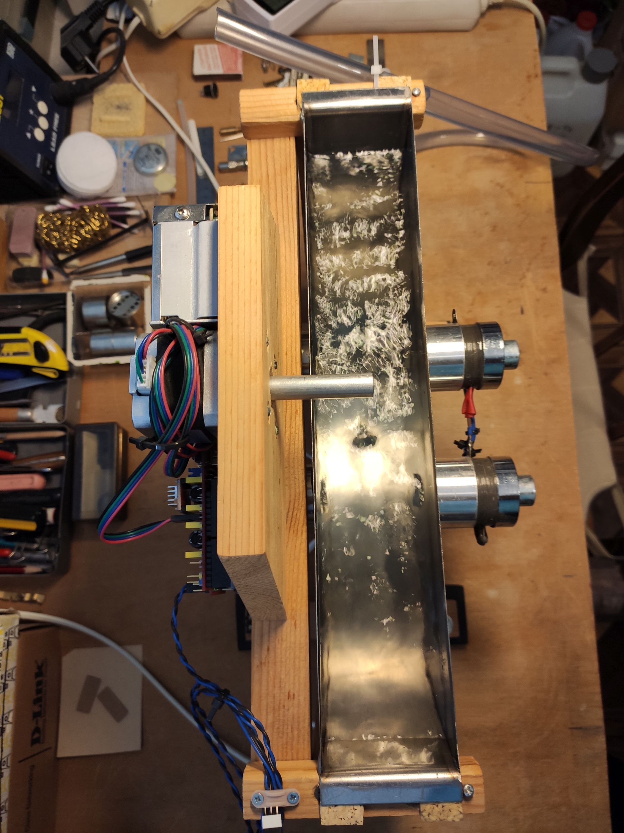

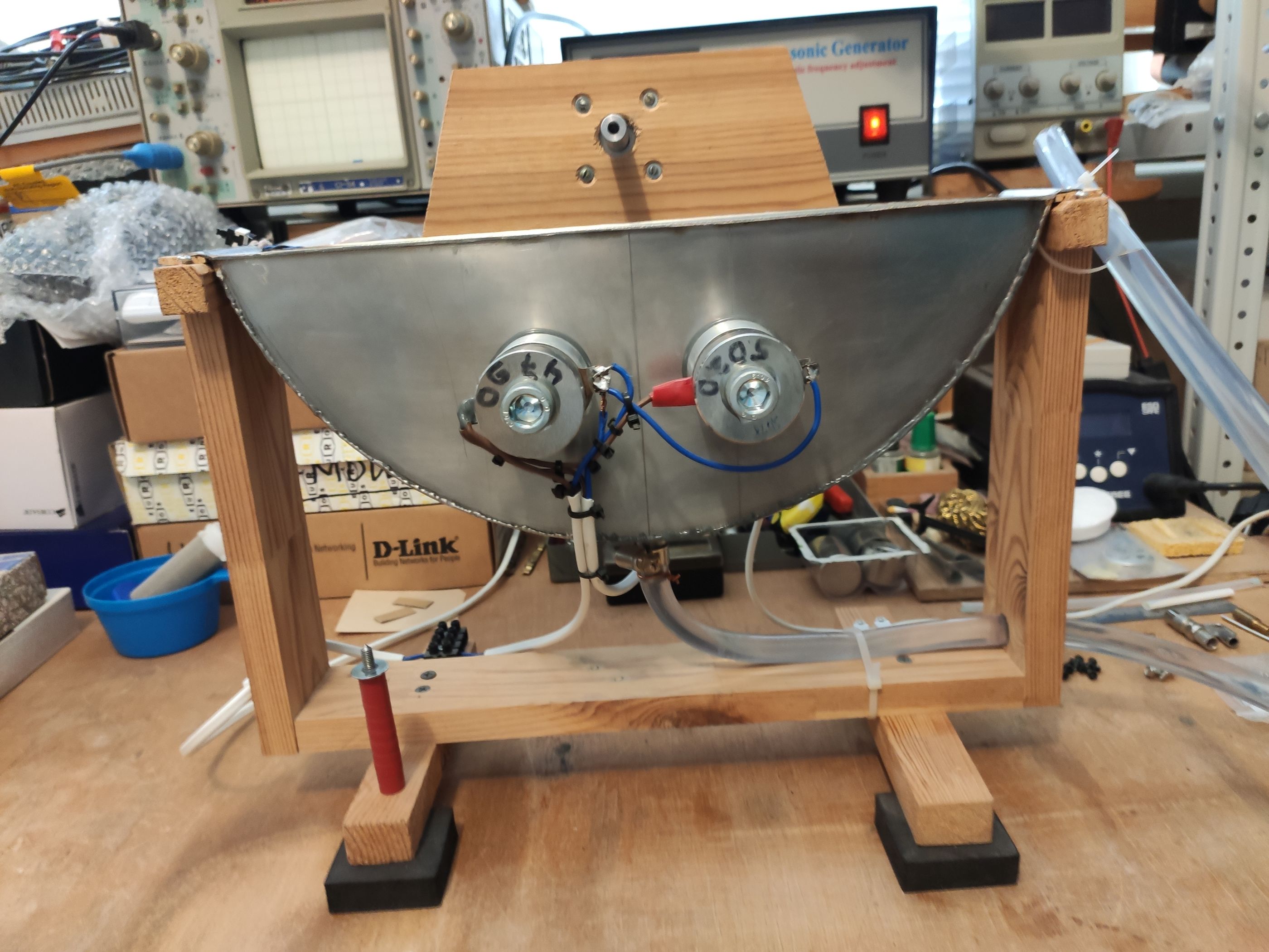

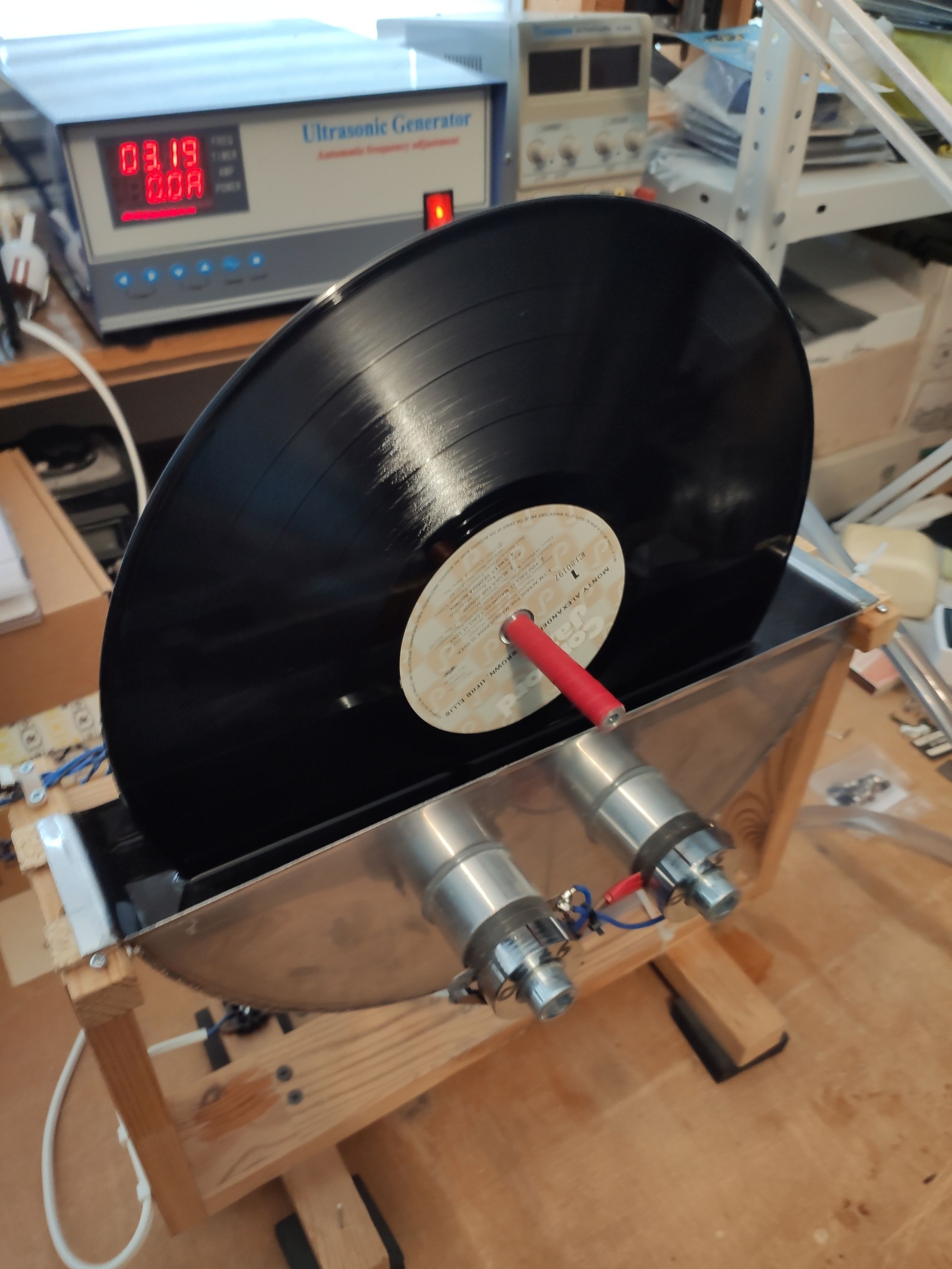

Just finished my DIY ultrasonic cleaner. Four 80 kHz 60W transducers running at 240W total. 2.5 minutes for new disc, 5 min for old and very dirty. I use stepper motor NEMA 17 controlled by Arduino for rotating vinyl.
Cleaning solution is distilled water with Isopropyl alcohol and Triton X-100.

Dear ak60
may I ask, where did you bought the 80kHz transducers? What is that US generator, can you share its specs?
Thanks!
80khz ultrasonic cleaner transducer High Frequency Ultrasonic Cleaner types of ultrasonic transducers|Ultrasonic Cleaner Parts| - AliExpress
aliexpress.com/item/32623959041.html?spm=2114.12010612.8148356.5.7125bb44AwKatB
