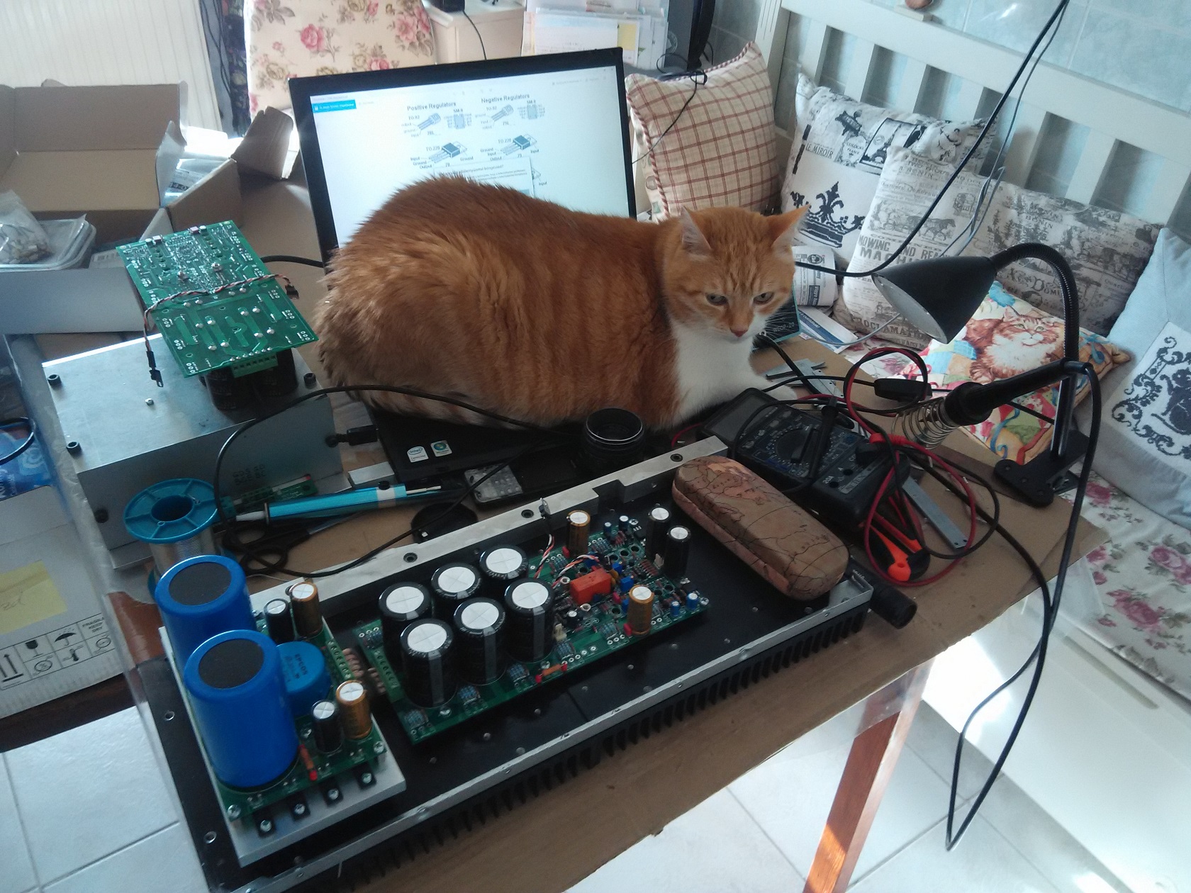

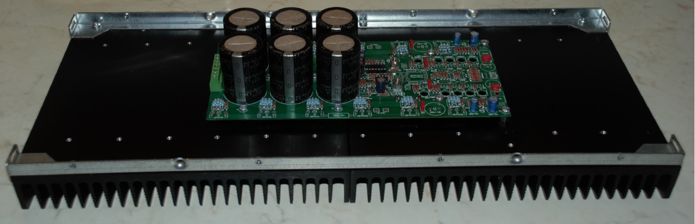

First pair is getting ready slowly:

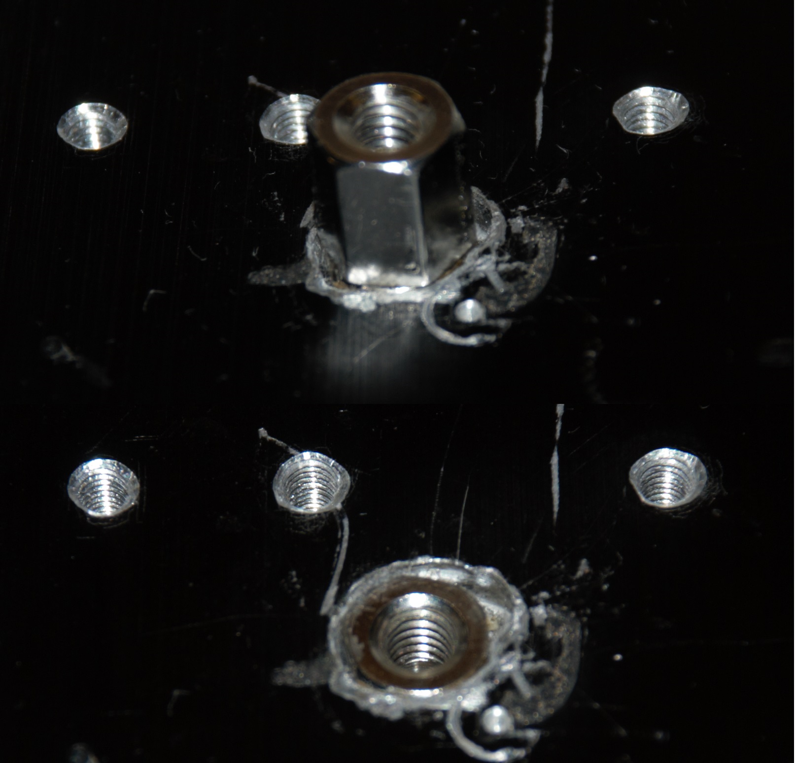

This was a heat sink made of aluminum.
It was just a bad move.
I have made 44 threads in blind holes.
Ten was M3, thirty four was M4.
I broke only one, but it needed more work to repair, than make the remaining forty three.
O.K..
I will make yet three other ones, as this one:

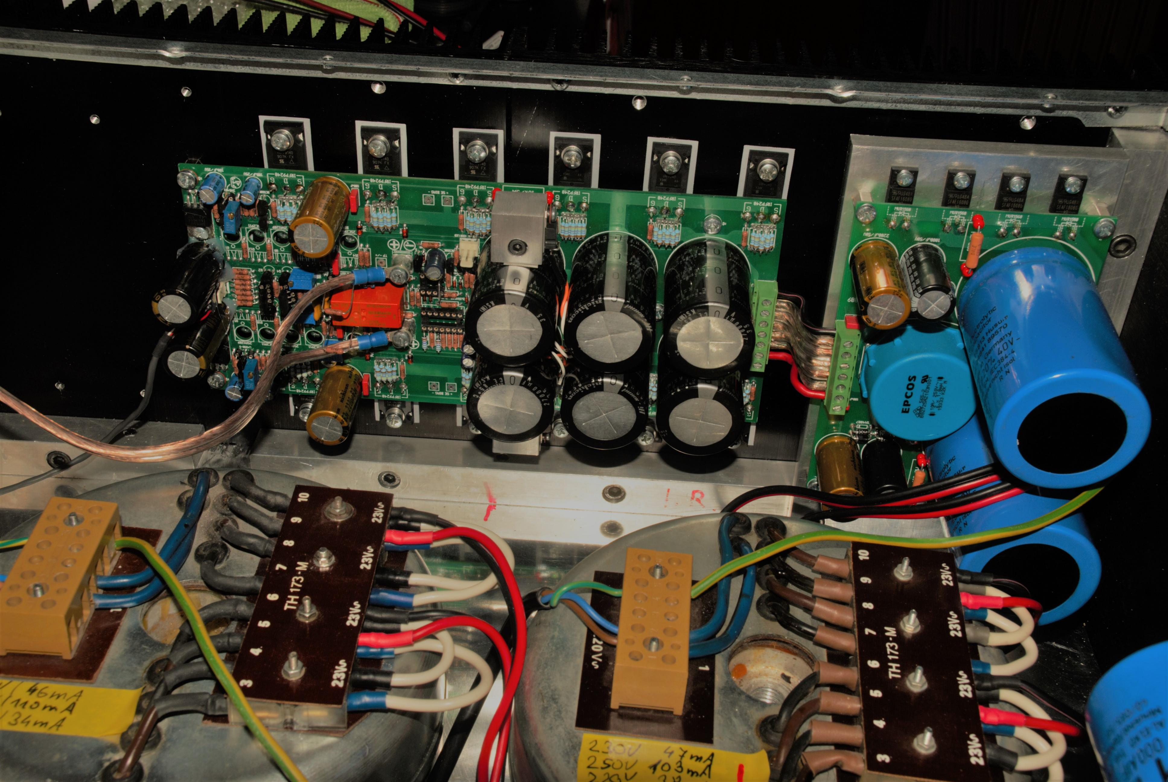

It is one of my best equipment, I simply love it:
Actually, it works.
Initially I followed original schematic, and voltages.
https://www.diyaudio.com/forums/attachments/pass-labs/901481d1607873302-ugs-power-amplifiers-french-connection-ugs-power-amp-schematic-pdf
I set my Schuntermann to output about 182VAC, in this way I've got 23VDC for output stage, and 30VDC for frontend.
Everything is fine, after I've changed those BC550s to BC560s, what I've put in a wrong place.
But I have a strange problem, what I can't resolve.
Differential DC protection switching on and off constantly at about once/second.
Any idea, what is going wrong?
(On this picture you can see my not so ideal solution for this problem.)😉
