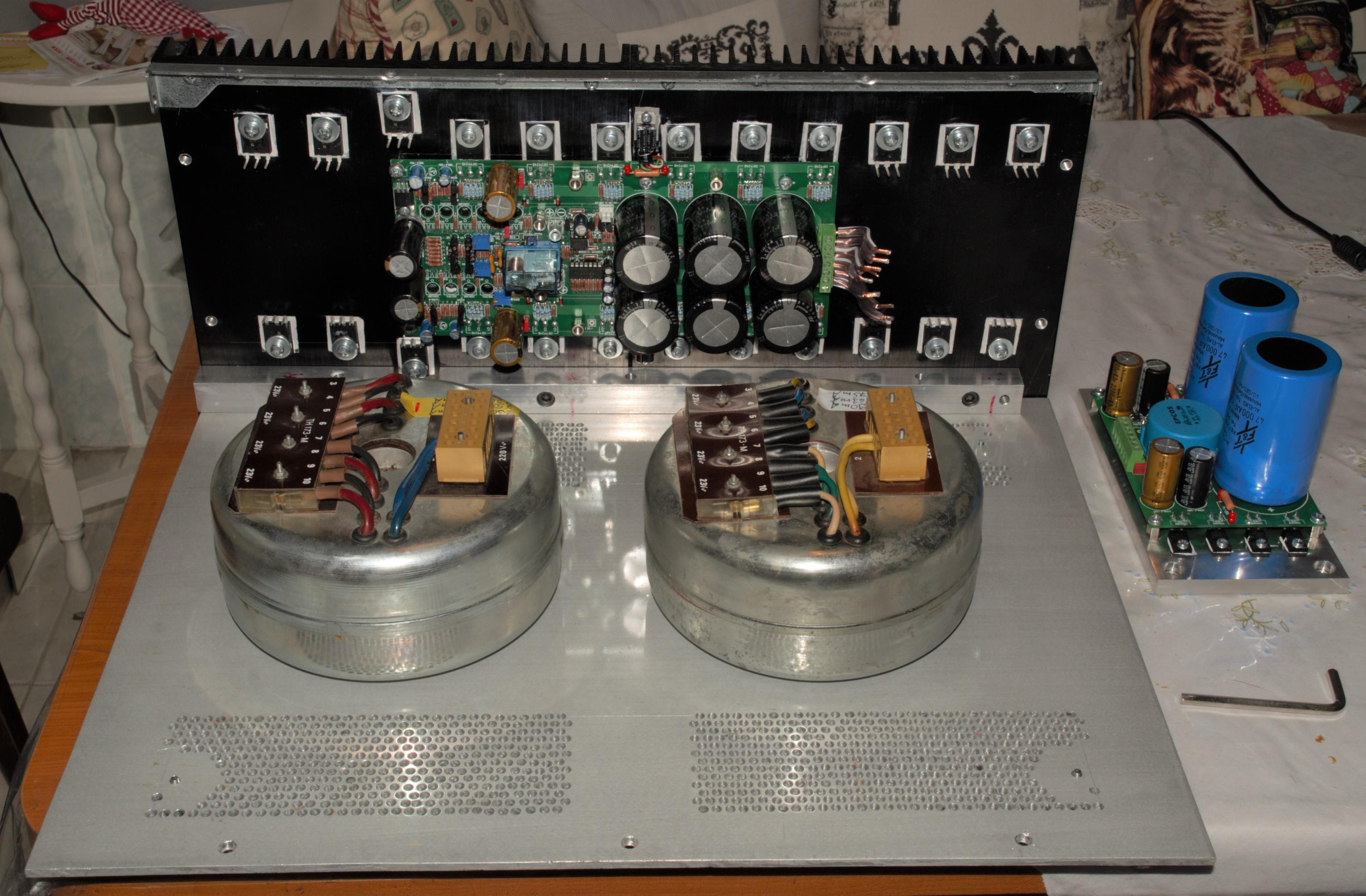

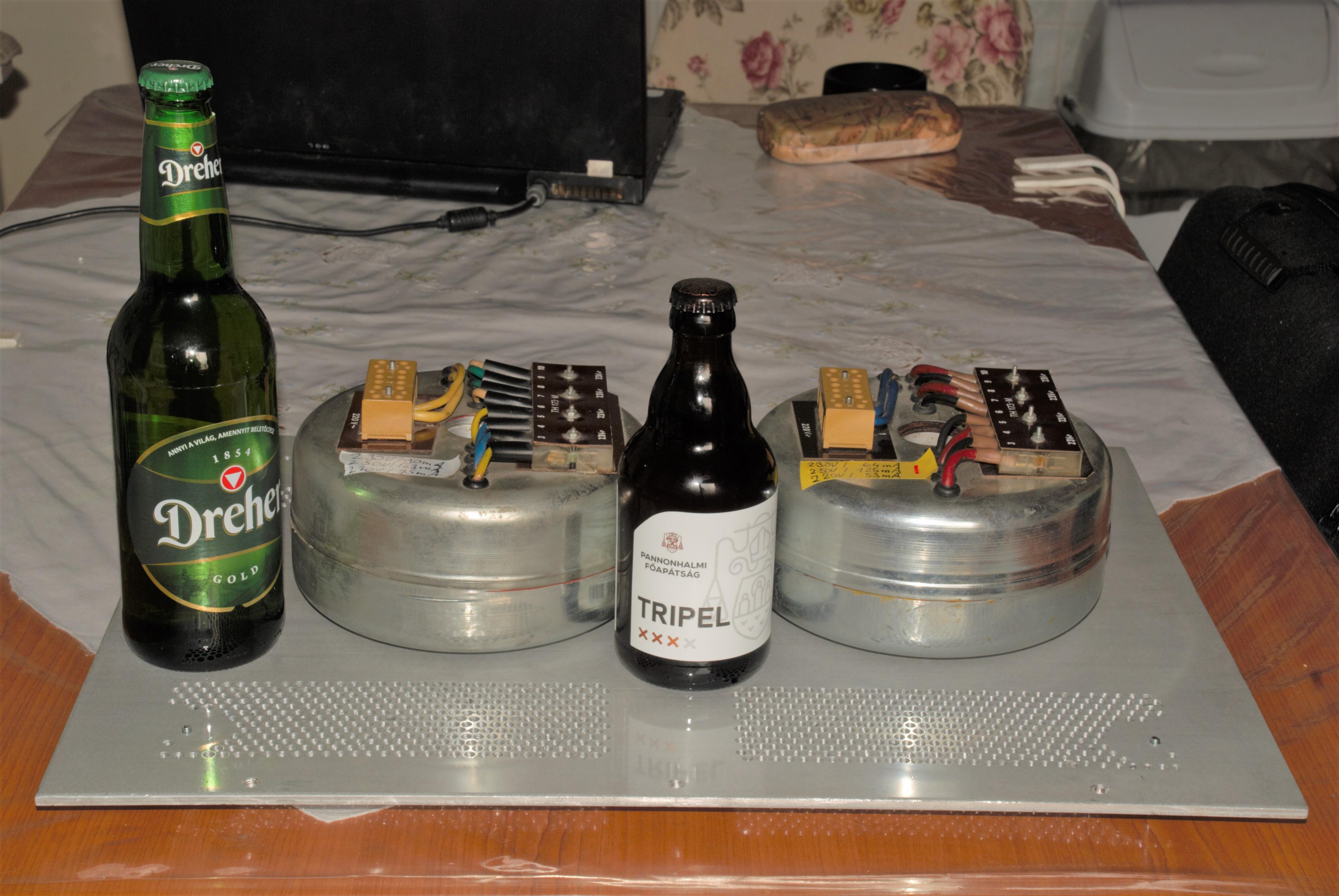

Custom made base plate for my Modushop H210: (Excuse me, Gianluca it is better for me with 5mm aluminium plate than 3mm.) 😉

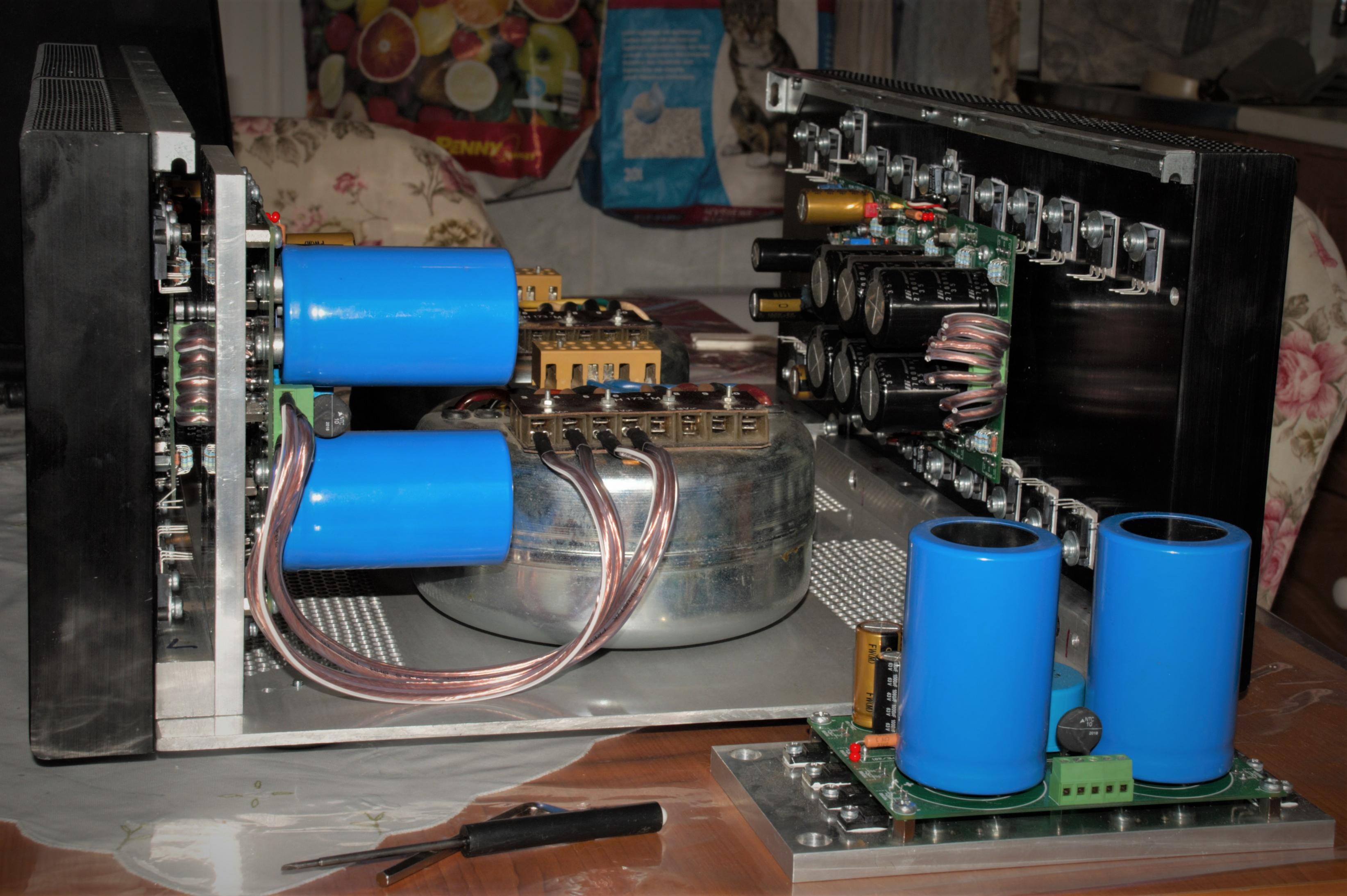

But, as I'm a real trouble seeker, I must have to connect extra output fets yet.
Somewhere I've read, there is a big no-no for solid wires in an amplifier. Yet, I think, I will connect sources and drains of extra Fets with 2.5 mm enamelled copper wires.
