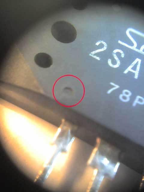

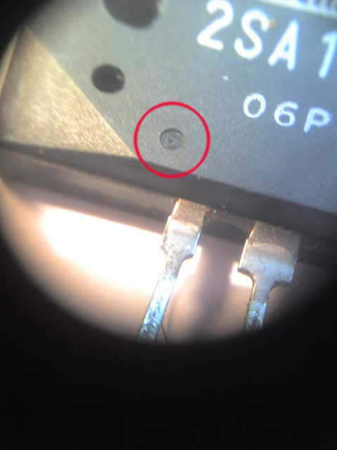

Dear fellows.
I analized some sanken transistors that I bought in different places , and besides that the "suspects" ones have a low beta, I discovered something that i would like to confirm .
I have attached two photos, I marked with a red circle the zone of interest. one has a number engraved inside this small circular recess, and the other is blank.
the one with date code 78P is definitely a fake.
Could this be considered a "rule" for detecting malicious sanken's ?
any comentarie will be appreciated
regards
Alexander rubli

if it had been the TO-3P packages, i would have better data for you on the dimples in the plastic. however, the second picture shows a dimple with rounded edges, as if the case had been stripped with a wire wheel or sandpaper, so that device is suspect. the dimple in the first picture has sharp edges.

If theres a "6" or "9" there could be a difference
On the fakes I have seen shown here especially the number 6 and 9 are more rounded, which they are not on originals
Also it seems the small dot holes you have marked should be sharp edged and smooth almost shiny at their bottom
And all letters/numbers are nicely rounded at all ends
Mind you, Im no expert, I just happen to have some old burned ones :eek:

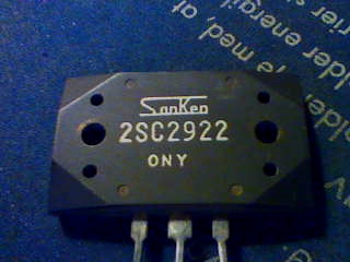

i just discovered something today about the font Sanken uses on their parts. it has to do with the curvature of the hook and the loop of the 6 and 9, the curvature on the leading edge of the 2, and the hook on the 1. study them carefully, and you will see the font used by Sanken is quite unique. the loop of the 5 is unique as well, but not as obvious. i haven't seen a 4 or a 7 yet, and the 3, 8, and 0 are not unique.

if you look at genuine sanken parts, their print font has some unique characteristics that set it apart from the printing used on counterfeits, namely the shapes of some of the digits. i thought what i said was clear enough, maybe it doesn't translate well...
now I understand - you mean the kind of labeling resp. lettering like the two different versions as show in the attachement from
Counterfeit Transistors
This is one of the features. But please note, there are more than one company, that make copies. Surely even those where no differences to an original Sanken are visible in the front label.
