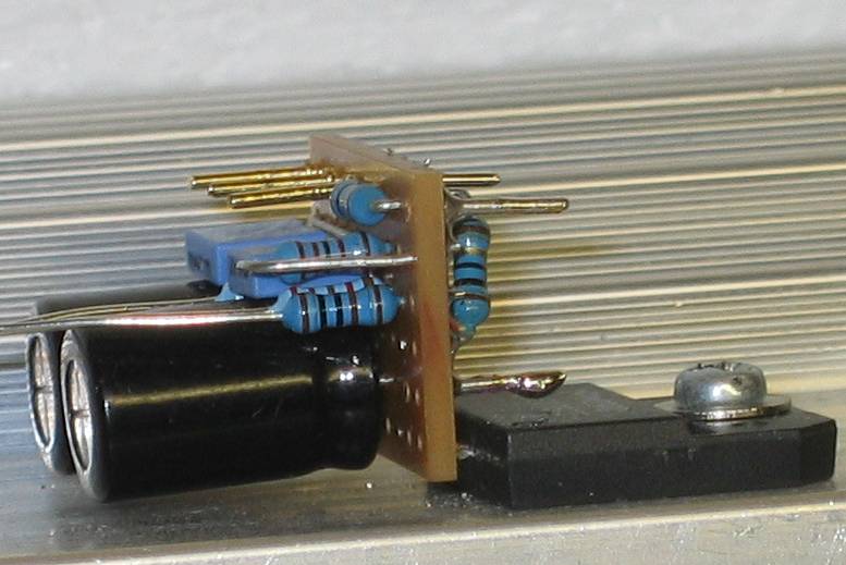

My tiny single sided LM3886 PCB layout. :)

Thanks! 😀

Hi Russ,
Very nice PCB. I've been trying to learn eagle but haven't produced anything yet. 😉
By chance, I made a little GC very similiar to this one, except I used a t-net for the feedback network. It was just an exercise in making it as small as I could. It's gotten a little ugly after changing the resistors a few times. My conclusion was if you make it too small it is very difficult to experiment with. Once you have the design finalised then its OK. 😀

Greg Erskine said:
Hi Russ,
thanks
The design is finalized here, it is really just the datasheet NI circuit. The funny thing is the "smallness" was never intentional, it just happens to be tiny. I designed it around the size caps I have. Really its not that small, and its easy to work with because everyting lies flat and flush.
Good luck with your design work.
