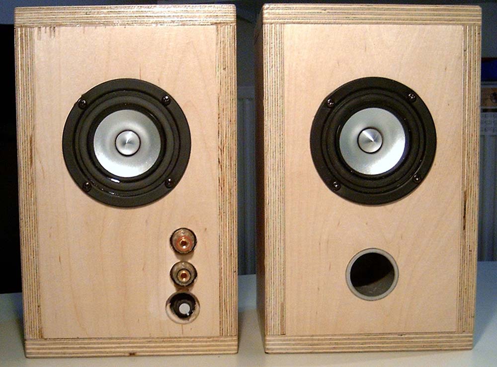

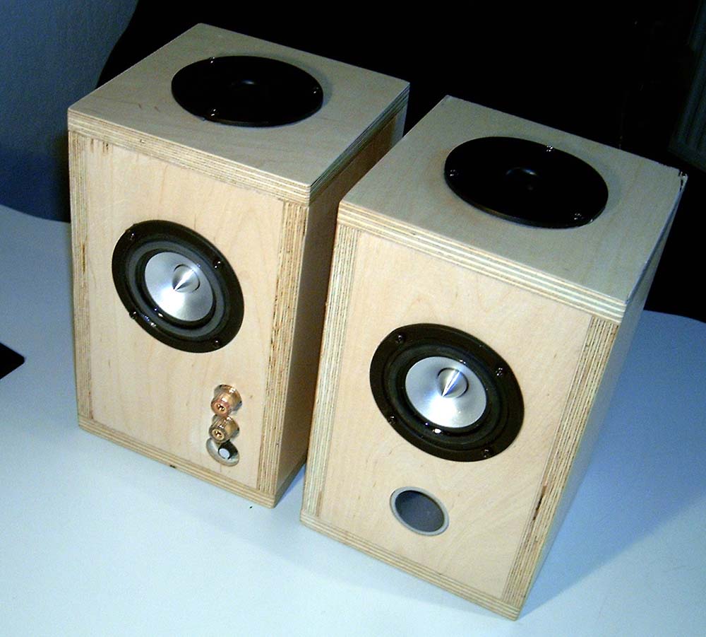

Finaly the loudspeakers a la Salas design are ready and i connected them to my Hiraga and played a cd from Dire Streets. Well, these nice, tiny, small loudspeakers sound very , very nice to me.
At the back of each cabinet is a stepped swicht, so i can change the filters resistor in 0R22, 0R33, 0R47, 0R56, 0R and tweeter off.
I must say i do not hear any differance, so i left the switch on 0R.
I used 89 dB tweeters of good quality.
I like these tiny things a lot. Thanks Salas, for your help and your design.
I have 2 (low quality) photo's but they are to big for this forum. I will mail mthem to Salas, so he can see the clones of his design.
All by all a very nice project!

Salas, last week my computer crashed so i can not look on my computer for your e-mailadress to send you my photo's. Can you please send me a mail, so i can mail the photo's to you? Thanks.
Thanks for sending me the pics. I am happy that you find TB3 nice, and Hiraga worthy 🙂
I resized the pics and I am posting them here for all to see your speakers. I guess that the better tweeters enhance the clone.
Maybe they are silkier than the cheap ones on the original, and being just a bit less sensitive aswell you dont need to play with resistors as you have found.
After your speakers get more broken in and you have listened to more music, we will be happy to know details about your sonic impressions. Your system is revealing and it will be interesting to know more from your tests.
