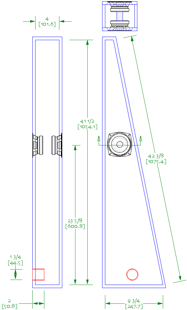

Here are some clearer plans...
I still have some of those drivers.
dave

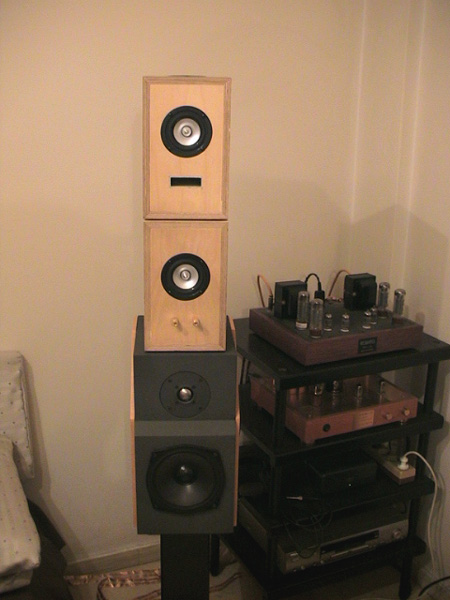

TB3 Revisited
I always felt bad about losing sensitivity when fighting TB3's natural presence dip with a notch filter (read higher in the thread).
I decided to experiment with a super tweeter. I also wanted to be innovative so to avoid the typical non seamless feeling that super tweeters impart to full range speakers. I chose Audax TW010F1 that keeps well with the very low cost concept of TB3 and it can be found on http://www.madisound.com/cgi-bin/index.cgi?cart_id=8077904.3234&pid=122 on nice price.
I checked many positions over a front to back arc and I concluded that when used on top, at a specific position, it blends very well, boosting the presence range without messing coherency.

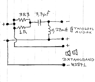

Just a cap as a tweeter filter proved inadequate distortionwise because of the Audax's high Fs. I ended up with the filter shown below.
Nothing exists between the bipole Tangband 871s and the amp now. Bingo! More sensitive, more dynamic, more open, more power intake, a brand new TB3!
The super tweeter can be easily fitted to any original TB3. It can be tested by being just attached on top with some Blu Tac. Its centre must be 6.5cm from the front top edge & 8cm to the left and right edges. You can play with R in the super tweeter filter if you feel increasing or decreasing its contribution. In my filter the parallel resistors total 0.77R and it sounds right in my room with my equipment. The TB3 revisited works best when you can see its top from the listening position at a low angle.

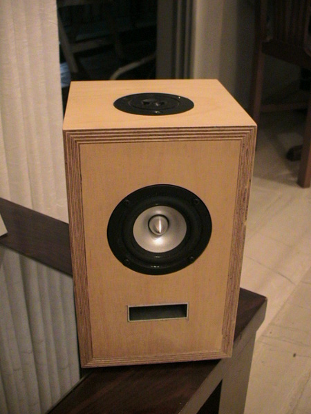

salas, nice work!
I plan to build your revisited TB3 too, and i have some questions:
Do you fill the inside off the cabinet with any (damping) materia or anything like that?
Do you make a seperate little enclosure for the tweeter?
Can the both resistors in your schematic replaced by one resistor (+/- 0,77 Ohm)? Wat power rate must the resistor(s) have, and must it be low induction types?
Is polyprpolene good for the cap?
What is the resulting impedance of 1 cabinet?

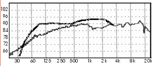

Neat little design... that is quite a low bass response for the 871! How did you measure it?
The FR plot is with the filter i assume. Do you have one without for comparison?
dave
Those little 3" drivers really go that low. It's necessary to have more Xmax to get some punch out of it and avoid trembling music when there are lots of low frequency content in the music. For low listening levels, it's great though.
salas said:
Speaker was facing 5m to front wall, open balcony to the world at the back, side walls were at 1,5m and 2,5m.
Mic @ 1.5m. MLS window 180ms. Checked the bass extention with 3 calibrated mics.
Yes it can be heard also. No big pressure but the 50hz region can be followed quite easily by ear when playing music. It did not detract much from same closed box power handling.
What smoothing on the data did you use?

Wim - I used felt pads inside, no separate box for the tweeter, 5W low induction is cool, yes one resistor is ok, you will determine its final value for your system and space, try from .33 up to 1 Ohm. Any 90 dB 8 Ohm 3/4 '' Tweeter will do. See image for IMP mag.
Soonqc - 1/3 oct smoothing. Are you connected with TB?
Regards
Salas
