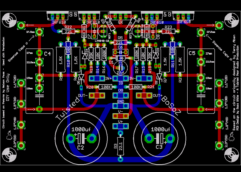

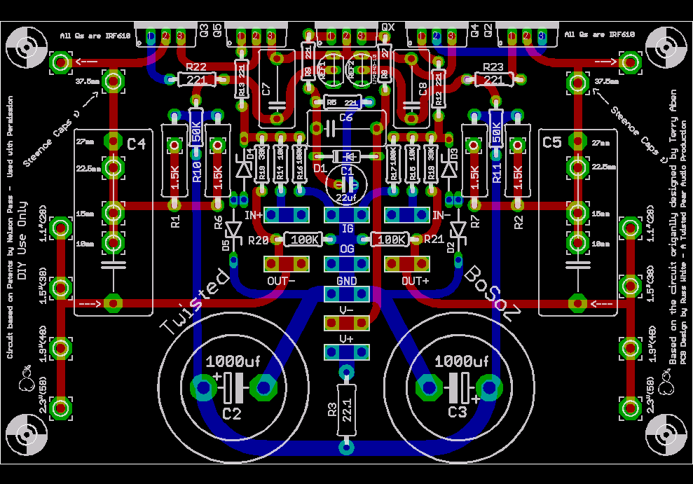

My Take on X-BOSOZ
New layout with bypass caps
Note bypass caps for D1, Ref1 and Ref2:
Cheers!
Russ

Hi Russ,
As I (mostly) watch you responding to all of our requests for tweaking these things, I can't help but imagine you must really love it.
I wonder if the parts density around the Q's could be relaxed through moving them (the Q's) a little further apart? No hurry, wait for other changes to present themselves.
Russ White said:
HI Ed, thats a good thought, and it had crossed my mind, but I am hoping to keep the fets all as close together as possible, as one of the design goals was good thermal coupling, but I may shift things a little, as it is on my print out mockup things really are not that tight.
Excellent Russ, keep those traces the way they are and those FET close. Being a Twisted design traces should have a pear shape to be consistent with its PCB creator.
Those characteristics are what I think is the best layout I’ve seen on the different iterations of this circuit.
Coming to the film bypass for zeners these should be as big as the layout allows, if possible these caps should be polyprop (MKP), maybe the standard WIMA shape will do here if a 0.22u/160V can be fitted that will do the trick. A smaller print conformal type is available from Panasonic that could also be used.
Our standard bypass cap is a Wima .1uF 100V polyester. Ordering those by the 1000 these days.
Russ, for the 3W resistors, perhaps that should be a multi-pad parts as well. I think adding a standard to-220 spacing would allow Caddocks and smaller resistors.
I think it's time for me to post a BOM so we can start discussing the parts for the standard kit. I'll get something up today to use as a starting point.
A beauty of work Russ, thanks.

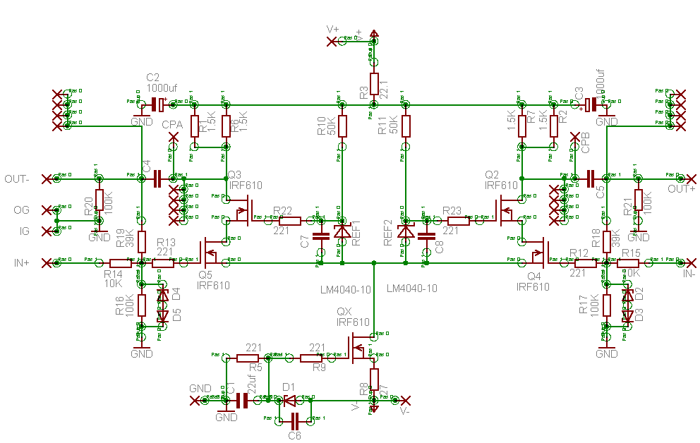

At this point I would like to ask how many of you have actually check the layout against the schematic? This would be a good exercise to clear any bug. The more eyes the better.
I myself have not gone over all of it yet.
