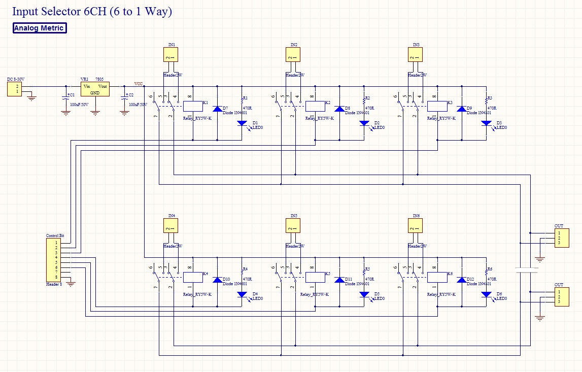

I am to the point that I want to hook up all three channels and I started to install a switch and realized that I am probably going to need some kind of relay setup due to the balanced inputs. Can someone suggest a method for this? I don't want to reinvent the wheel if I don't have to.
Thanks, Terry

take regular stereo relay based selector
say that you want 4 inputs ; that means 4 relays
if you need balanced , then just use one 4 relay board for one channel , taking + and - phases instead of stereo channels
then double it for second channel
Yeah, not sure how to fix the ebay link thing. It it the way this forum deals with links. Other forums I use don't have that problem.

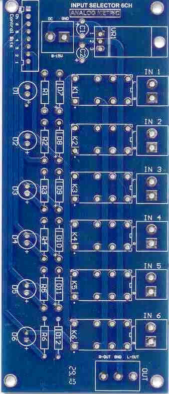

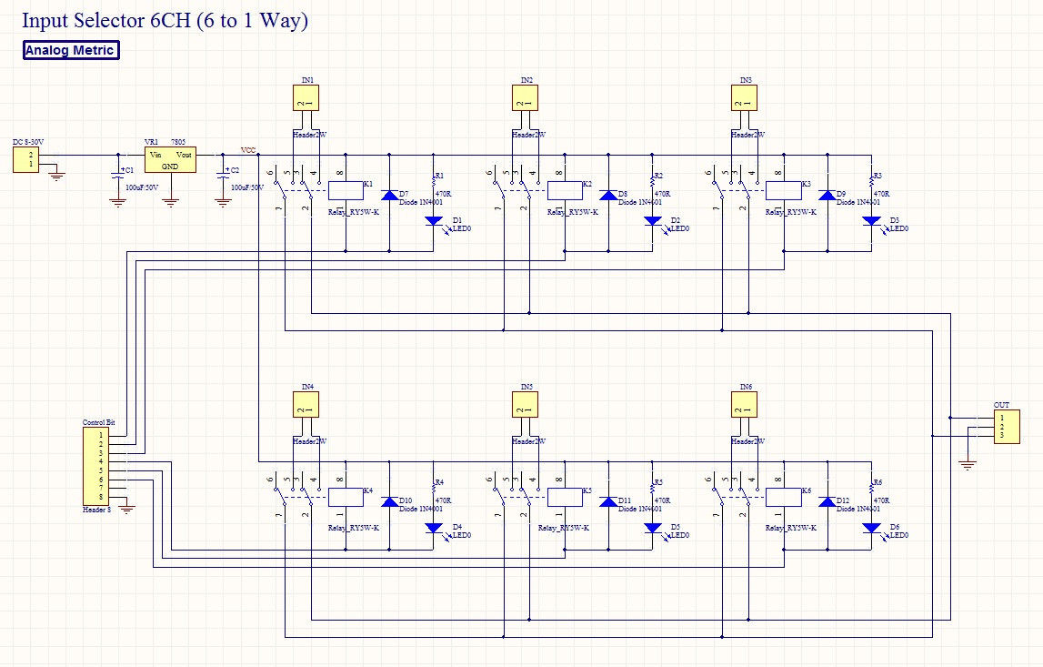

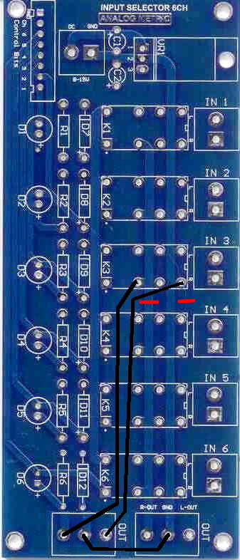

I am attaching a couple pics to show how I would like to do it. I would use channels 1&4 for + & - for channel one, then 2&5 for channel two and 3&6 for channel 3. I only need three channels. I would just couple the power for those pairs.
See any problems with this.
Thanks, Terry

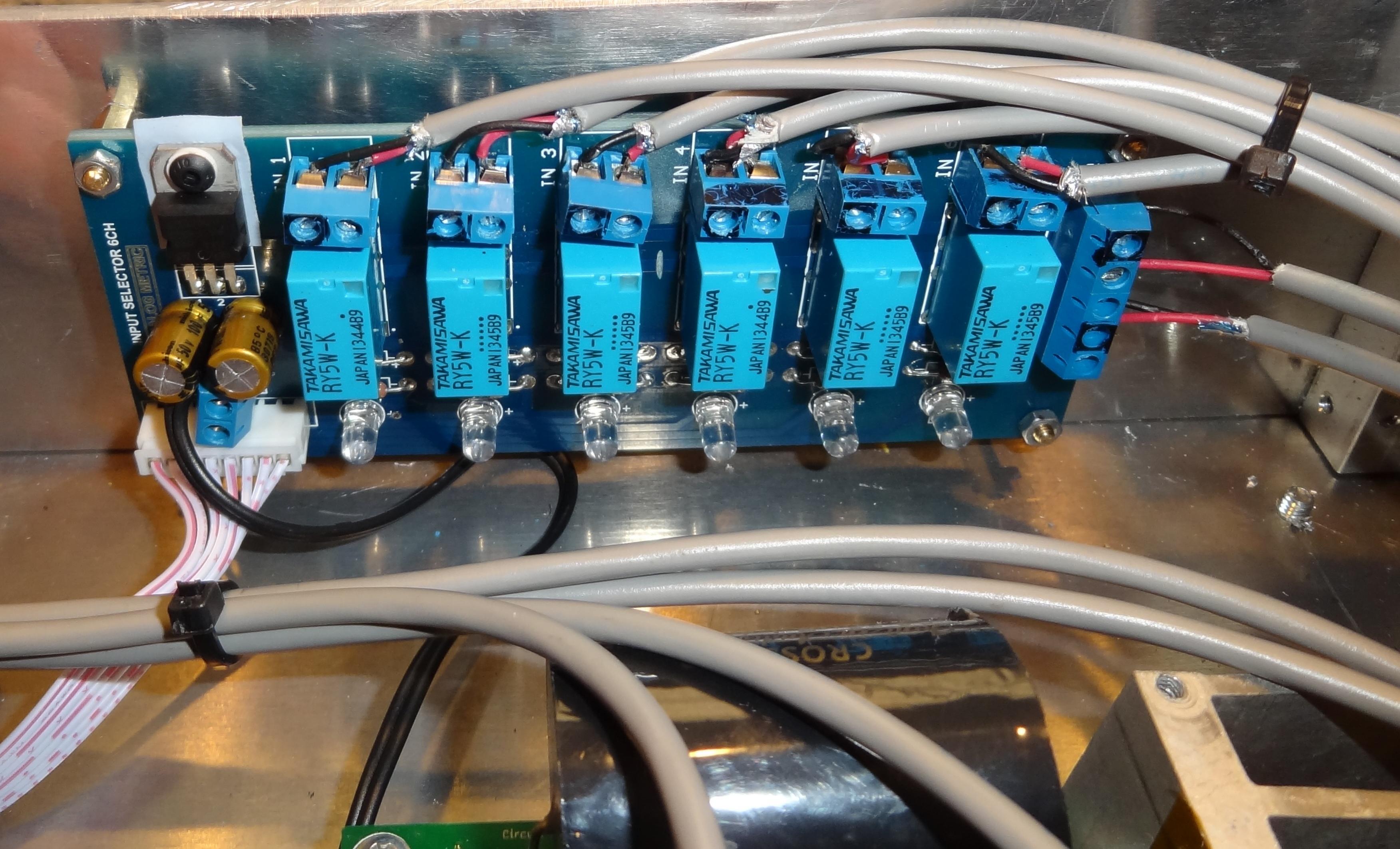

Hi Guy,

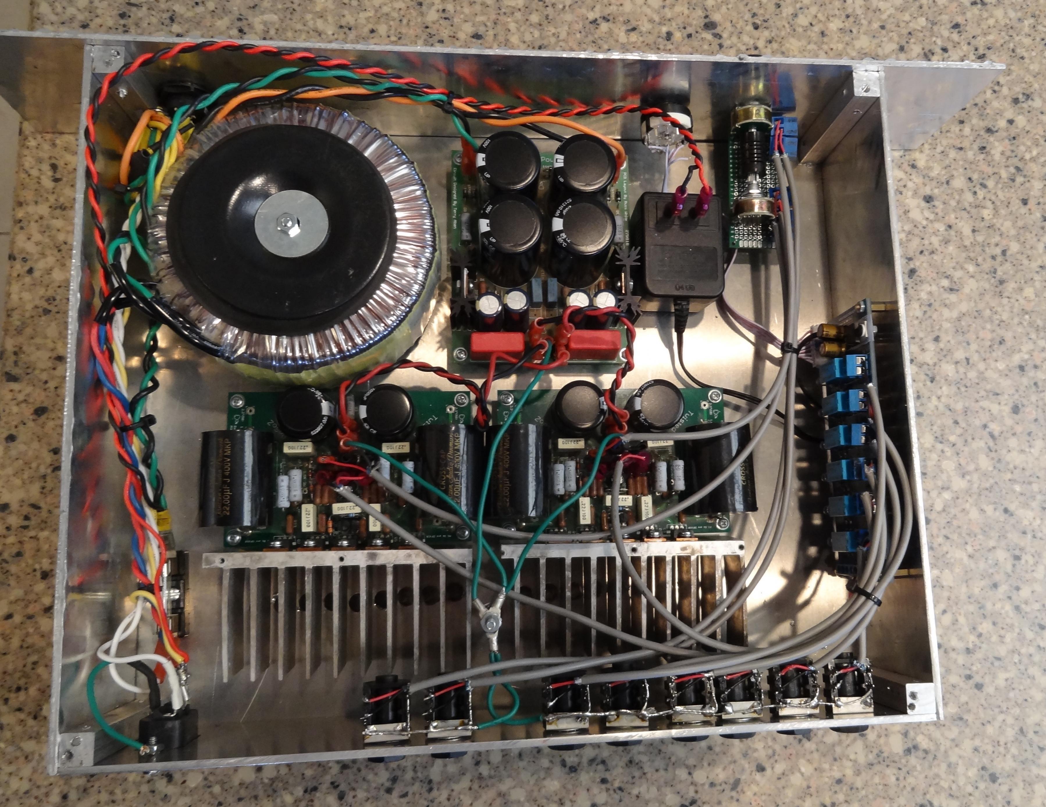

I just want to report in. I bought this kit from ebay and modified it the way I showed above. I found a 12Vdc 100mA wall wart to power it. I just hot glued the wall wart to the bottom of the case. Clean and simple. I now have three balanced stereo input channels. Very simple and clean. I have attached some pics for those who may be interested.
Blessings, Terry

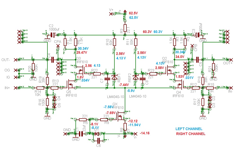

Hi Guys,
I finally got around to swapping that huge transformer for a couple small transformers. While testing it afterwards, I noticed that the right channel had lower output. So I started taking some measurements and the numbers around Qx didn't look right so I replaced it. That didn't help so I am posting a schematic with the voltages for both channels. Please take a look and see if you can see where it is broken.
Thanks, Terry
The left channel sounds better. Right channel sounds whimpy. The left channel has even drain voltages side to side and the right channel they are 4.5V apart. I don't know how to increase cascode voltage and I don't know what source degeneration is.
Thanks, Terry
