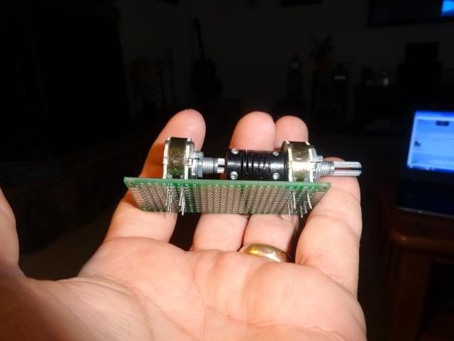

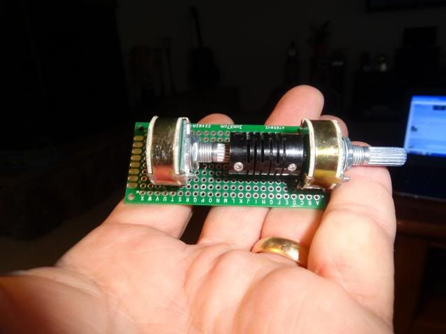

Hi Guys,
I received my attenuator today and it dawned on me that I haven't a clue how to hook it up. Here are a couple pictures of it. They ship it plugged into a nice little patch board which should come in handy.
I plan to hook it up between the boards and the output jacks so any help will be greatly appreciated.
I take it you are attenuating a balanced signal, since theres two stereopots connected. Put the pot on zero and measure between the center pin, which is usually wiper and left or right pin in line with the wiper pin. The one that gives the highest resistance is signal in. Wiper is signal out, the third to ground. I would have used one pot per channel, i e both signal and inverted signal since they are more likely to match. But that you can measure.
Do the same for the other channel on the other pot.
OK, I tested them. If I turn the pots completely clockwise and connect the com wire of the DMM to the center post, I get 000R4 on pin #1. Pin #3 shows 10K08.
Now so I'm clear, I have 3 outputs on each channel. OUT- GND OUT+. Weird, this is the first time I noticed that the inputs are reversed, IN+ GND IN-.
Anyway, The GND out would connect to the two #1 pins of say the front pot and the +/- outs would then connect to the two #2 pins.Then the two #3 pins would feed the XLR? Sound right?

The #2 pin is the wiper, correct? When you turn it counterclockwise it is 0R to pin 3, correct? That's the one that connects to your XLR. Pin #3 connects to your XBOSOZ ground and #1 to the XBOSOZ output (unless you want clockwise to be maximum attenuation.)
I'm sorry Bob, I just read my previous post and I said it wrong. It should have said "counter-clockwise". With the pot all the way counter-clockwise, Pin #1 reads 0R and Pin #3 reads 10K. Full clockwise, pin #1 reads 10K and Pin #3 reads 0R. This is with the other lead connected to pin #2 (center).
BTW, this is a step-attenuator not a pot.
Thanks, Terry
Thanks, Terry
OK, then pin 1 to ground, 3 to XBOSOZ output, pin 2 to XLR. A stepped attenuator should mean better tracking than a couple of random pots.
