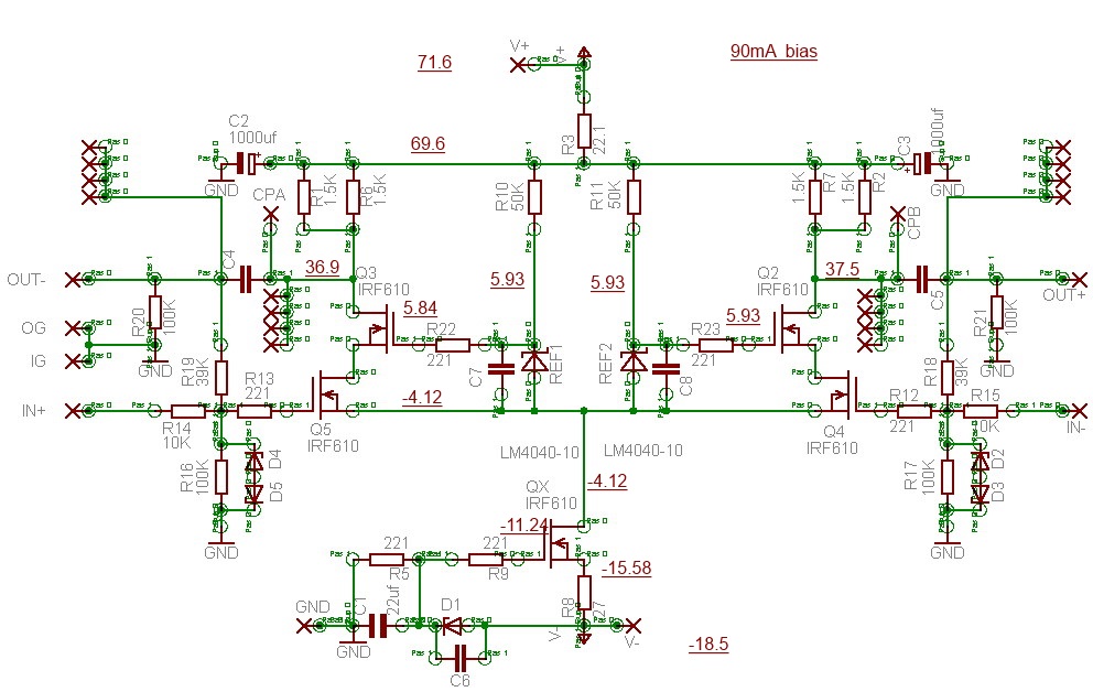

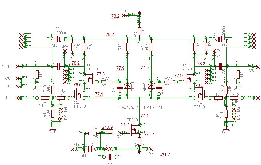

OK, I finished mounting everything. I bolted the outputs to heatsinks. I seem to have one side working and one side not. On the working side I am seeing about 90mA between the PS and the +V on the pre. With a 1.4Vac sine wave on the input I am seeing 1.2Vac on the output. The voltages aren't perfect from side to side but maybe close enough. The PS puts out +78.2, -21.7 with no load. Connected to the working board it is drawn down to +71.6, -18.5
The non-working side hardly drops at all. I am supposing something is not turning on but I don't know. I am attaching the voltages on for each board in hopes someone can look them over and give me an idea where to look.
Thanks, Terry

On the dead side, QX, the current source bottom center is not turning on.

On the working side double check the values of the input and feedback resistors. R14, 15, 18, 19. and the input load resistors, R16 and R17. Are you feeding it a balanced signal or is the unused input grounded?
Slight mismatching of Q4 and Q5 on the good side is causing the drain voltage differential, but it's not a big deal since you are capacatively coupled.

What causes QX to turn on? The device seems to measure OK with a ohm meter.
I am using the power supplies that came with the kit.

Is D1 reversed or shorted? There should be ~9V across it, which provides the Vgs to turn Qx on. Also try reheating the connections on R5.

Looks Like D1 is open. I can't get a reading in either direction with my ohm meter. The closest I had was a 9.1V zener so I tried that in there. It does turn QX on but R1,2,6 &7 get really hot. Of course I am all out of 1N5235's so I guess I had better order some.
That brings up another issue. while disconnecting things, I guess there was some juice left in the caps on one of my power supplies and the + lead touched the ground and took out the IRF610, smoked a few 1N4004'S and one of the 33v zeners. I had the IRF610 and plenty 1N4004's but I don't have any 33V zeners. Can I use two 27V and one 12V to replace the two 33V zeners?

With a 9.1V zener in there you're running around 189 mA instead of the 75 design point, so no wonder the load resistors got hot! If you change R8 to 68R 1/2W or more you'll be back in the 75 mA ballpark with a 9.1V zener. To give you more parts bin options.
To figure current, assume Vgs is 4V. Since R2 is connected to the Source and the rail you can see that there must be 5.1V across it. Then it's just Ohms law to set or find the current.
You can string together a number of whatever zeners you have handy to reach the correct voltage without worry. You can even string together 7 x 9.1V and get close. The rails would be slightly lower if you do that. The actual rail voltage is not critical.
