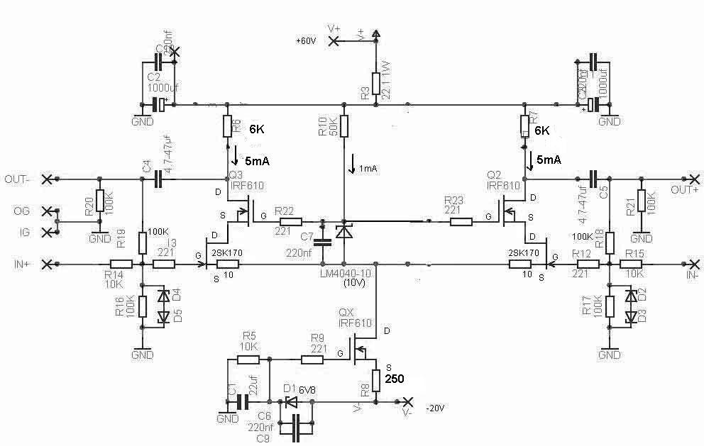

Over this past weekend I did the Zen Mod on my twisted xbosoz 'Jfet cascoded CCS-ed BOSOZ for Steenoe' mod, to my ears the difference in sound is huge, won't bore you with all the audio geek speak stuff but the mod is the dogs. So Zen Mod & Steenoe thanks will have to iron in the BC546 next when will this all end, well until I finish welding up the F4 hopefully this week.
Cheers
Bruce
btw - Bruce - what exact schematic you use ........... I misplaced it somehow .......
Zen Mod,
This one
Cheers
Assesears said:
Zen Mod,
This one
Cheers
presuming that you use BL variant of 2SK170 ......... that's good one :clown:
I think that you can expect further improvement with little BC instead IRFs ;
you didn't must search for BC critters ( I have impression that they are somewhat easier to buy in Europe than in US ) - you can use there any decent little one bjt with similar UIP characteristics .
I use them from same reason Papa use ZTX ......... they dirt cheap , available almiost in every tobacco store and its just fuss buying them in lesser quantity than ,say, 300pcs - even for DIY purposes
later just add output stage :clown: ........ and you don't need F4 at all ........... :devilr:

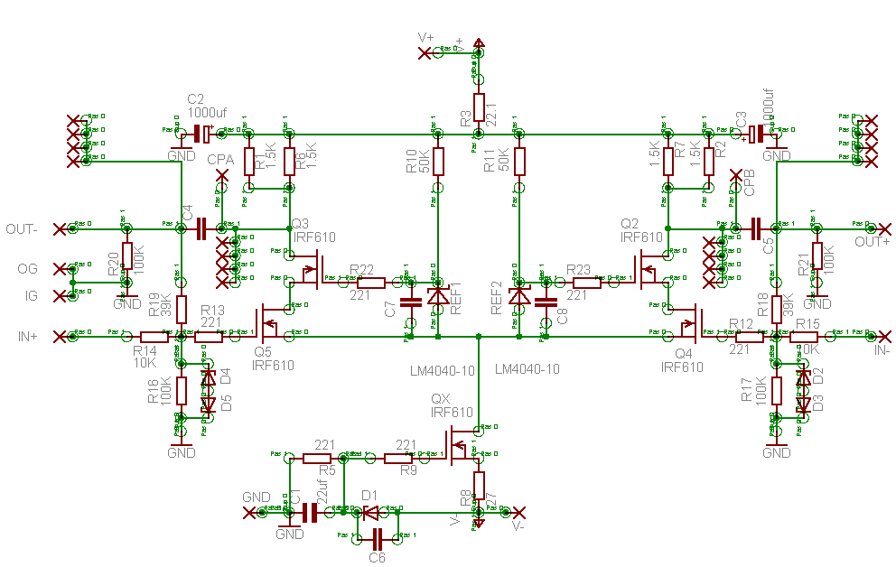

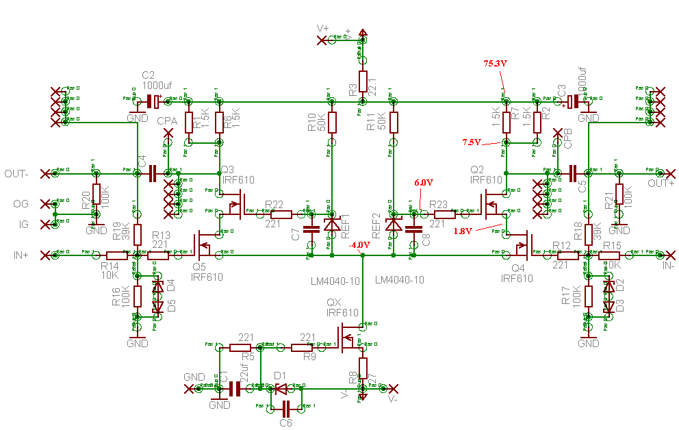

I was wondering if someone can help me with a problem I've run into.
I had built the Twisted Pear BoSoZ, and all worked well. I finally finished the case and in/out selector and controller, but now I have a problem on one of the 2 boards.
Basically, R2 and R7 start burning up, while R1 and R6 stay warm. I measured the voltages at different points, and the odd thing is that I get a much too great voltage drop after R2/R7. I get 75.3V before them, and 7.5V after (as noted on the attached schematic). the 7.5V decreases slowly as time passes. I also took the board out and tried it without having the FETs attached to the case, but I still have the same issue, therefore it doesn't seem like it's a short on the FETs' drains.
I read in other threads, and one of Zen Mod's drawings indicates that I should have a current of about 50mA on that branch, but I get a draw of about 90mA. Can it be that I damaged the FETs (Q2/Q4)?
Paul
