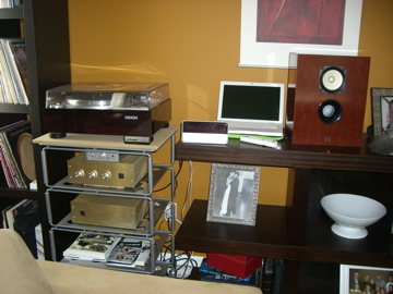

Great Memorial Day
So just wanted to say a big thanks to all you fellas who replied to my noob questions. I have about 10 hours of continuous play, both channels working, everything fixed in place and chassis completed.
In the end I had problems with zeners, mosfets, mica pads and despite my own skills I have a working xbosoz. Again thanks to all you guys who make this hobby/obsession possible!
Re: Great Memorial Day
mmmmmmmm, macbook 😛
Whre did you get the case ? Any more close up pictures ? Inside ?

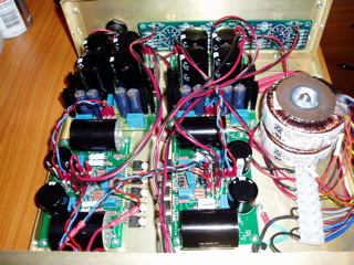

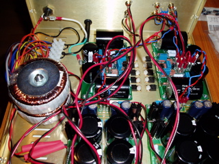

More pictures
Hey jase here are some pictures of the inside. The case is a par-metal 12x10x4. I also used a glassware attenuator, hence the three knobs.
So a couple of "last" questions. Now that I have this thing working how can I be sure I am getting the correct operation. Are there a couple of critical values I should check?
Also the PSU's are getting pretty hot, actually it is mostly the + rail. The transformer is also pretty warm but the fet heatsinks are hot. Does this seem OK?
Pathmark
Re: More pictures
Pathmark
Mine get warm too 🙂 the positive is the highest voltage, it will get warm.

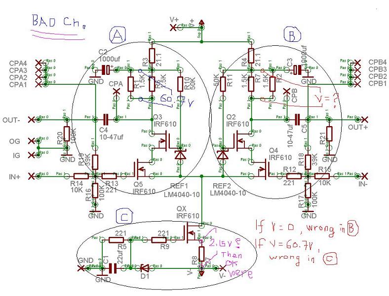

One channel down
Hey guys after doing some cosmetic work on the case one of channels is not working. As compared to the other channel I noticed much higher temp on 3W resistors r1/r6. I have take the following measurements but not sure what to do next.
Good channel
31.3 across r1
31.3 across r6
56.1 across r10
24.7 across r10/r1
24.7 across r10/r6
Bad channel
60.7 across r1
60.7 across r6
54.9 across r10
5.8 across r10/r1
5.8 across r10/r6
Any guidance would be much appreciated?
Pathmark
PM-
Are your component values referring to the PS schematic you posted on the other thread? --nevermind, I see there is no R10 on that schematic.
It was a bit of effort to dig up the other thread to try to find the correct schematic you were referring to--and actually I didn't find it.
Maybe we could talk some nice moderators into moving the posts about your XBOSOZ off of Russ White's thread onto yours. I think you would get more help that way.....
Also, if you post the schematic or at least a clear link to the schematic, I think you will get a lot more replies. I have a bunch of notes from voltage measurements I took on my XBOSOZ, but I can't offer any insight without a schematic for your XBOSOZ.
JJ
In your bad channel,
it apears as 60V across R1 (and R6).
It means 40mA bias thru R1 and thru R6--total 80mA.
Measure the voltage across R2 (or R7) on the other side, too.
If the measured is 60V, then, something wrong in CCS.
If the measured is 0V, then something wrong on this side.
To know whether CCS works correct,
measure voltage across the source resistor.
If the measued is appearing about 2.15V, then CCS
is working correct.
Good luck!

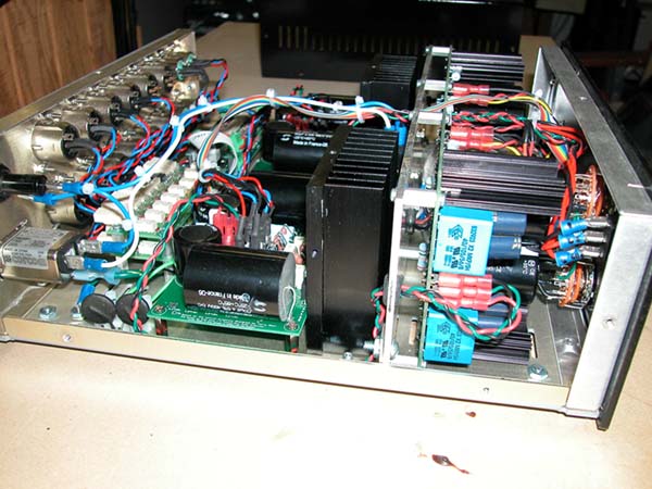

Well I had to practice getting 29 tomato's in a can before I stuffed my case, but I made it fit. Interestingly I thought I had blown fets on one channel. I had continuity from fet tabs to case. But when left idle for a wile and caps discharged they became open again. I was very careful with ESD protection and double checking and tested each section as Terry had outlined and was rewarded with a working unit. All my Pass projects the last thing I do before final assembly is install the fets. Russ, Brian looking forward to new controller.
Bill
Bill
Yup, that is a good definition of getting stuffed 😛
How long it take to get it all in there ?
