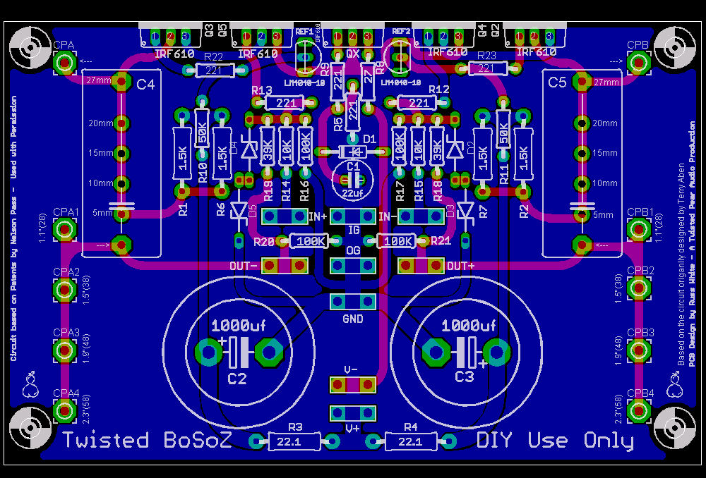

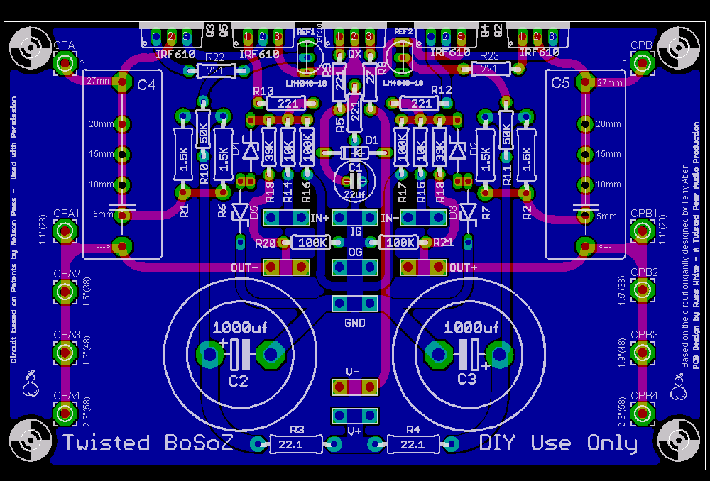

I had a closer look to the layout this morning and if you don’t mind I would like to point a couple of small things I would do different:

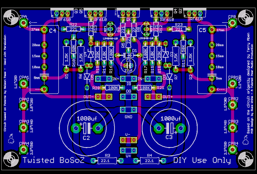

R12/13 should finish as close as possible to the gates of the FET. I think is doable if you have those resistors in an upright position and moving the red traces a bit downwards.
You have fastons on the input signal and both pins seem to connect to the input. In my opinion one should be ground to properly terminate the ground input to the pcb. I myself will not use the faston connector for the input but of course that’s optional.
I guess that more important that a ground plane is to have a correct star grounding for the input.
I might have some other suggestions but that will take me a while to look over the schematic and layout.

Thanks,
I will see about R12/R13, thanks for the note.
As far as the fastons, they are terminated properly because the single faston connectors have two legs which fit in the pair of mounting holes. So one faston pin = two holes. The hole spaceing is .2" so if you wanted you could probably find terminal blocks that fit. Also the pads for the pairs of faston holes for each faston make excellent wire pads for direct wiring.
So, there are 3 input fastons (IG, In-,In+) and 3 output fastons (OG, Out+, Out-)
Notice I kept the star grounding even when adding the ground plane. The GND plane is purely there as an RF shield. I personally don't think it necessary, but it should not hurt, and I figure some folks will like it. I like to provide clear equal conduits back to the power ground.

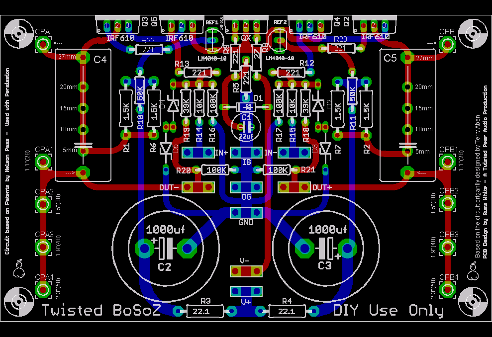

jleaman said:What color are you going to do the boards ?
Green. Its sort of a twisted pear tradition. Simple roots.
Though I hardly know why it matters. 😉

Black with white letters OR gold like Peter d's 😀

I got that on a second look to the layout. In any case I would suggest only two double fastons, each one with the signal and ground since it will be easier when using a coaxial cable to carry the signal and for those using it single ended.
Regarding GP I would prefer sans, but let’s see what others have to say about it.

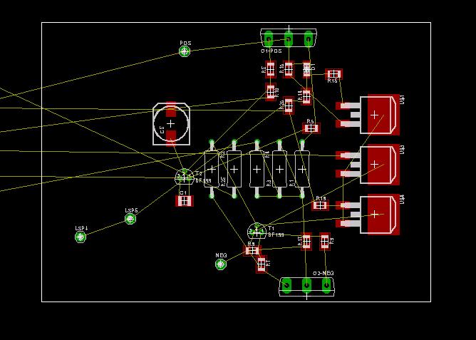

Russ, what is the dimensions of this board ?
I'm trying to work on my SMD version of the aleph mini's 😀
I think i shal be asking you to look over my boards to see your suggestions and idea's 😀
Russ White said:New layout, symmetry not as good now though. 🙂
Re: Re: Moved R12/R13
4.6" x 3" roughly
jleaman said:Russ, what is the dimensions of this board ?
4.6" x 3" roughly
