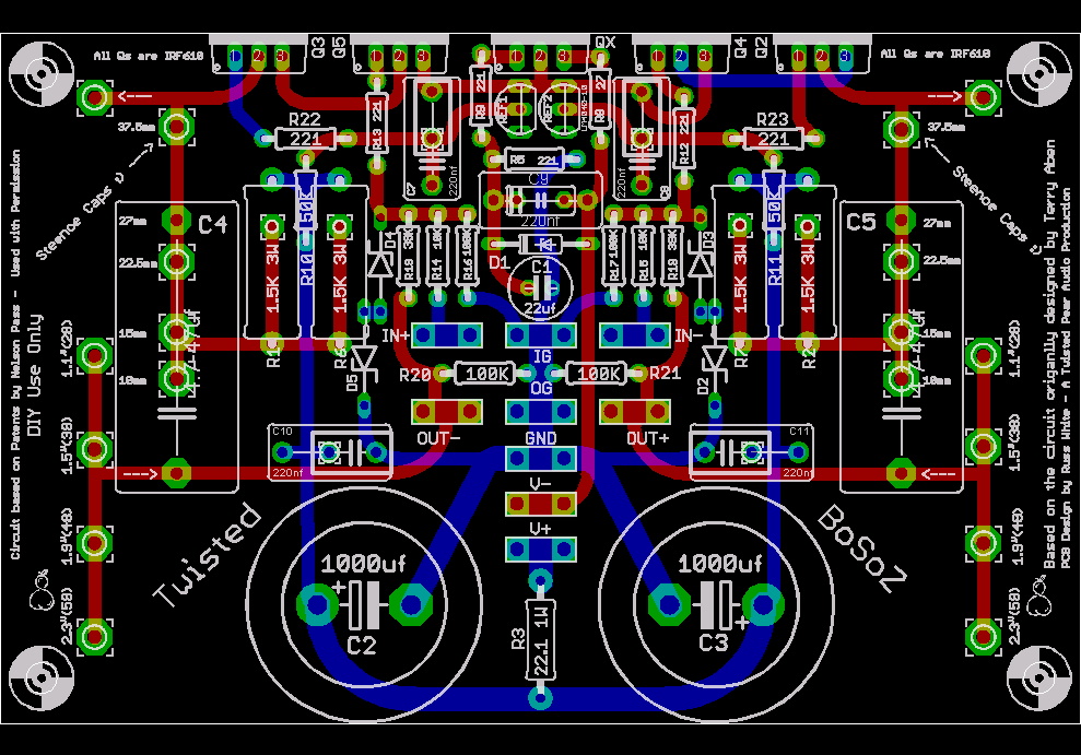

22uf cap
I'm curious about the voltage rating necessary for the 22uf cap on the main board (this thread or Kari's thread). BTW, I did receive my boards (some time ago). The "BOM" did not give the rating for this cap.

25V would work for the PS I will make, but I will probably use 50V as it will fit fine.
You would use a capacitor to suite your negative rail voltage.

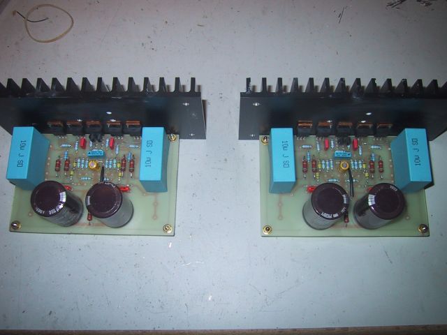

I made a proto of this design. Etched a couple of the Twisted BosoZ boards and build it😉 I dont like to admit this, but it sounds a bit better than BosoZ with singleended input/singleended output 🙂 With singleended in/balanced out, it sounds a good bit better😎 The sound is overall more tight. For those interested I matched two sets of IRF610's (2x5 pcs) to 0,01V Vgs. I am not sure its necessary to match all the fets, but I just had those two sets from 18 fets straight from the tube. Otherwise I just used fairly cheap parts for the rest of the circuit. As good as this preamp sounds, I will surely build another with better parts😎 The preamp is very quiet, there is no noise and the Mossfet hiss is very faint indeed. I have to turn the volume all the way up to hear it, even then it is at low levels. At this time its running from a very basic BosoZ supply, set up for +60/-20 volts. With a better dual mono supply, it will do even better. So I guess the circuit is working (no surprise) and the boardlayout is correct😎 I hope to finish the Twisted's supply boards next week, just to see if it works as good as the preamp itself😎 Here is a pic of the proto boards🙂 Hopefully the set of boards will be flawless. Its a bit sad with corrections added later on. Dont you think?

If you only have SE input and no poweramp with balanced input, the advantage wouldnt be so great. Still I think this circuit sounds better with SE all the way🙂 Its just that bit better than the BosoZ, so I think its worthwhile to build it.Would be nonsense using the Twisted Bosoz SE all way through?

Thats a tough one, JC😀 I would say it depends a bit on your poweramp. 1)If you have a poweramp with SE input that demands a powerfull input, like the Zen's, just keep your BoZ. I have a BoZ myself, and it is very musical🙂 The BosoZ is a bit better sounding, but if you use only the half"outputswing" with the -side connected to ground its not as dynamic as the BoZ!I´m asking that because I have a BOZ preamp in my system and I wonder if would be any advantage upgrading with SE Twisted or perhaps with the NS10. Your advise is very appreciated.
2) If you have a poweramp with normal sensitivity and only SE input, my guess is that the X-CCS-BosoZ sounds that tad better
🙂 Best way to find out is to build them all😀 The NS10, great sounding as it is, is not the best match for a Zenamp. It is a great match for "normal" poweramp. Hope this helps! But as I said, its a difficult question. I took the long road, and built them all🙂 I think the twisted BosoZ will end up in my system, though.
Steen😎
Steen thanks so much for building the prototype. You did excellent work, and got it done so fast! 🙂
I really appreciate the validation of the layout and the little tweaks you made me aware of. 😉
The "Steenoe Caps" are there to stay in honor of your contribution to the design. 🙂
So now I feel very condifent in the Pre and I will be ordering the PCBs post haste.

steenoe said:The preamp is very quiet, there is no noise and the Mossfet hiss is very faint indeed. I have to turn the volume all the way up to hear it, even then it is at low levels. At this time its running from a very basic BosoZ supply, set up for +60/-20 volts. With a better dual mono supply, it will do even better. So I guess the circuit is working (no surprise) and the boardlayout is correct😎
Steen😎
Hey Steen, as we have been accustomed, coming from you, just beautifully twisted.😎
Excellent work🙂 🙂 🙂
Thanks a lot Russ, I just love this stuff you know😀 You made a great preamp😉The "Steenoe Caps" are there to stay in honor of your contribution to the design.
Tony, now you know why I didnt finish the F2 yet😀 I will in short time though, I excpect to receive more sturdy source resistors tomorrow🙂 The work wasnt that excellent after all, I just plugged the thing in and sweet music flowed😉 😉 😉 Well more or less at least🙂 🙂Hey Steen, as we have been accustomed, coming from you, just beautifully twisted.
