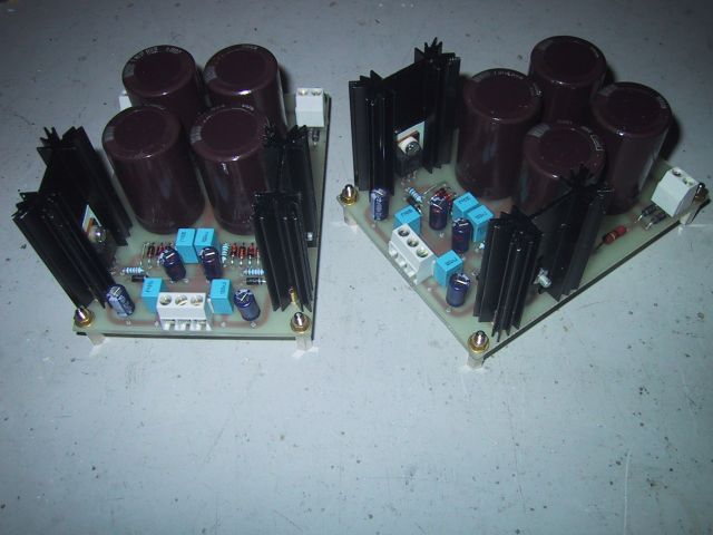

I couldnt resist, building two of the Twisted supplies🙂 I was a bit curious about how the preamp would sound with the right supply.
In one word, marvellous😎 Its a very, very pleasant sound, this preamp delivers. Ofcourse I didnt listen to it for very long yet, but the immediate impression is absolutely positive😎 The gain is not quite as much as in my standard BosoZ, but it drives the poweramp to full output without trouble. I blame the lesser gain on the cascoding, not sure though? This has more or less been a "plug it in and play" excperience🙂 It all just worked, right away. I made 2 supplies and hooked them up in dualmono config.
Overall tonal balance is quite good and the soundstage is also very good🙂 I am a bit puzzled that this preamp is so quiet. I wasn't excactly taking care with leads and layout, but its deadquiet🙂 I just used the parts I had, generally the electrolytics in the supplies are smaller than suggested. I can hear no ill effect from that😉 I gather it has something to do with a good layout of the boards, together with some other things.
Well, I am off to listen to a couple of cd's😀
Steen🙂

Just a few more practical observations. The preamp has been running for about 3 hours. The top is warm, not hot, but a good handwarm😉 There is ventholes at the rear of the lid, and the heatsinks I use are rated 2 c/w. I recommend to use a chassis with ventholes and fairly big sinks. You might be able to use sinks a bit smaller than mine though. See picture a little longer back in the thread.
Best of all, the music still sounds tremendously good🙂
Steen🙂

I was thinking about stocking 1.5" pieces of this heatsink. That should be about 3C/W. Could go to 2" if needed, but I doubt it. I have some of this on hand, so I can try out a 1.5" piece to see how it goes.
Incidently, the base of these is nice and thick, so it's easy to drill/tap into it for use as case edge, that way it can protrude outside the case.
Brian, I think those would do a great job🙂 Its a good idea to use the sinks as the sides of the chassis. The 2 boards including heatsinks, takes up a lot of space. Think about it: 2 trafos, 2 psuboards, 2 preampboards with heatsinks, volumecontrol with 4 decks and inputselctor. the chassis is pretty quickly crowded. Your suggestion would help making a nice layout of the inside.
Steen😎

When I built mine, I used an all aluminum chassis from Lansing Enclosures, one standard rack width by two rack heigt by 12" depth, and mounted all the FET's to the bottom panel of the chassis. I did mine with a dual mono supply, and there is little to no room left in the chassis by the time all the connectors, switches, circuit boards etc... were in place. The chassis makes a great heat sink, and even with poor ventillation, it never get more than warm to the touch.
Brian, a 1.5" section of those sinks should work marvelously. Nice find!
Terry
