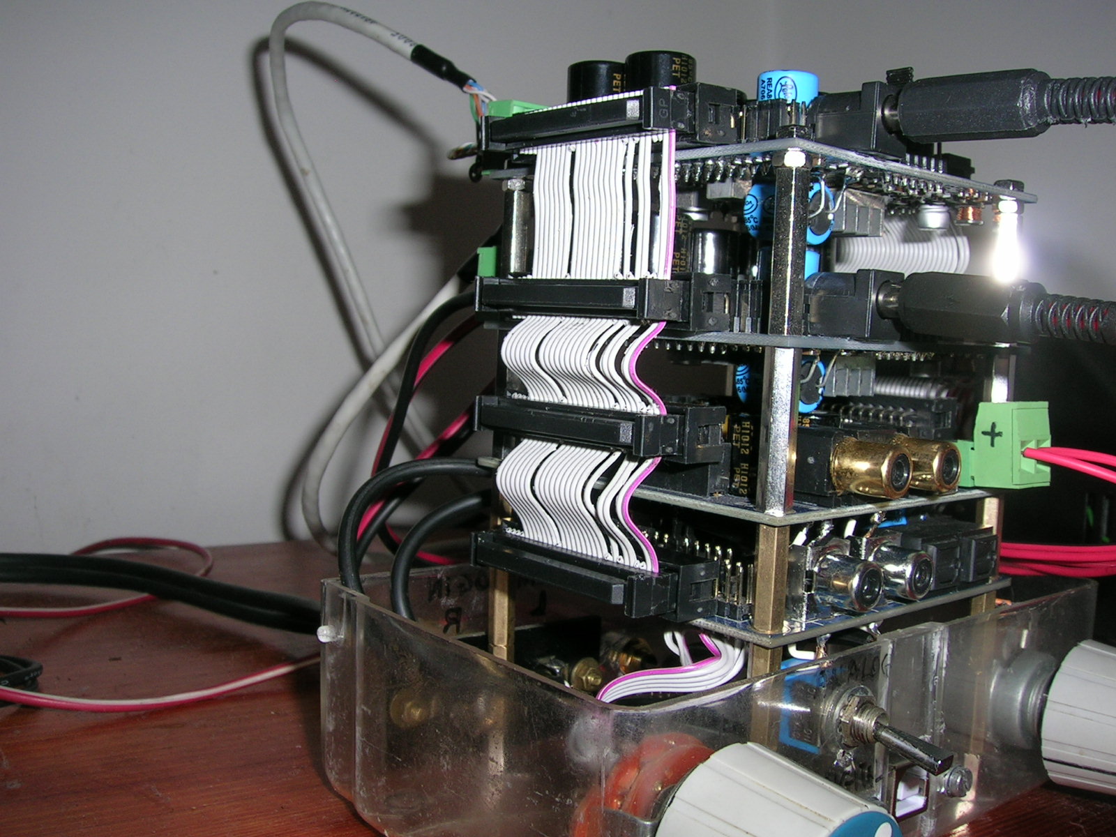

The stack is up to now in it’s most simple arrangement, that is, connected and set-up just for achieving proper functionality.
That I play my stack at a volume level that does not stress the 3.5A psu I use now, does not mean that I will leave it to that for too long.
I have made a listening session with a 10A smps psu in place of the 3.5A analog psu and the bass sensation was quite different even on medium volume settings.
The plan from the start is to power each module individually and there are a few options here.
I have e-mailed some questions to minidsp devteam for to clarify a few details in order to narrow down my decisions on how to implement this.
Now that ambient temperatures over here are declining again, I will start working with the -ever important- psu issue. 🙂
I will report on the progress.

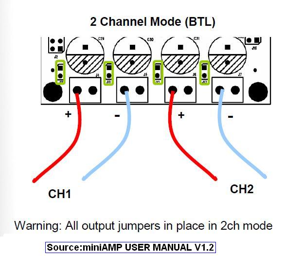

The speakers wiring is OK (in phase). I attach the relevant drawing from the miniAMP user manual.
I have noticed that a mistake on speaker wiring connection or a mistake on these output jumpers, may increase the current draw on the board (in addition to no signal output)

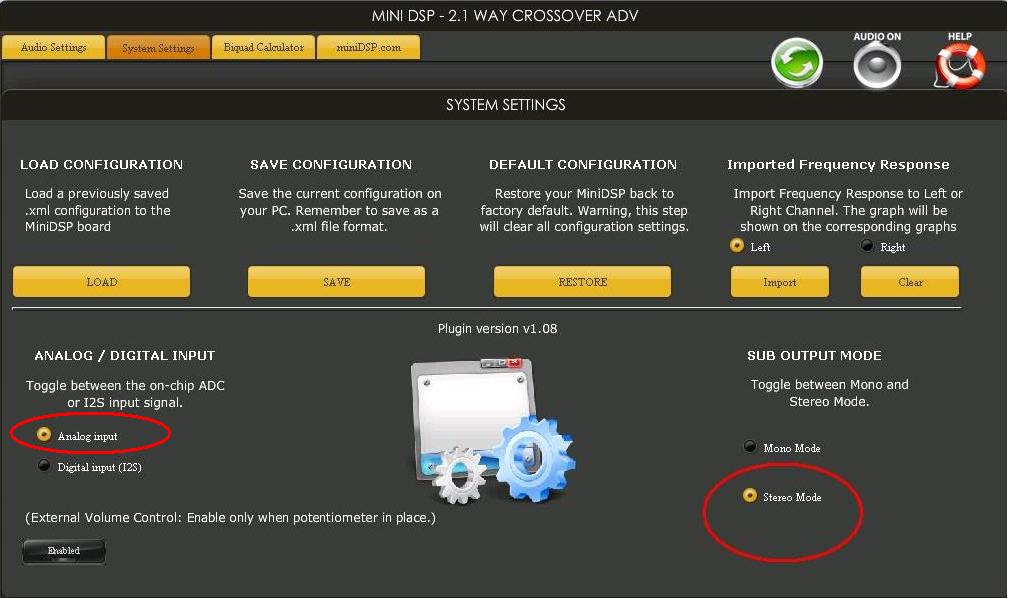

Let’s start with the miniDSP boards of each stack first and clear the possible issues there.
Remove the ribbon wires and any DC power from the miniAMP boards.
Make sure that the M/S jumper on the miniDSP boards is in the Master position.
Connect your analog signal source to IN1,IN2 of your first miniDSP board. Left analog channel to IN1 and Right analog channel to IN2
On the pc, open the 2.1 plug-in program.
Make sure that “Analog Input” and “Stereo Mode” are selected as shown in first attachment
Connect the miniDSP board with the pc through the usb cable and synchronise.
Then monitor the Input RMS meters while your signal source plays some music.
Do you have signal on both INPUT CHANNEL 1 and INPUT CHANNEL 2 meters? You should.
If not, check the source, the interconnect cable and the Input attenuators plus the Input Mute switches of the plug-in.
Then after confirming you have signal on both input meters, look at the RMS meters of the four outputs. You should have signal on all of them.
If not, check the Output attenuators and the Output Mute switches on the plug-in as well as check for any silly setting of the cross-overs or equalizers.
When you have signal on all four output meters, stop and enjoy a beer.
Repeat the same procedure with the second miniDSP board.
Report the results here.

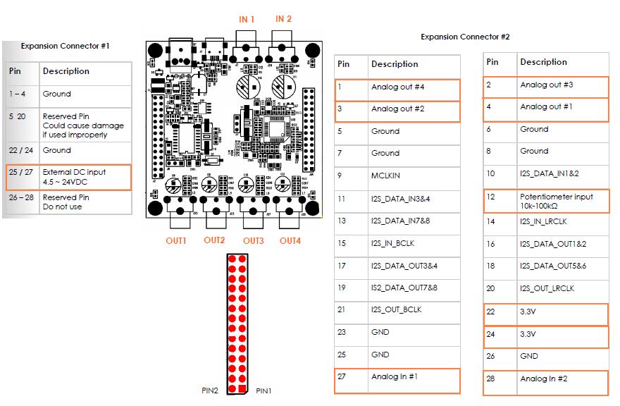

After you’ll finish with both miniDSP boards, have a look on the second attachment.

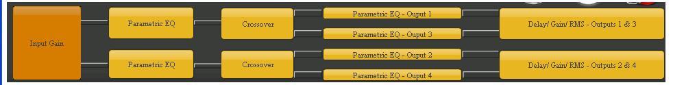

This will help to remember that with the 2.1 plug-in:
Output#1 and Output#3 are connected to Input#1
Output#2 and Output#4 are connected to Input#2
Think of it and we will communicate again tomorrow.

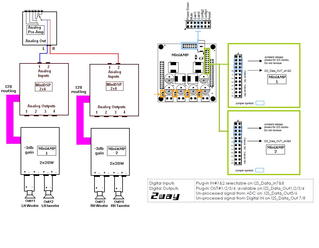

Ok, I have output on all. At this point maybe I have been trying to do the impossible. My intent is to run a single coax to a single input and output 2 channels which are divided in frequency by the plug-in crossover. One running the tweeter, and one the woofer. So following your guidance, I see all inputs activate all outputs, but only one output channel is connected electronically to it's speaker, even though both output meters for 1 and 3 show signal.
Hi Jack
As you understand, what you want to do can’t be done with the miniAMP in combination with the 2.1 plug-in . This is the bad news.
The good news is that it can be done with the 2 way plug-in.
I made a schematic drawing which describes in detail how to do the connections and where to place the jumpers.
The proposed solution works as is with both analog and digital sources
Cheer-up
George

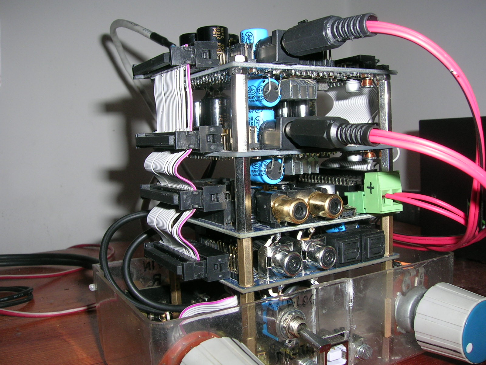

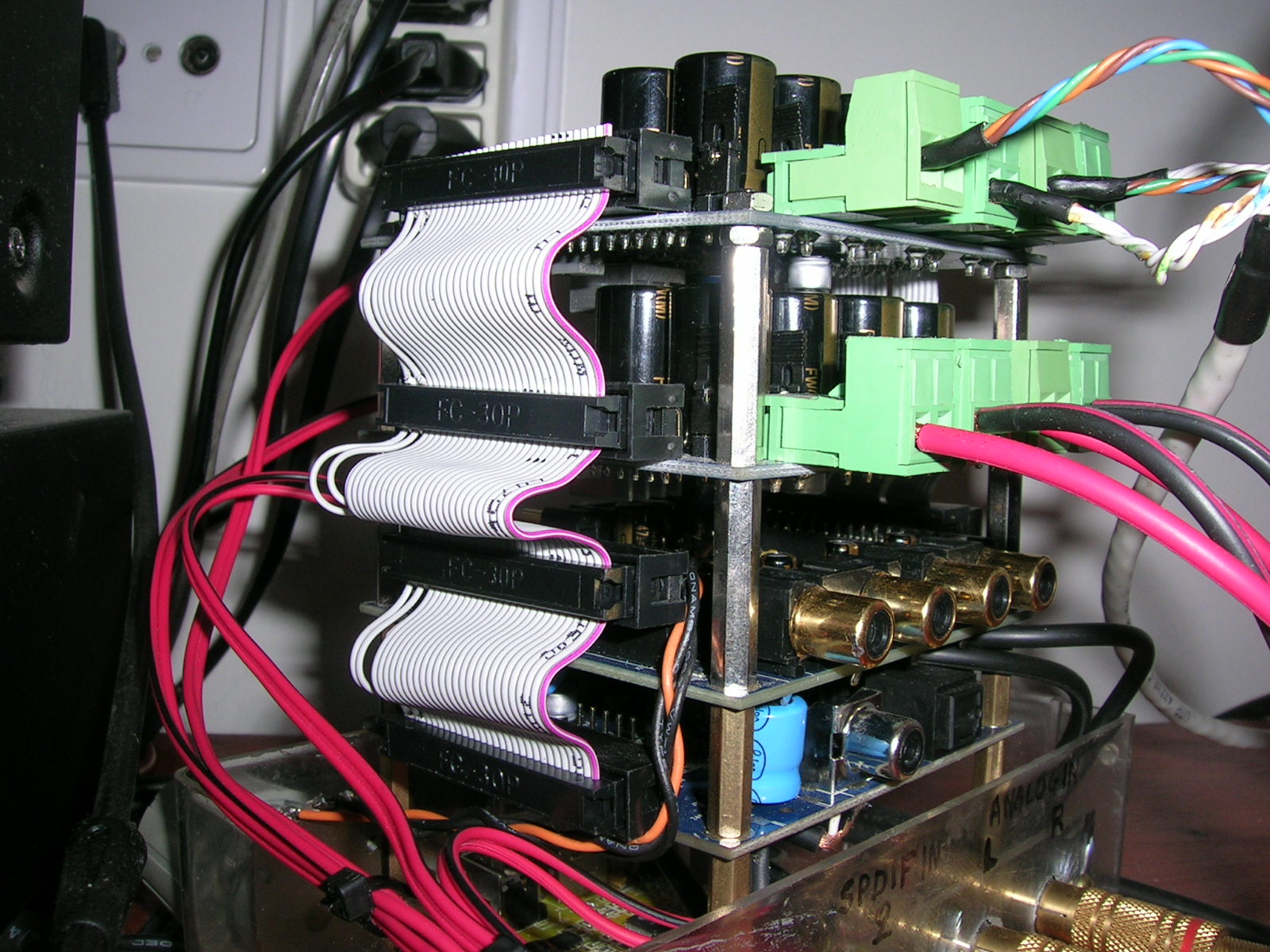

Today I made the first steps toward better DC powering arrangement on my stack.
A. I added electrolytics at the DC Input of each board (2x100uF63V on each miniAMP, 1x100uf/63v on MiniDSP, 1x100uf/63v on MiniDIGI.
B. The DC Input of each board is routed to the (still common) psu through separate wiring.
C. I cut the ribbon wires that connect pins 27,28 “External DC input
4.5 ~ 24VDC” of Expansion Connectors #1
D. I cut the ribbon wires that connect pins 22,24 “3.3V” of Expansion Connectors #2
These wires were cut for to isolate the power supply sections of the boards.
As I was on wire cutting, I also removed ribbon wires that connect pins 1,2,3,4,15,27,28 of Expansion Connector #2
Although all these were done in one go, in the end boards worked as they should with no fatalities 😀
There is still absence of turn-on/turn-off thumbs.
First listening impression is that the bass is less pronounced and more controlled.
After further listening, I think that music is more clear now (better defined) on all frequencies.
George

Paul
As long as I don’t provide measurements, whatever my answer is, it will be an assumption or a wishful thinking 😀
Anyway, the rationale is the caps to function as local power banks (ripple reduction) on miniDSP and miniDIGI and on miniAmp as noise filter caps, for to reduce ringing and spikes at the psu-amp dc wiring caused due to wiring inductance reaction to current flow di/dt.
Capacitors is an interim step which may be of no use if individual PSUs are built and placed near the boards.
George
