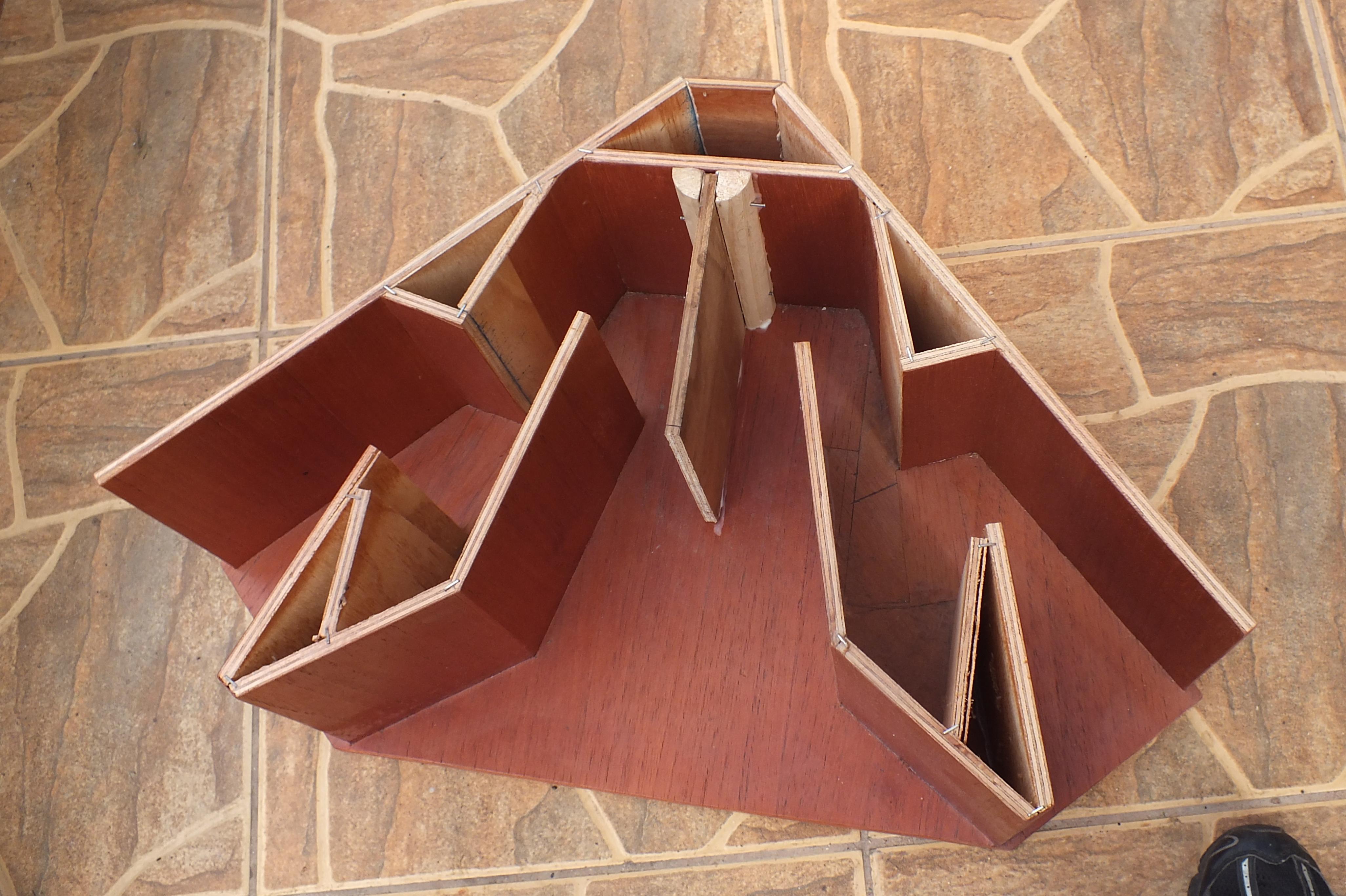

Hi again,
My 2:3 reduced Tannoy Autograph speakers with AN super10 are placed on my bedroom, connected to RevC myreference amp. There I felt the bass was a bit lacking, so I designed a base, a "basement" to increase bass response. I made two vents on the base wich prolong to the "basement" the front-to-back parallel lateral foldings of the enclosure:
http://picasaweb.google.com/maxlorenz24/DIY/photo#5165544981065273714
This picture is of an almost finished base. Note that I never finish aesthetically my projects! Lazy, lazy me...
Effects:
Evident increase in bass reach to the point where I don't miss it. Sound is even more full bodied.
The 20cm base takes the driver up at ear level now ...around 1m. I haven't measured it yet.
See that the mouth has increased notably; from memory 60x20 cm = 1200cm2. More importantly, now I figure out a way to make the bass horn like a "coaxial" output, just reproducing or spliting the horn to an upper and a lower arm...ta-taann!

This is a rapid drawing of the "base":
http://picasaweb.google.com/maxlorenz24/DIY/photo#5167413287544066434
The green area represents the vents made on the original Autograph "floor", at each front-to back lateral folding and allows communication with the inferior labyrinth, represented here by the orange lines. Note that they split into lateral and medial paths.
The added mouth area makes for a total mouth area of, roughly, 3.4sqfeet, good for around 60Hz (!?) only, but it does sound very good anyway...

Hi Régine and AndrewT,
Yes Andrew, on the first drawing it acts as a mouth extender that makes the horn length just a little longer...it was a quick fix but it worked.
I'm sorry it is difficult to imagine (and draw), imagine the vents I practiced on the enclosure's "floor" as two stairways to the "basement".
The second drawing is like having two rear horn from the Autograph mirroring (split) up and down, like a "Chang" but with both, lateral and upper/lower mouth openings!
No, Régine, it is not difficult to make. It is just difficult to calculate the proper expansion and lengths/areas to get it technically correct.
Once one start building these things one develops a certain feeling about what will sound good (apart spatial recognition areas in brain getting more robust )

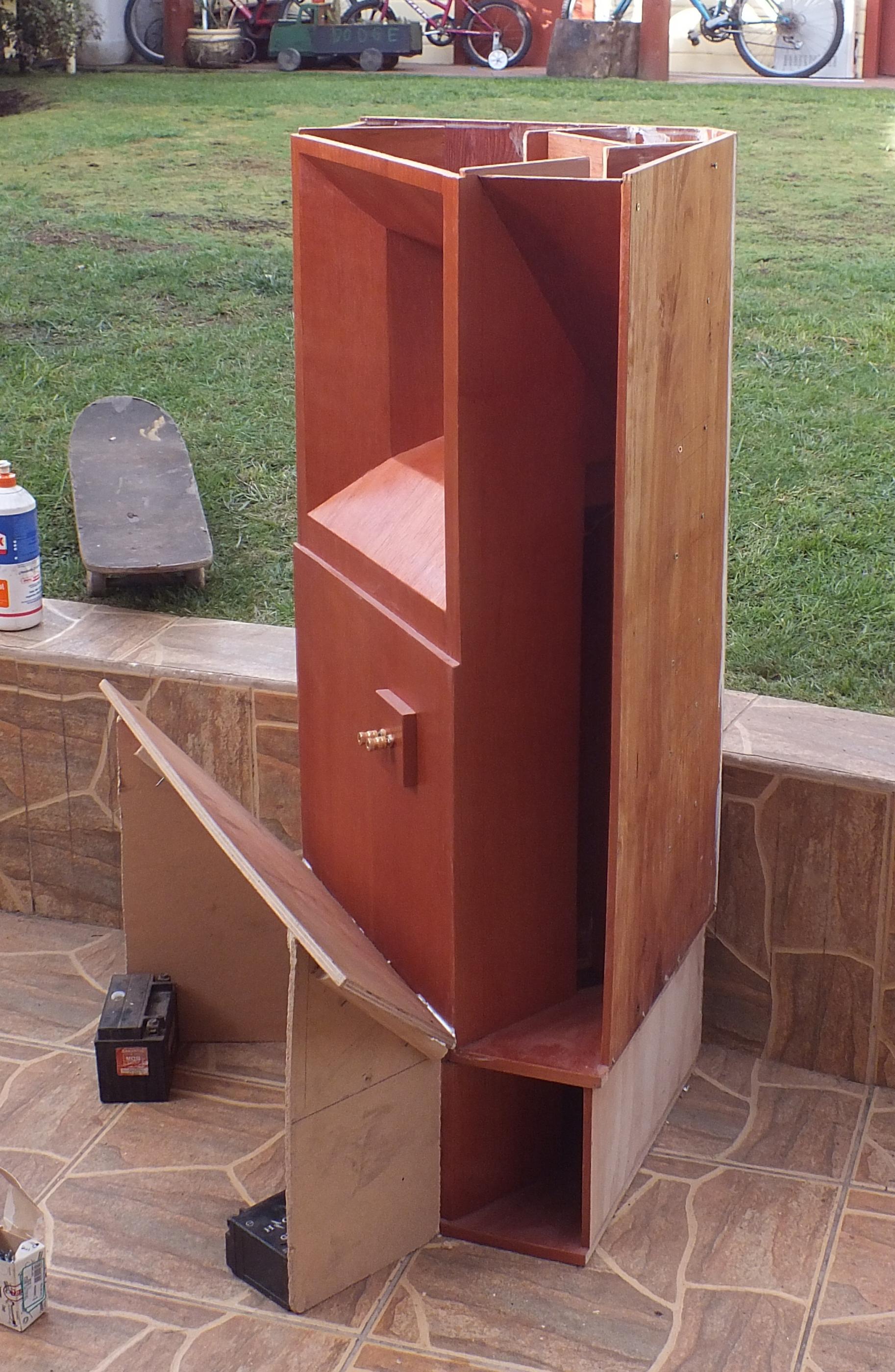

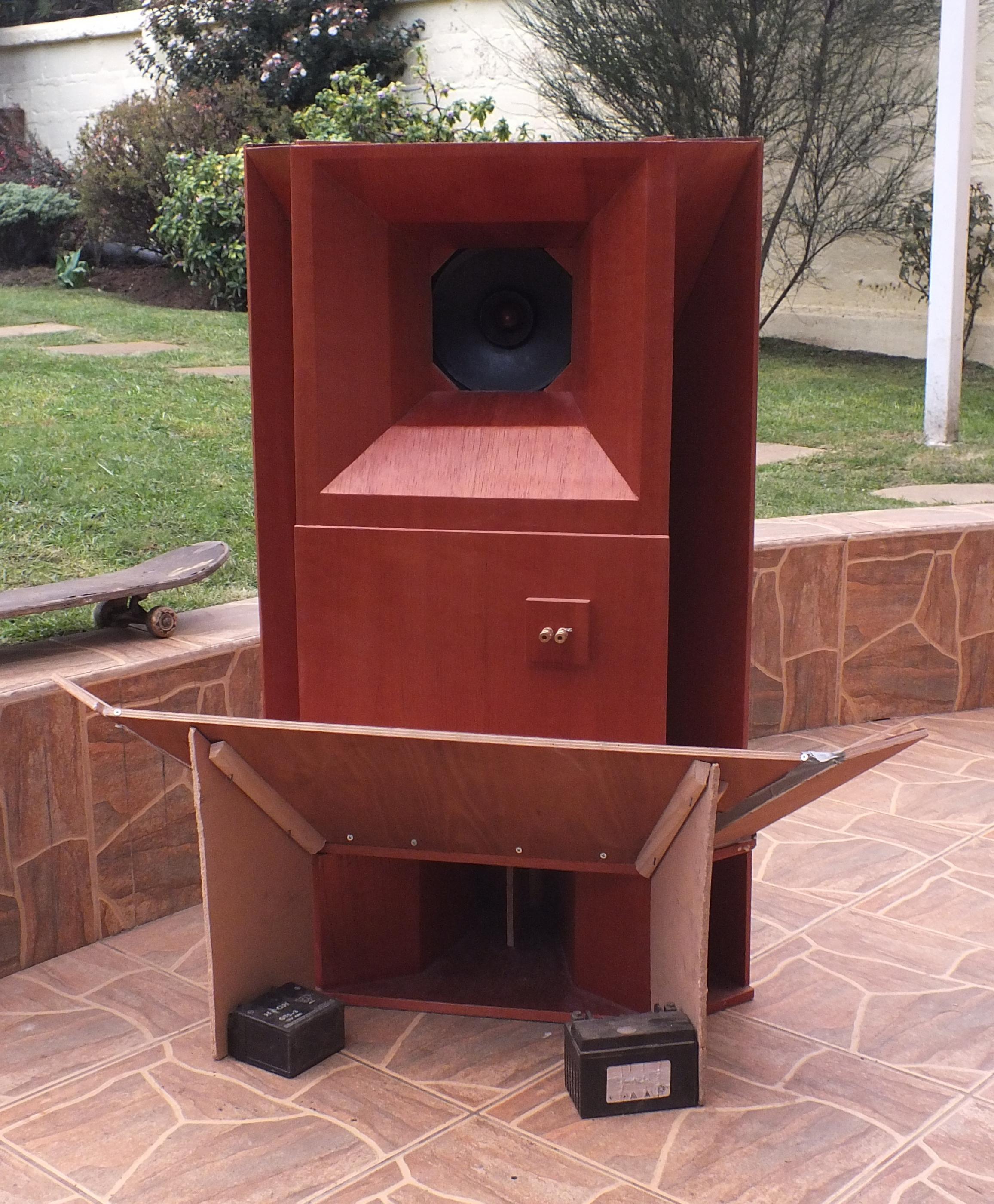

Update: I expanded the bass horn. Not pretty but works.
First the base to expand the height, then build a simple horn mouth. The corner walls complete de side of the horn:

Hi.
Ugly but good sounding.
The mouth area was 17*2*92cm before modding = 3128cm2
I added 44*89 + 44*36: 3916 cm2 + 1584cm2 = 5500cm2 of three boundaries loading.
Total = 8628cm2 or 0.85m2
Horn length increased about 60cm for the final section.
I have to get my paper for equivalent cuttoff frequency as I am too lazy to derive it from Andrew's formulae
The speakers seam "more powerful" (or more efficient) as now they have proper midbass and bass, so it can reproduce better bass armonics, and with good transient speed. Bass delay is undetectable.
