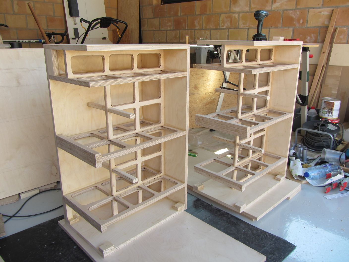

The inside of my cabinet has the following characteristics:
- cabinet dimensions according to golden ratio and positioning the driver cutout not in the middle of everything (even 1-2mm horizontal offset). Boxnotes is very helpful.
- backside is irregular to avoid reflections
- damping : 1cm felt glued to the walls and the inside filled with Twaron angel hair: very good damping material, recommended!
- Aperiodic vent, just sounds better than sealed for this mid.

Forgot to mention that mine are about 3.5 liter after installation of the driver, the large magnets take almost 1 liter.what is the volume for the C173-6-090 Accuton mids?
Excellent, just what I needed to know. Yeah these magnets must be seen to be believed, biggest chunk of Neo I've ever seen 😀 Thanks!
Thank you! I am having trouble finding aperiodic membranes. Where did you find yours?
I've made mine myself: the aperiodic vent is a PVC tube of 4x10cm filled with less than 1 gram of Twaron angel hair.
Those scanspeak variovents are too large, they are more made for bass drivers in larger cabinets.

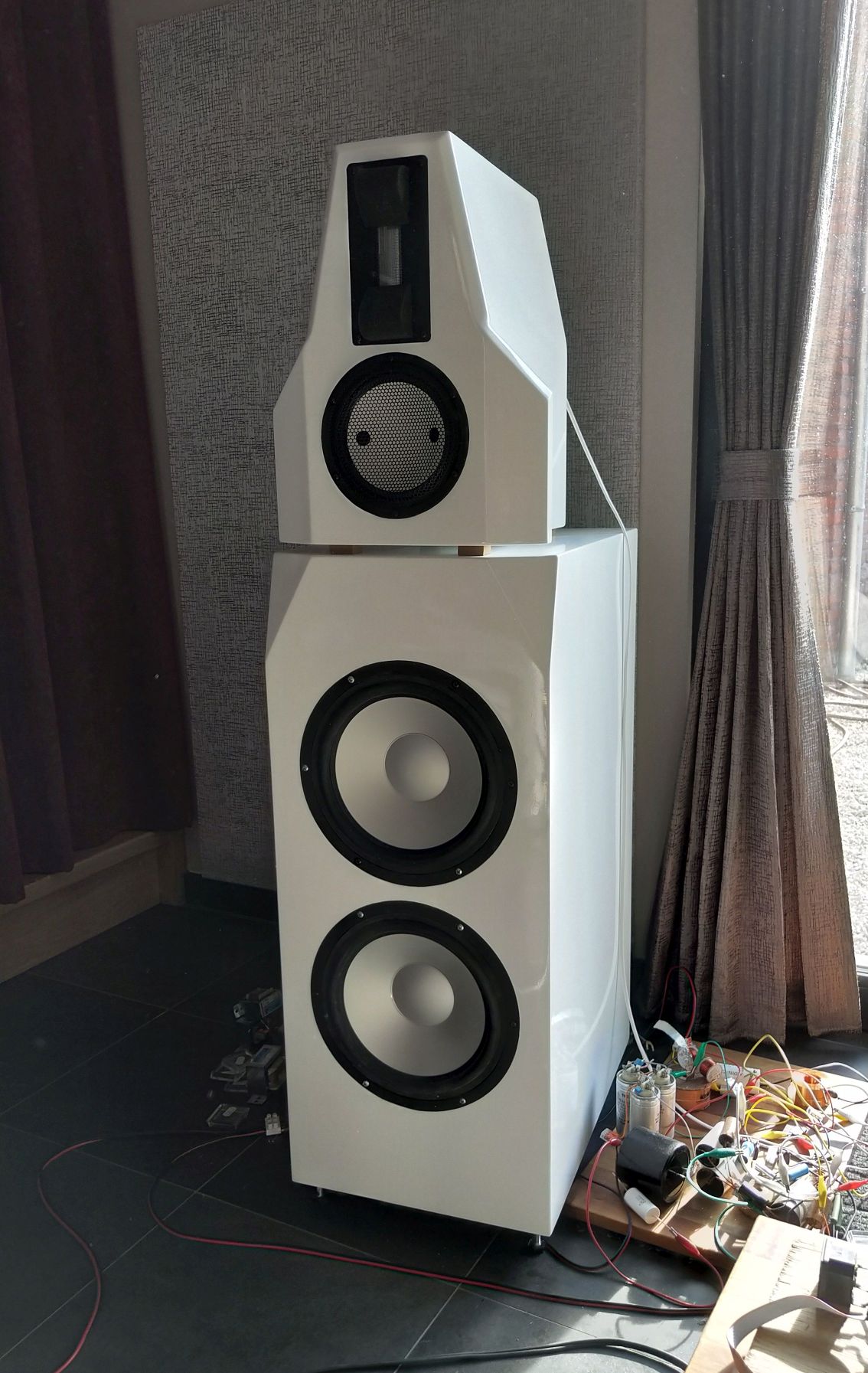

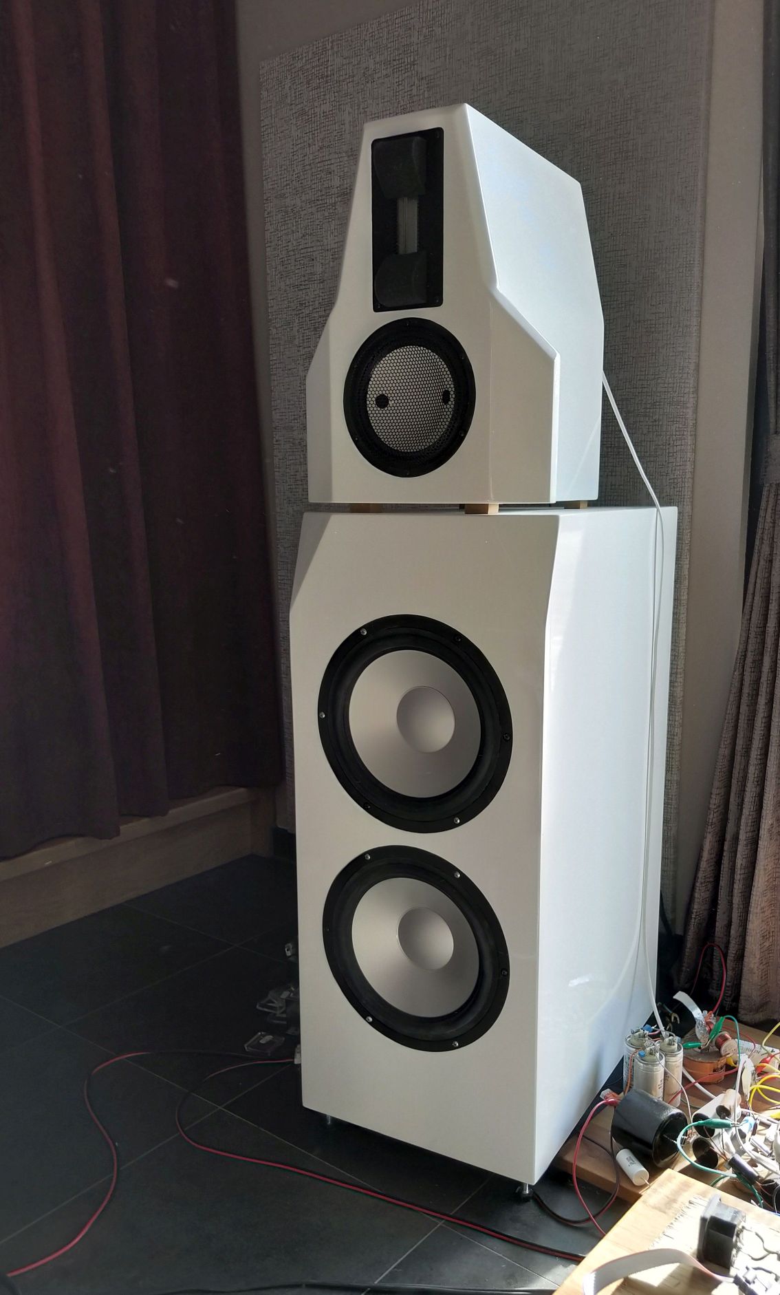

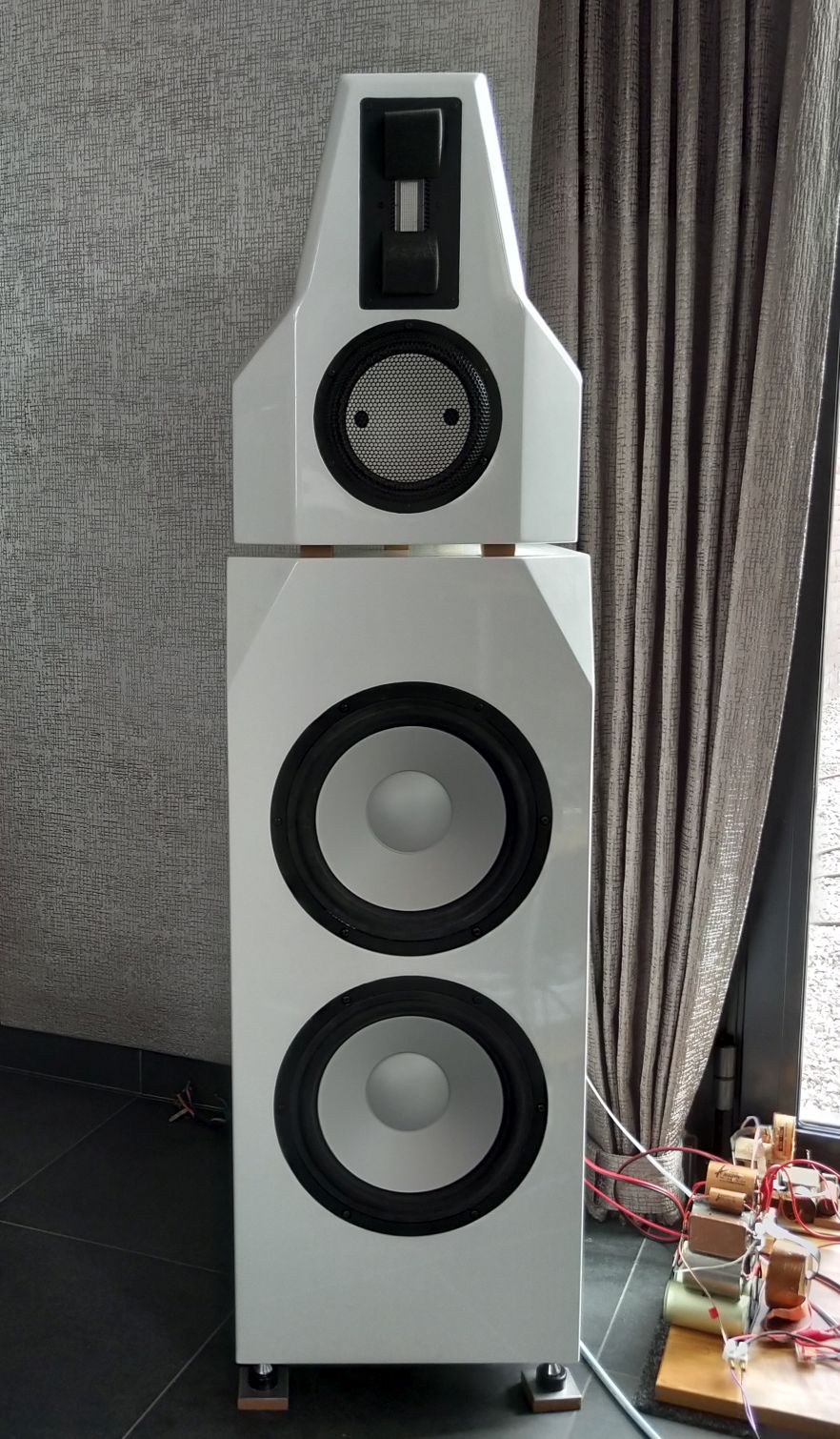

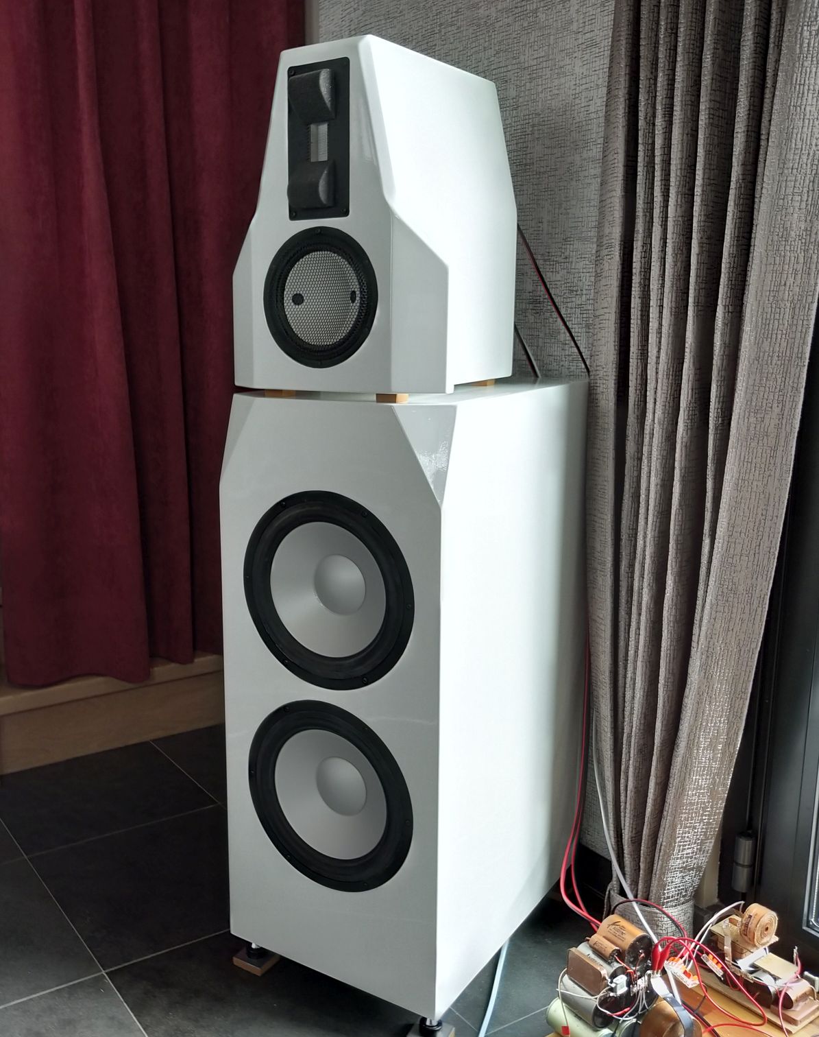

Refspeaker v2

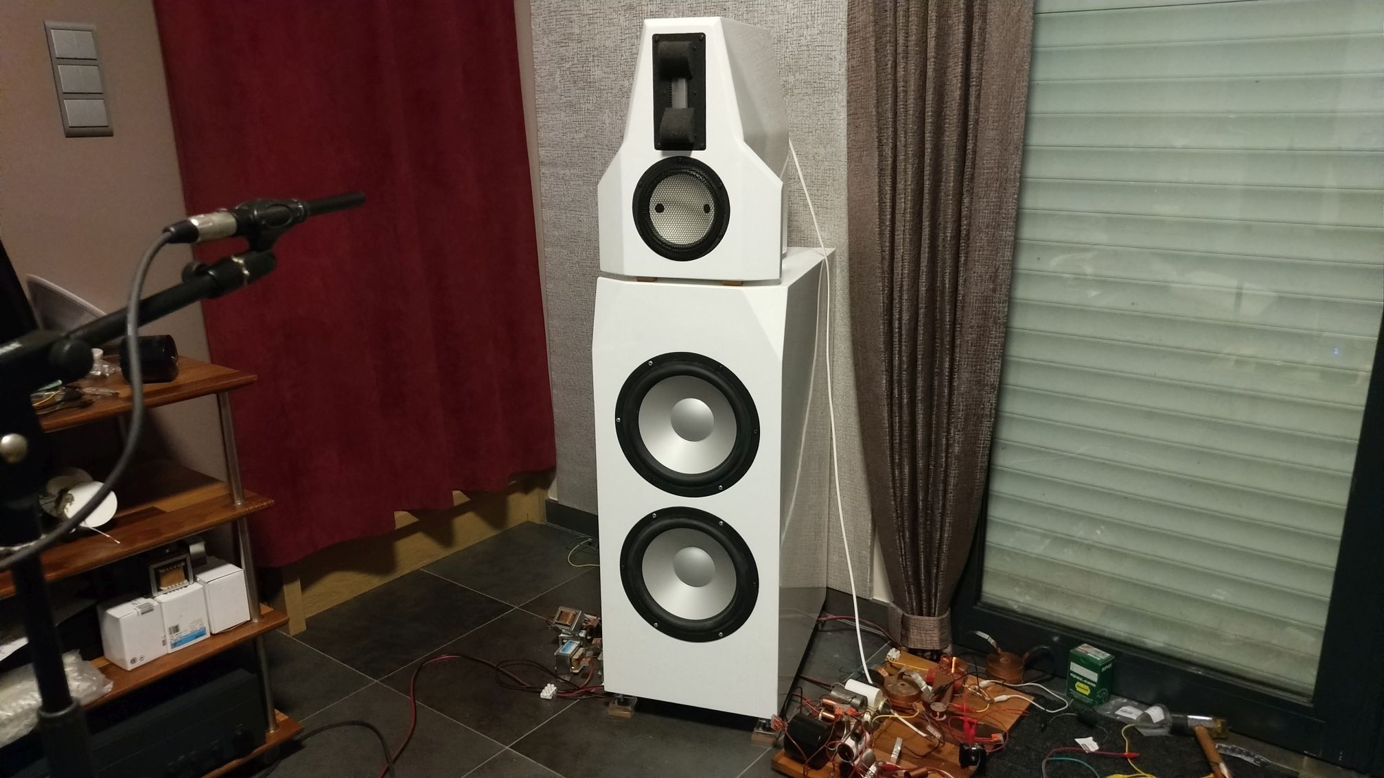

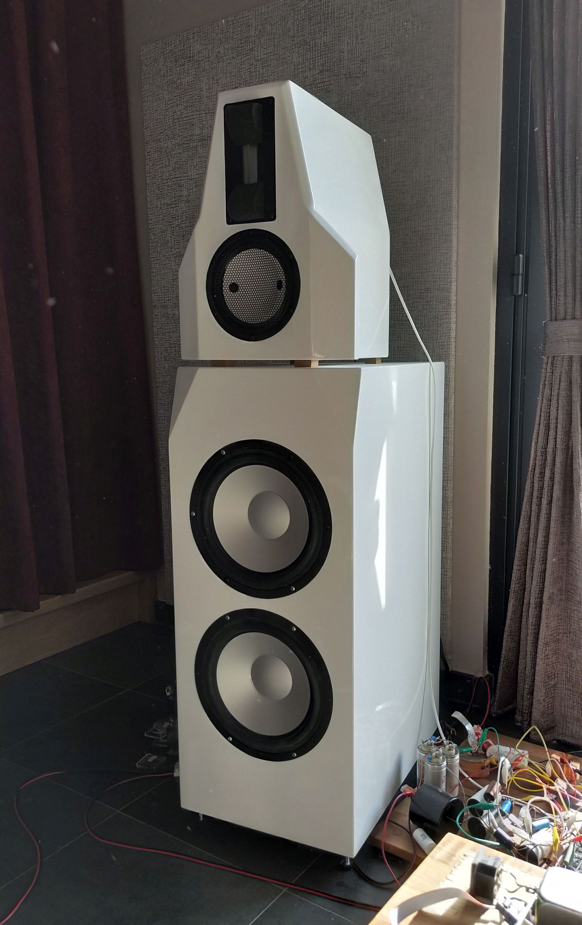

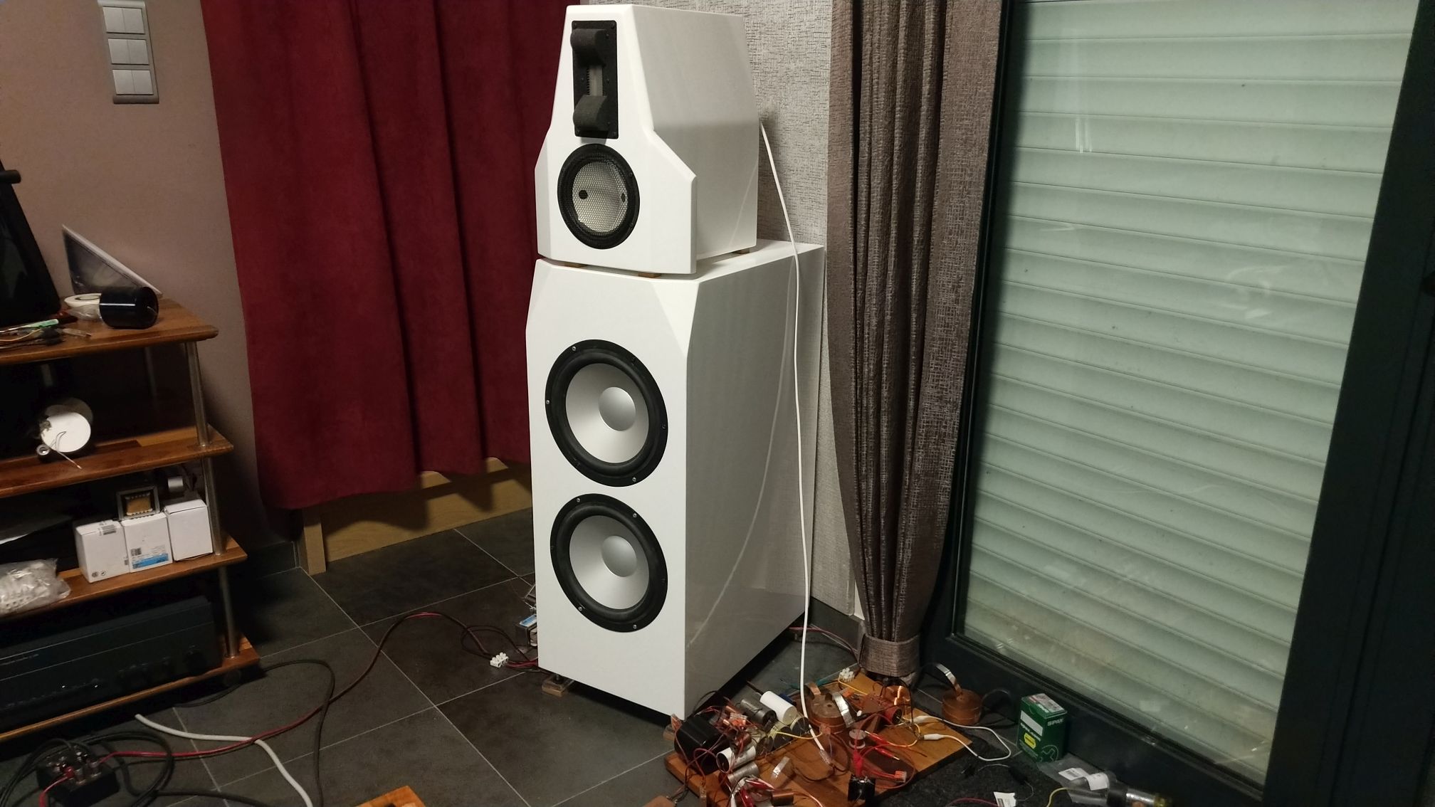

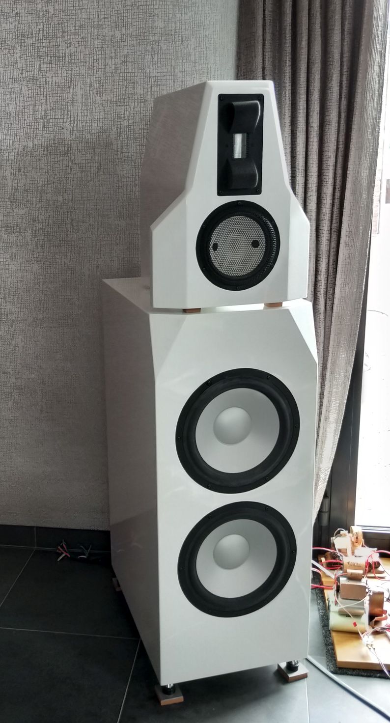

Five years later and it was time for an update of my RefSpeaker.
The new crossover is finally done, it took a lot of measurements and listening.
The FR is rather flat from 200Hz to 20kHz, below 200Hz it climbs to +3db more output, the bass goes to a low 23Hz.
I'll make a new thread but here are already some pics.
Danny

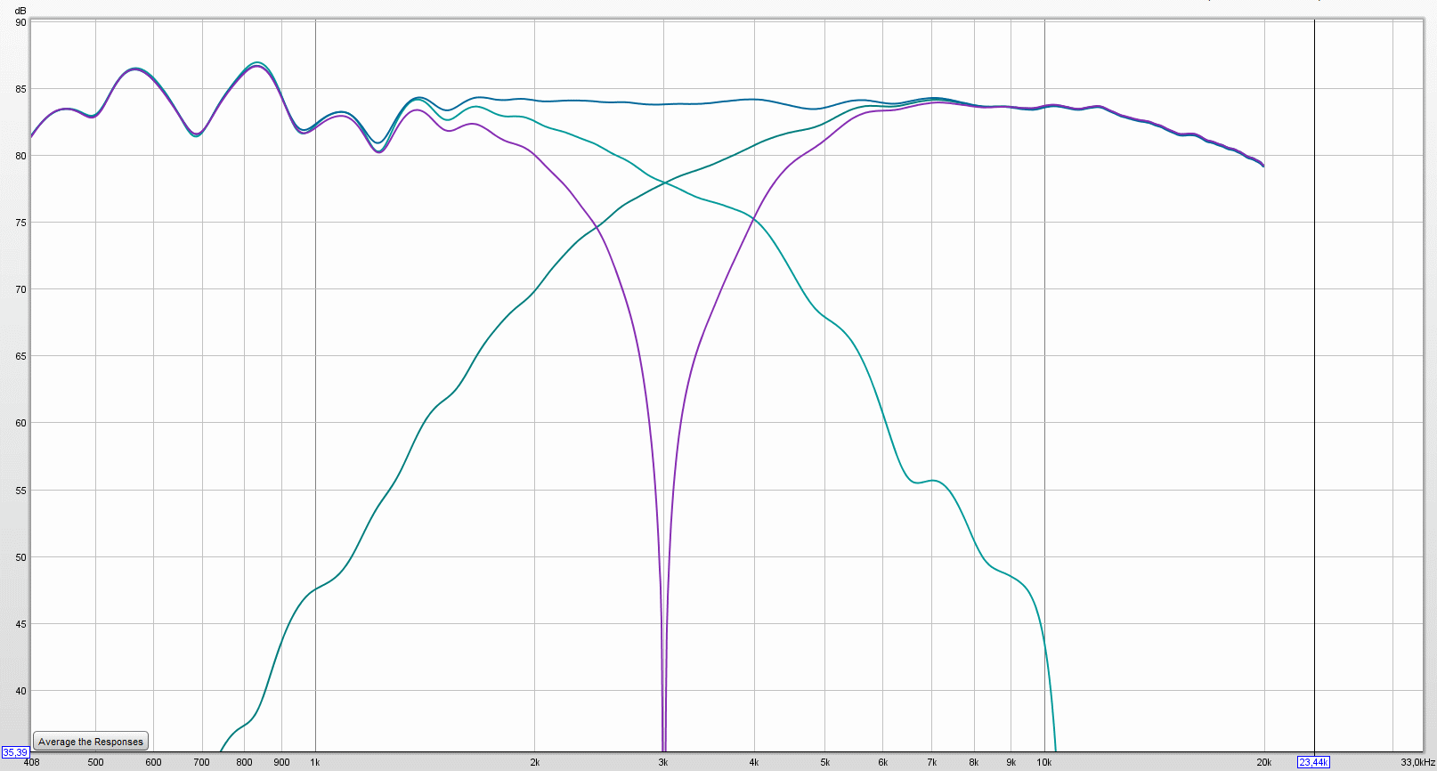

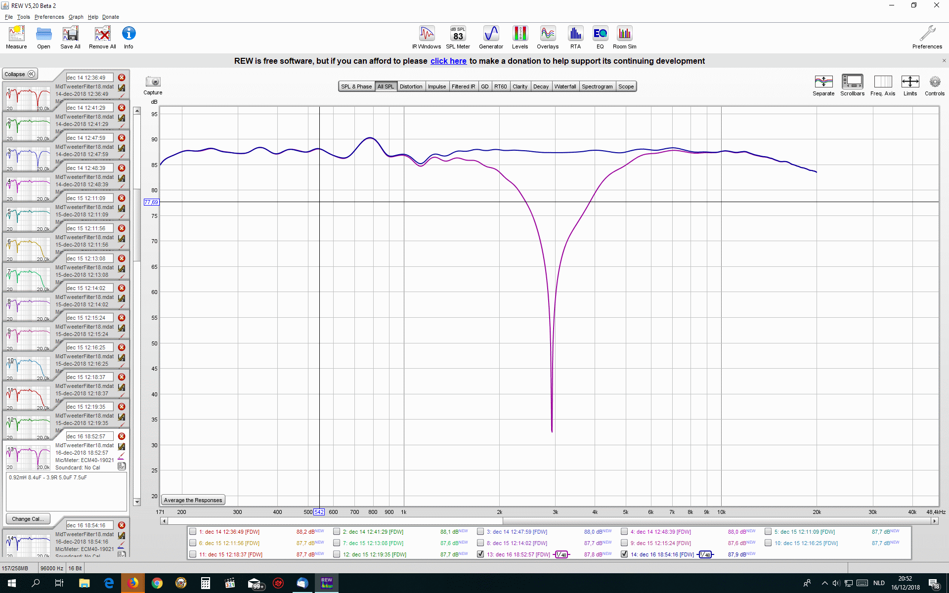

Version 2 is as good as finished, I just need to put the final mid/high crossover in the cabinet.
Bass cabinets and its crossover are already done.
Mid/high sounds good and measures good, finally 🙂
Phase between mid and high is good, on the picture I measured in room at 1.10m distance and height between mid and ribbon,
it shows four measurements: mid, high, mid+high, mid+high reversed polarity
At the end of the fine tuning I was playing with 0.5dbs more or less to get the voicing correct while playing test songs (100+).
It's amazing and disturbing how sometimes 0.5db at a certain freq range can make a difference.
