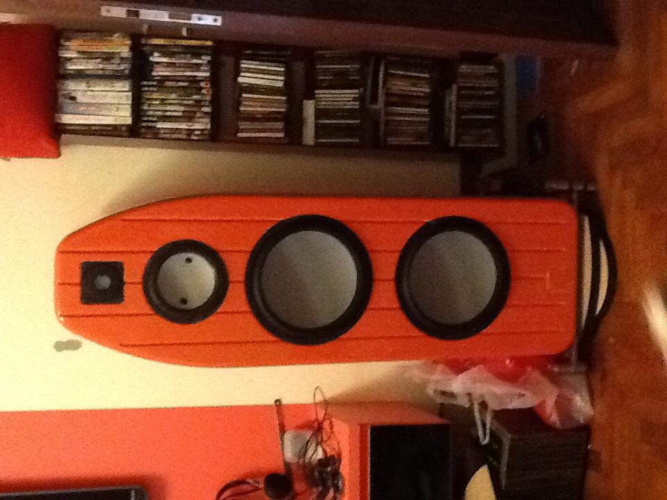

Hi Gaborbela,
It's not a sealed enclosure, the bass reflex pipe is at the bottom.
A sealed enclosure does not give enough bass extension with these drivers.
I used a down firing port, so I get the advantage of floor loading.
The port has an internal diameter of 7cm and about 12cm long (have to check it to be sure).
The cabinets are on Soundcare Superspikes with the 2 front spikes made 1.5cm larger.
To tune the port I used my microphone close to the port to see the output.
My cabinets are 75 liter, the same as yours but then for 2 drivers, that's a big difference !
Later this year I will make some 110 liter cabinets, to squeeze some extra dbs @30Hz out of them and also make them a little taller.
My cabinets have lots of bracing, the front panel is 5cm thick.
All the walls have thick green felt, behind the drivers there is some light stuffing but not around the port.
The sound quality is very good, a contra-bass sounds like a real contra-bass with plenty of detail.
Also with electronic music (like from Actress R.I.P.) there's plenty of very low rumble.
My cabinets with the down firing port work really good in my room,
with bass the room plays a big role in the result.

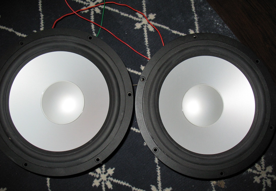

I follow some of your advise
Today I made some listening test on one Alcone woofer compared to two connected together and one Alcone with one Hi-Vi F10
I used a 4mH inductor for the test only
The two Alcone a huge step up to the one all do I prefer one Alcone with one Hi-Vi
The sound get more body, warmer and not as metallic (overly precise) like the two Alcone together.
Now I do live the metal cone woofers, for the last decade I listening a Visaton AL130.
To me somehow the one Alcone in 75L enclosure sounded thin, not enough low end a bit to cold.
I could not tested the two in one enclosure like yours! For that I would need a new enclosure
So that was the main reason todays test, I thought lets test it before I order one more pair Alcone.
I agree with you a larger enclosure would give better bass!!
Please take a look at these speaker, the two woofer got 96L.. Your plan for 110L in BR even better on simulation.
To me because I match the Alcone with the Hi-Vi the enclosure need to be totally separated from each other also I have to tune both separately.
Only the 4R or 16R impedance not the best to me but what can I do.
For mid Driver I use a Gorlich Podzust. Tweeter right now a Morel soft dome but later that can be replaced if necessary.
Thanks for the advise to double up the woofers😉
Greetings Gabor

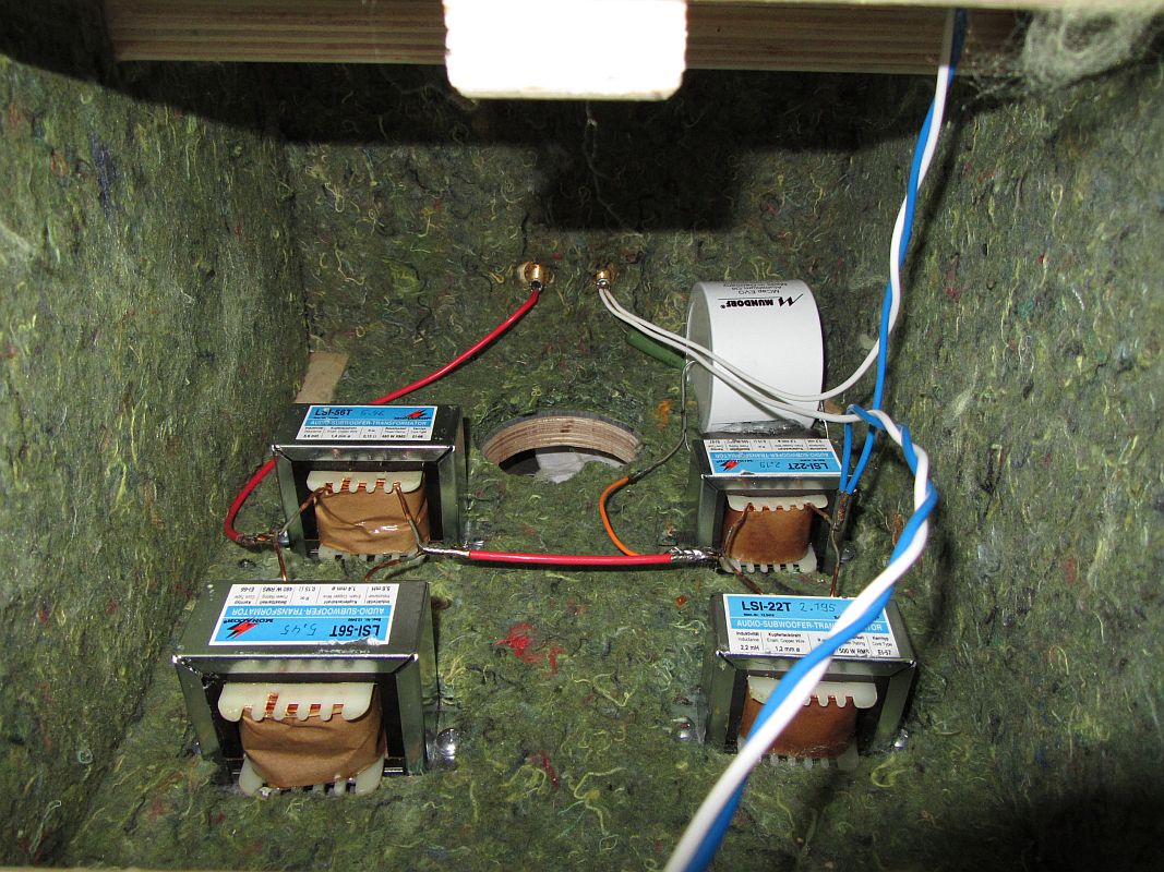

Hi Gaborbela,
With the 2 Alcones in parallel try the 4mh with an additional 70-100uf in parallel with the woofers, like in my filter.
That will suppress the cone breakup with 40db instead of 20db.
This could be the reasons that the Alcones sound more metallic.
If you use two woofers in parallel then your bridged Aleph will not handle it because of the too low impedance (3 ohms).
Why not use them in parallel or biamp ?
Two woofers are also better to counteract the Allison effect.
Two different woofers is not practical, in fact you'll get a 4-way, with separate cabinets and crossovers.
The total mH of the coils for the basses will be 4x bigger (=4x expensive).
Example: two identical woofers in parallel need about 3mH in series, if you use separate crossovers for the 2 woofers you'll need 2x 6mH to get an identical slope.
The Visaton AL130 is an excellent driver, I've used it also in another speaker for a decade. 🙂
The Podszus-Görlich looks also nice, very light membrane.
For tweeters their are many good choices: SB TW29R, CSS LD25X, TL N26C, SS Beryllium, KE25SC, Raal (ofcourse 😉 )...
Have fun !
Danny

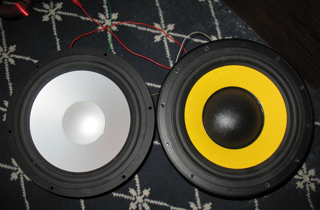

HI danny_66
Today I made more tests.
Yes the capacitor a parallel with the drivers helps a lot!
The sharpness of the Alcone totally disappear.
I compared the HI-VI/Alcone with the two Alcone using the capacitor.
The difference just got bigger for the favour Alcone/Hi-Vi duo with the capacitor.
I'm so happy because from a while (years) I look for decent bass for these project.
So many driver was tested 8" Vifa, Scan speak, Monacor, Audax, Beyma , some old used drivers from B&O and AD..
After I went up a size 10" Alcone, Hi-Vi F10
These combo together sound impressive, I will keep it that way , I'd rather spend more on the crossover knowing now I have the sound I was after so long time.
I was close to use a vintage JBL LE14A 14" Alnico signature series woofer.
Now these two better choice has better deeper bass.
I wish you have a friend or someone who has these Hi-Vi F10 woofers so you can easily test them together with the Alcone.
Again the two Alcone together was a huge improvement over just one per side.
Thanks for the advise again!🙂

More tests with better crossover components and some different music
OK these is my final conclusion on these comparison two Alcone VS Alcone & Hi-Vi duo
The two Alcone more precise the quality of the bass all the way to the low end much better!
The drum and bass and piano more separated, sound cleaner
The Alcone & Hi-Vi duo has a bit more bass and a bit warmer but not as precise etc.
If I would have the second Alcone pair I think after today listening I would go with them.😉
Now all these test until now was done with out enclosure, the drivers on the carpet next to each other.
Again the two woofer VS one is a huge step up! Using the capacitor parallel with the drivers totally get read of the sharpness of the metal cone but still remain precise and very well controlled.
Further test I will do on Monday, I'll lay done the two enclosure next to each other and I will listen these driver in the enclosure.
Let see from the enclosure if I get similar result.
I hope with these tests I do not mess up your thread..
Greetings G
Greetings G

Beautiful build, I am planning a similar setup but with GR Research servo subs and dipole RAAL ribbons. I may have missed it, what is the sealed volume for the C173-6-090 Accuton mids? Manufacturer recommended 4.5L for best transient response? Thank you!
GREAT BUILD!
And aperiodic is always the way to go in my book (for box speakers of course)
