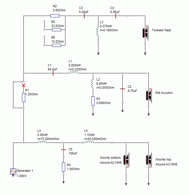

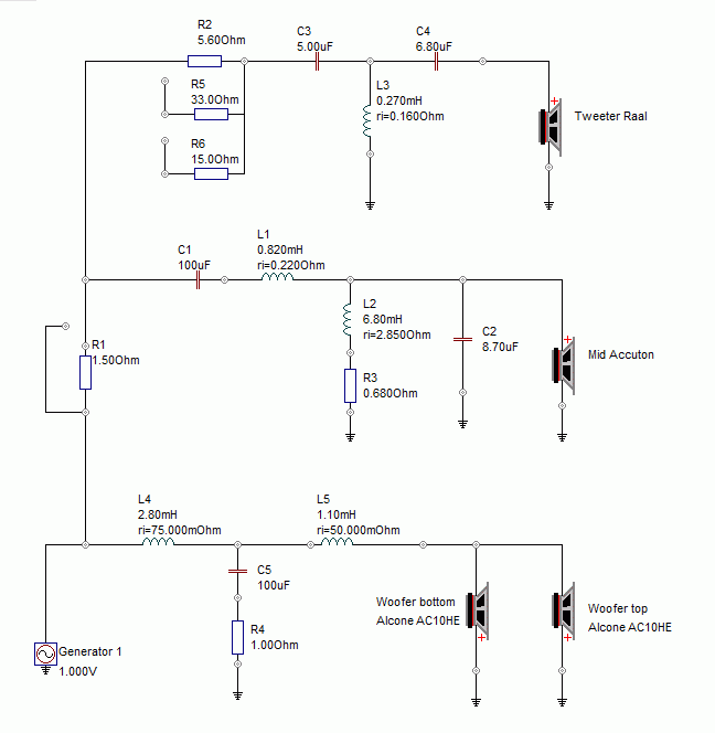

Here's the last version of the filter.
I've been playing with the value of the resistor R1 that is located before the mid/high.
It is really a balancing act: some recordings have more than enough bass, some not,
but I like a little too much bass than not enough, so 1.5 is a nice compromise 🙂
R1 must be a single resistor for the mids/highs, you can't use a separate resistor for the mids and another for the highs, otherwise the phase at the crossover point is changed.
So now I have a filter that's easily adapted to the room or personal preferences:
change R1 for more or less bass or change R2 for more or less highs, perfect ! 😀

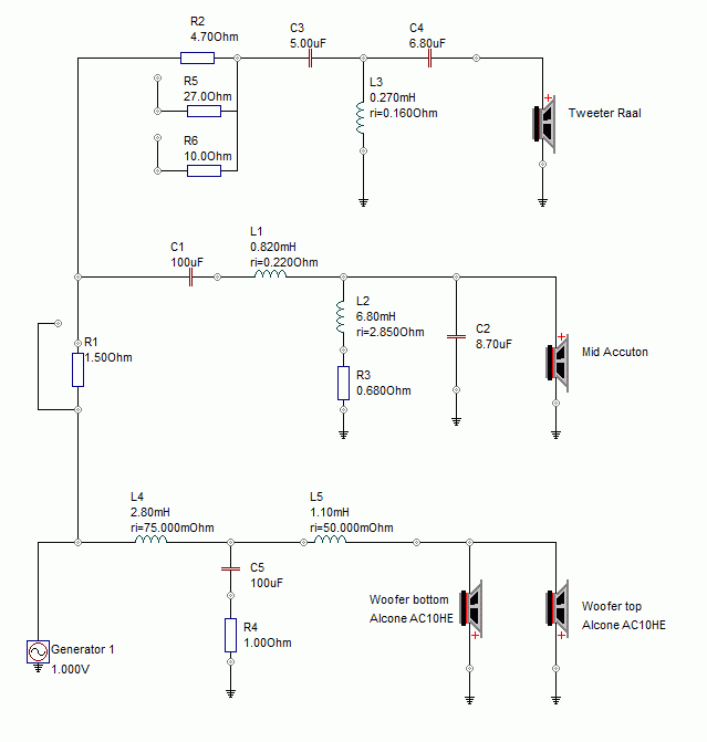

Here's the real final filter 🙂
Almost completely the same as the previous version, just a little less attenuation for the Raal ribbon.
I now have 4.7 and 27 ohm parallel (=4ohm) that gives 0.5dB more highs compared to 4.7 ohm

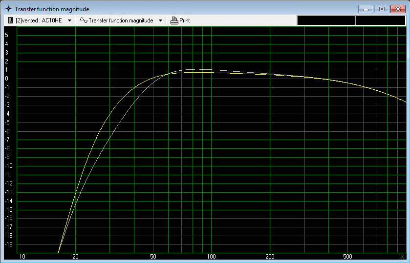

I'm planning to make a new version of the bass cabinet:
Same woofer drivers but just a little bigger: 10 cm higher and more internal volume.
My current bass cabinets are 76 liter, the new ones will be 110 liter, simulated in winisd (yellow) that gives me at 50hz +1db, 40hz +2db and 30hz +3db.
But the main reason for the new cabinets is that I prefer the sound (better soundstage) when I sit 10cm lower,
so I had the choice: buy a lower seat or make larger cabinets.
Larger cabinets give me also more lower bass, a lower chair not 😉
My current speakers are 120cm (woofers cab 72cm) high and my ears are at 120 high.
The new ones will be 130cm (woofers cab 82cm) high. Ears still at 120cm 😀
The mid/high cabinet and filter remains unchanged.
The filter for the woofers will probably change from 3rd order 2.8mh-100uf-1.1mh to 2nd order 3.1mh-100uf, but I need to test that and take some measurements.

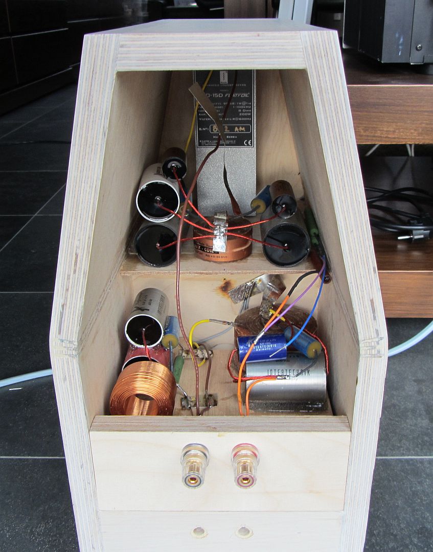

Now that the crossover for the mid/tweeter is finalized, I have rearranged the cabling and the crossover components in the mid/ribbon cabinet.
Here's some pics, in the first you see the interior of the 3.5 liter mid cabinet filled with about 15 grams of Twaron angel hair.

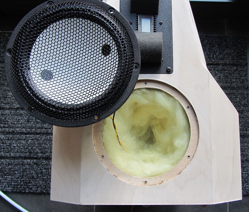

The backside of the mid cabinet is irregular shaped.
In the second picture you see the back of the mid cabinet with the aperiodic vent sticking out and 9x10uf of Siemens MKV caps.
The aperiodic vent is a PVC tube of 4x10cm filled with less than 1 gram of Twaron angel hair.
In measurements the aperiodic vented mid cabinet doesn't react like a bass reflex but more like a closed box.
At first I tried a closed mid cabinet but the aperiodic sounds better to me,
I completely agree with Troels: "I don't dig closed boxes for larger midrange drivers! It kills the midrange."
In the last picture you see all components in place, the siemens MKV caps at the bottom (hidden), above that the components for the Accuton mid and on the third level the components for the Raal ribbon.
All playing very nicely together 🙂
