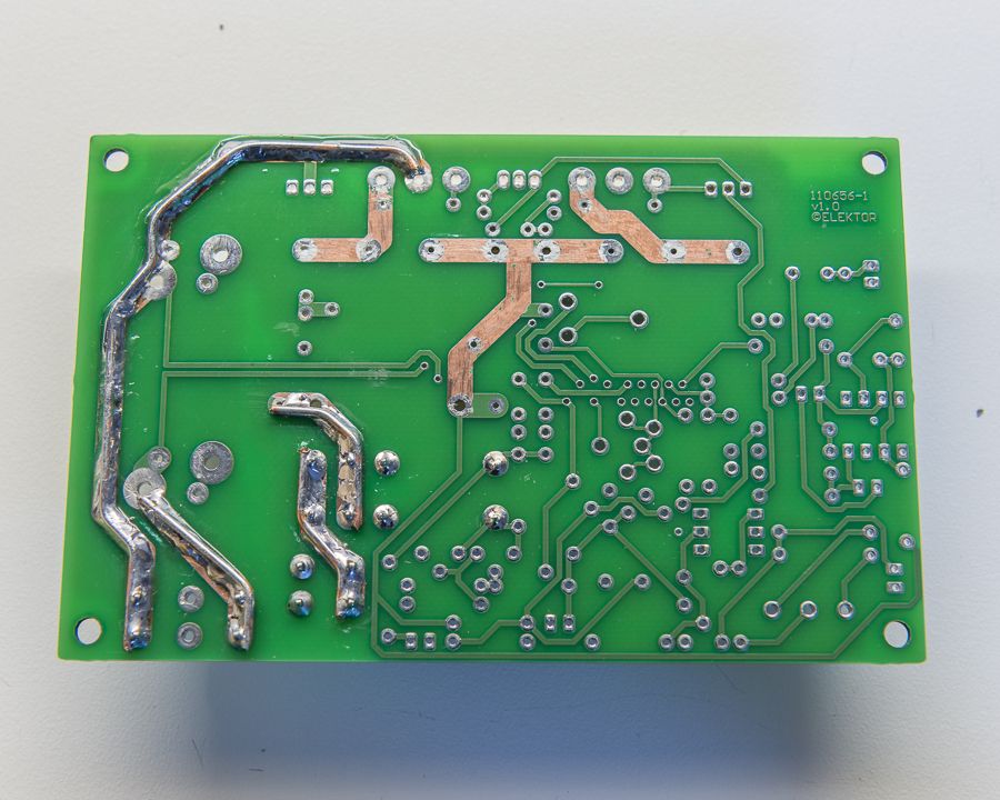

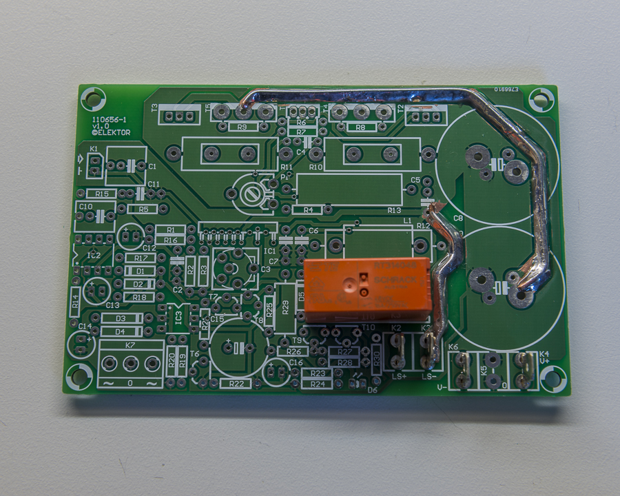

The first thing I did was to solder a 1.5mm2 wire across the pcb traces who need to carry a lot of power. I’m a bit skeptic about thickness of those traces… So this is what I did:
<see image 1>
<see image 2>

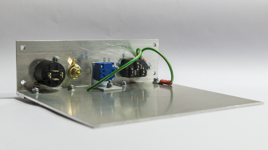

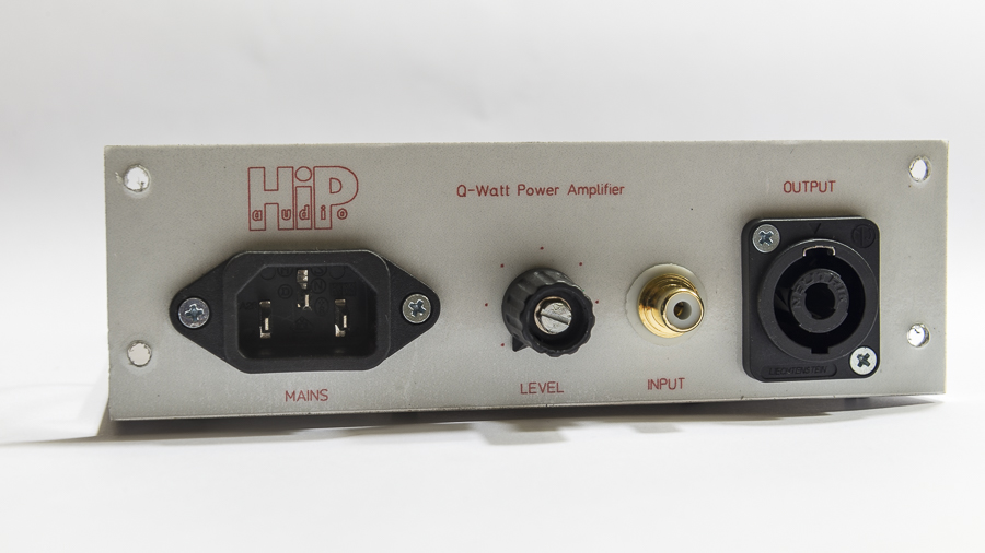

I left the electronics part rest for a while and started with some of the mechanical build of the enclosure. The back plane consists of an aluminum L profile of 50 x 20 x 2. It has the same with as the SK85 heat sink I’ll be using (160 mm). The back plane holds all the in- and outputs: mains, level adjust, input and speaker output connectors. I made the “front panel” myself and printed it on a label. After applying the label to the back plane I used a clear adhesive foil on top of the label. This must protect the label.
<see image 3>

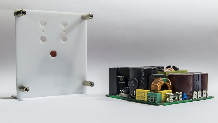

I’ll be using a SMPS for this project. Initially I planned on using a traditional transformer but the size and weight made me change my mind. I ended up buying two SMPS500R power supplies with 2 x 55 volts. These are 500 watts power supplies and they get very good reviews. The SMPS’s are smaller, lighter, cheaper and should provide better performance than a traditional transformer based power supply. I’m curious about how they will perform. The SMPS’s will be mounted inside the enclosure by this mount:
<see image 5>

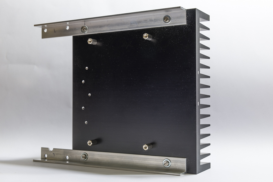

The back side of the enclosure is largely made up of the heat sink. The amplifier PCB will be fixed flat against the heat sink in order to save space. There are two aluminum L profiles of 10 x 10 x 2 to fix the heat sink to the back plane. The PCB will be screwed on 4 metal standoffs of 10 mm:
<see image 6>

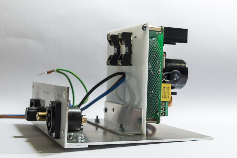

The mechanic construction is progressing well. Here is how the power supply is fitted in the enclosure:
<see image 7>
