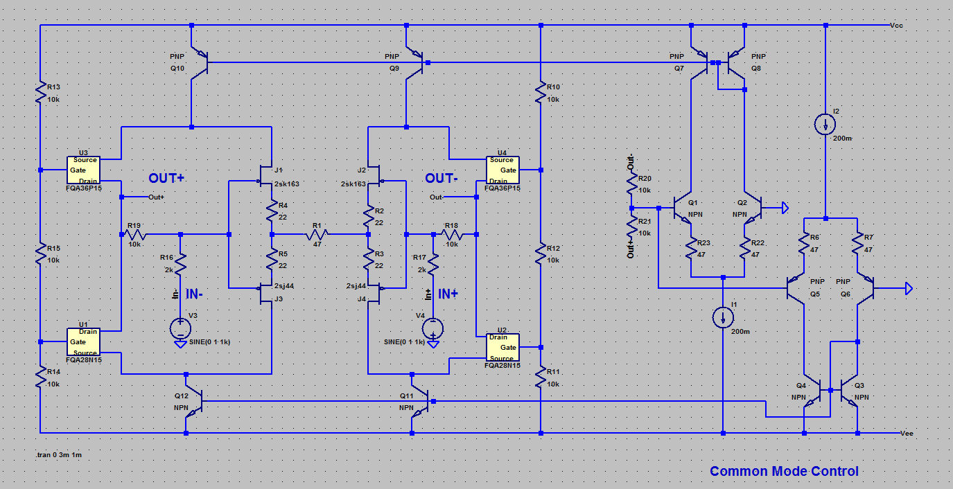

The current mirrors would have added a lot of complexity IMHO, but for how much improvement?
Both independent shoulders will be virtually kept relative to ground, so a way less biasing. Check attached sch.
And, I am not sure to remember anything about servos in JC's comments
Not clearly a servo, it will not remove any DC, but will symmetrize shoulders under non symmetrical input.
nice schematic.
Heh, yes, being well feedback-depth optimized it could be unbal->bal converter too. Or pick unbal signal to drive bridged push-pull output stage.
Also it could be very elegant true balanced amplifier core.
Frontend have very good intrinsic CMRR, so common-mode loop will mostly help to minimize the need for precise matching.
Literally there are four long-tailed pairs competing with each other through self-biased core.
So SuperSymmetry as well.
Did you measure the harmonics of this stage, with real , not super-matched transistors?
