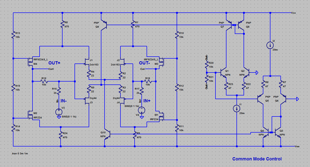

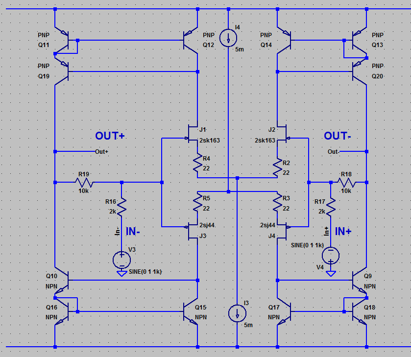

Also with independently biased LTPs could be designed something like this.A very useful circuit indeed.
I just wanted to check if the correction of mismatching that your circuit provides actually changes the distortion profile. I found that mismatch shows up as distortion, maybe 70dB down but still tells us something...
And of course you are right, distortion only is not enough, and with feedback a lot of issues can be covered (and some others brought forward).
I like that circuit, simple and elegant! do you control the corner frequency of the common mode control somehow? It seems it provides a lot of CM gain in the audio band
Bad case matching obviously results in 1ma for 10 ma devices. This could be mostly eliminated with slightly different source degenerating resistances.
No, i haven't tuned that behaviour now, but there are nothing complicated.
Yes, curent-mirror-loaded LTP could provide up to 60-70 dB gain, so, again yes, loop could be unstable without proper tuning.
Oh, yes, mirrored second stage have much more swing, check attached.
