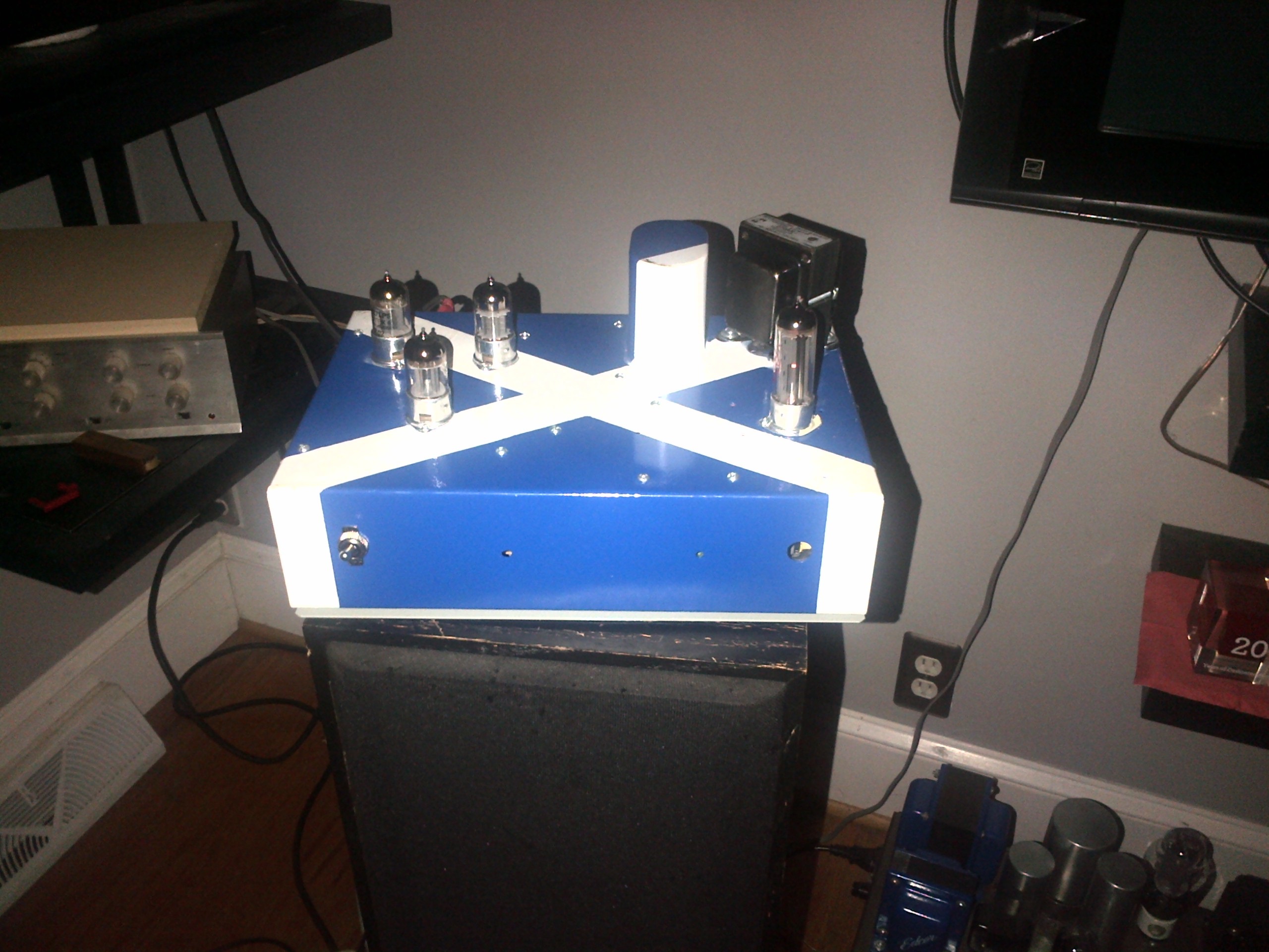

Another 834p phono build
hey - too many new phono threads to start a new one, but to resurrect one i based my most recent whim upon, here's a pic of my newest build - and i'm no scot, 'cept in spirit and maybe my mom's mom's mom's side, but who ain't ;^) - used the schematic except slight diff. on PSU, using a choke off first filter cap which is 20UF motor run and proceeded from there. Lot's of gain with my shure Vx15 blah blah - no hum at all, kept signal's as short as possible and mainly used P2P with perfboards for the PSU 'modules', all in same 12X8X3 hammond steel box...
Hi There, i dont know if anybody is still reading this thread, but i have just built this and it sounds wonderful, however it has an annoying hum, not sure if i have just try'ed putting to much into a smallish box, or is its filtering on power supply, or ground loop, any advice would be really appreciated, ill upload photos later. regards, kevin.
