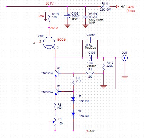

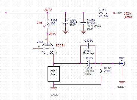

Algar, the second would be my preference. Since doing my own buffer preamp, I've given up the adjustability option on the CCS and just set the current approximately with a fixed resistor. You might have to tweak the RIAA values a bit to account for the better source impedance and bandwidth, but the overall distortion will be better and the conformance with tube age and variation will likewise be better.

Okay, but the cathode on the follower should only run a few volts higher than the grid... if it's closer to the plate, then it would appear you're not drawing any current thru it, adding resistance between the plate of the driving stage and the grid of the cathode follower won't do anything as the grid does not draw any current. It would appear you have either a wiring error or a bad component.

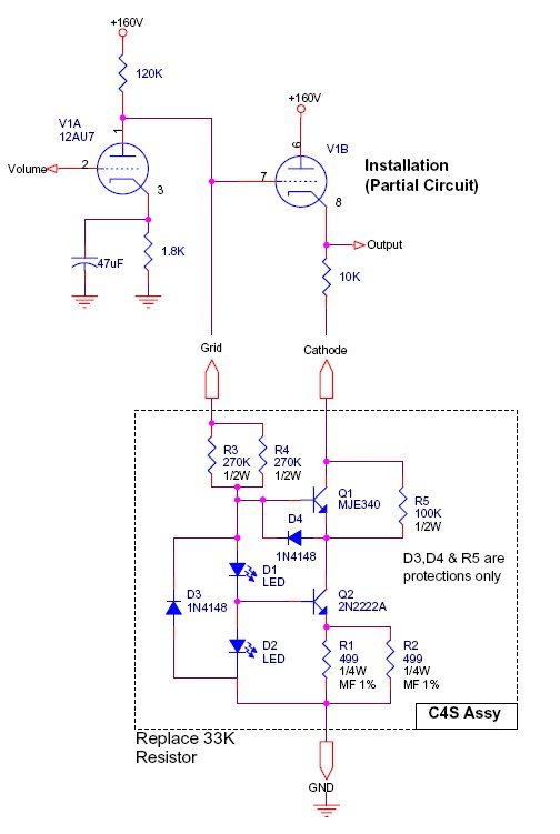

I may try SY suggestion of using a CCS in the last section cathode.

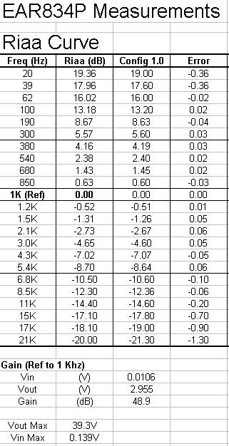

Had a few minutes to take some measurements on my phono preamp.
Riaa curve is almost perfect <1Khz, >1Khz error start to increase at 17Khz. It may be due to my crappy audio generator not been perfectly flat in frequency either. I'm on the road and don't have access to my usual HP test gears. All in all seems to be pretty good.
Gain: 49dB
(lower than 53.2dB of the stock unit, but it may depends on the tubes I'm using at the moment)
Vout max: 39V
Vin max: 0.14V
Check the complete results below.
Gain: 49dB
Vout max: 39V
Vin max: 0.14V
