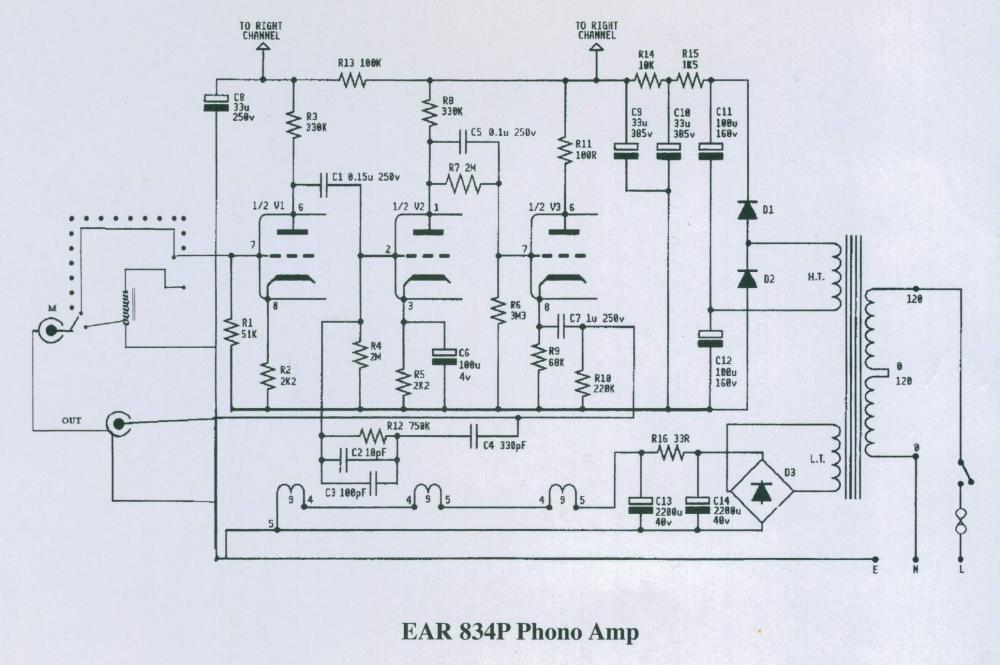

But yes i start whit Riaa EAR 834p and hop to do more build
