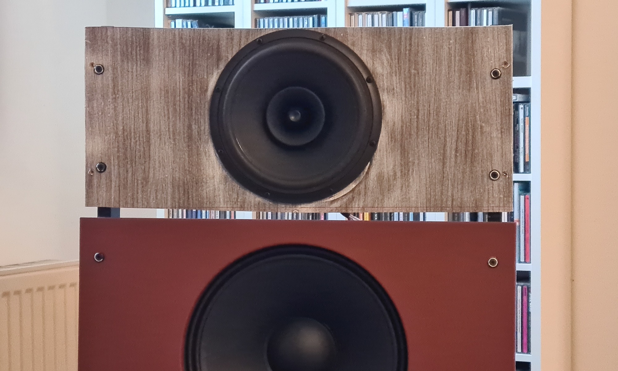

I have a nasty basket resonance but only in this one baffle.
I loosened the screws a bit and the resonance was gone for a while but came back, I think because the material is "recovering" i.e. working back to the original form. When the resonance was there again, I pressed down the front frame of the basket with my fingers and the resonance was gone again... I will probably have to play with it a bit and maybe I need a "layer of insulation" between the basket and the baffle, the driver itself only has a very thin layer of sponge.
It's a really annoying problem, especially when you have two identical baffles😛

Well, it's weird... I still have the nasty resonance in one of the baffles and have no idea why... a swapped the drivers - no difference, it's the one baffle. I changed the baffle (this is the ugly trial version) - no problems, altough this is the very same material (was cut from the same MDF sheet) with the same cut out. Weird...
It's funny because the old ugly baffle is covered with a self-adhesive plastic "veneer" sheet.
But... why just with one baffle? I have six of them...

Short summary:
Yeah... it's not so easy... now I have resonances with the old ugly baffle too 🤔 🤪
And I think it's cone resonance, no, I'm pretty sure.
Short summary:
- resonance starts in the right speakers FR baffle/driver
- replaced the right driver (thoughtit's damaged), but resonance still here, left driver unchanged, no resonance there
- swapped the baffles, right with the new driver to the left and left to the right, the resonance was now in the left speaker
- swapped the drivers, the new one from the left to the right, the other from right to the left, the resonance is still in the left speaker, so it has/should nothing to do with the driver
- changed the resonating baffle to the old ugly, there are the same resonances at certain frequencies
- why no resonance in the right speaker, it started there!
- can deep frequencies resonate the FRs cone? If yes... is this FR unusable in OB?
- if it's cone resonance... well, I don't know what to do
maybe I should change the distance between wall and speaker in order to "adjust" the timing of the indirect, reflected sound?
- it's not funny anymore

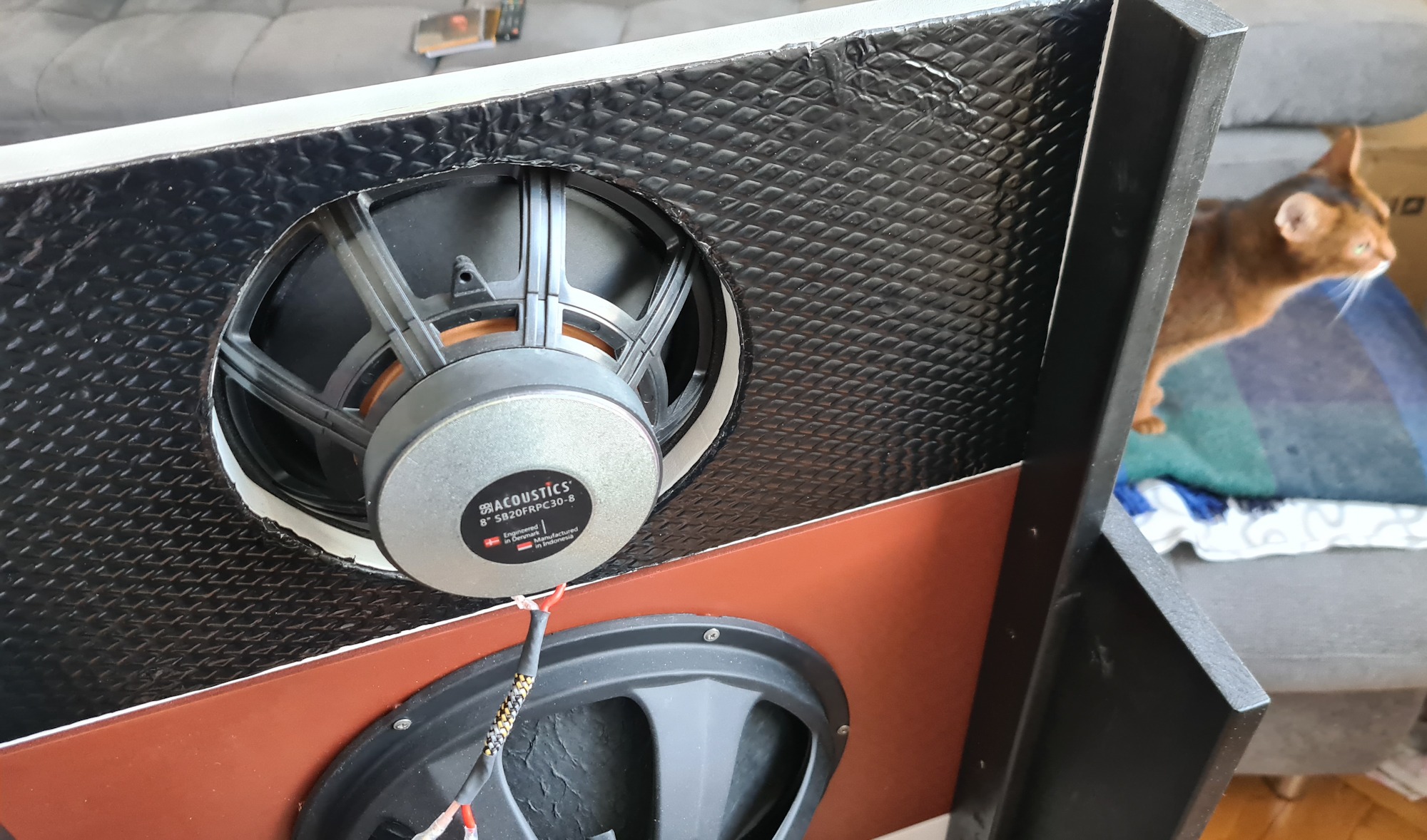

Well... it WAS a baffle resonance... yes, it WAS, Noico is my friend 😀
Covering the backside of the baffle not only eliminated the resonance, but also "cleaned" the treble and midrange, it's now somewhat more airy, gorgeous 😍
And yeah, it was... intuition
Now it was a long listening session, and I'm really amazed 😍
The development of the mids is really great, but even more that of the highs, if it would be a completely different speaker.
The stage has now also more space, and the instruments are unbelievable well placed. And yes, more and finer details.
I think the baffle resonance killed all this things to some degree.
