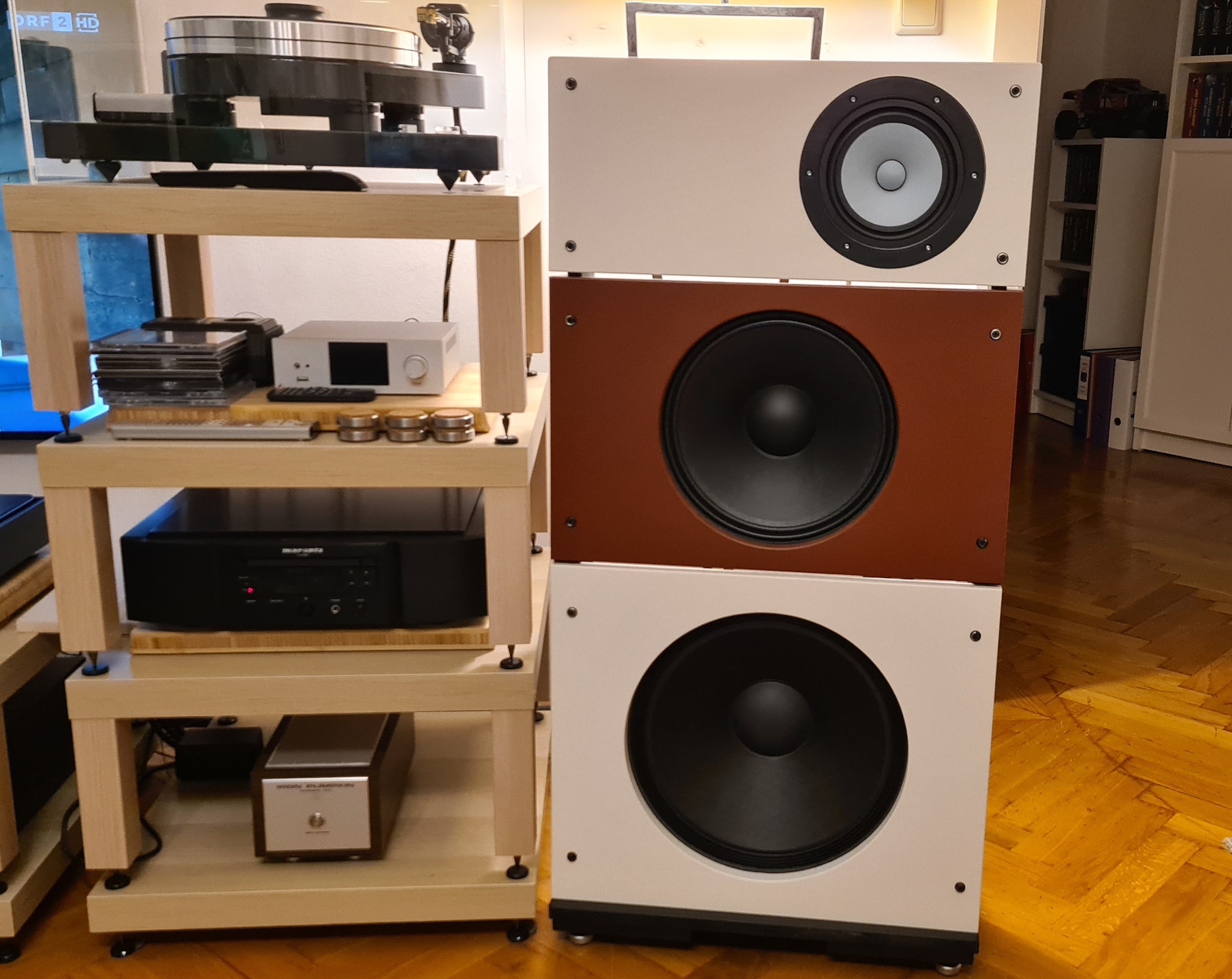

Is there a reason for the horizontal gaps between the baffles? (I know PAP are similar, but would assume they leak sound and thus increase cancelation?)

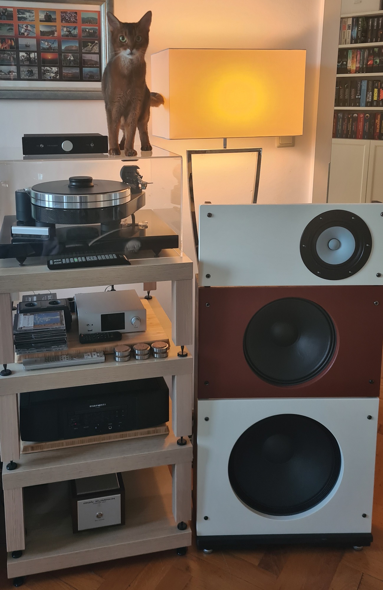

Sound impressions - now, this is just a new cloth for the trial speakers, but new parts for the xo, so the basic characteristic is the same as it was at the end of the endless trials, but somewhat more refined. Very open and very clear sound with big (in fact, biiiiiiiiig) stage, great spatiality, superb location of the instruments with a very coherent sound at the same time. Crisp highs, goosebump mids - and yes, powerful bass, even if there is no kick into the stomach🙂
The gaps... I think around December I splitted one of the big one piece baffles because I wanted to try a different driver configuration (D'Appolito), but I didn't like the sound... So I mounted the now 3 baffles in the old (and current) configuration, while the other baffle was still one piece, and made a comparison... the result was that (in my ears) the one with the separated baffles and a gap of about 5 mm sounded cleaner, with more definition. Surprise 🙂 Out of curiosity I increased and decreased the gap, and noticed a significant quality loss above 6-7 mm, while decreasing of the gap had no effect (in my ears). I can only think that with the multi-part baffle the resonances are not passed on and thus the baffles and the drivers have less effect on the others. But this is of course far from a scientific conclusion 😀

What FR range driver did you decide was the best sounding? The photo of that top driver is only partial, I can't see which it is. Also, baffle board dimensions and tilt-back angle (if any)?
I had to replace the SB Acoustics FR by the Alpair 12P, because one of the SB's has a strong mechanical noise/distortion... Sadly, it's currently not available here in Europe...

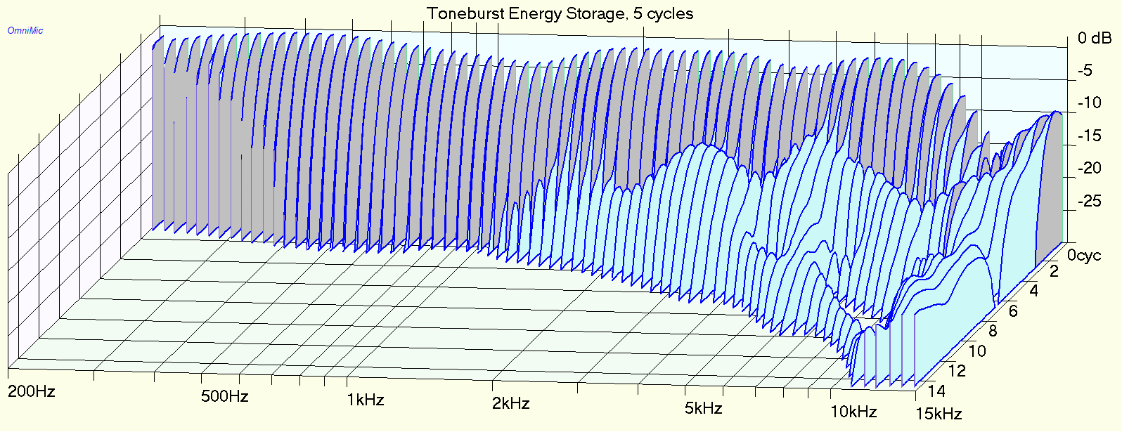

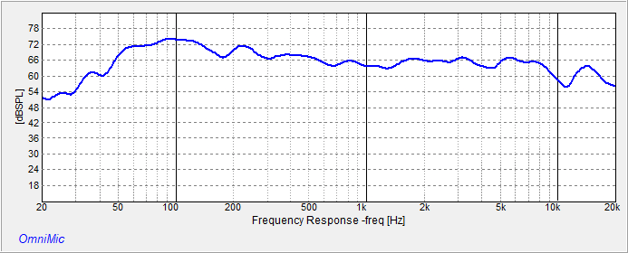

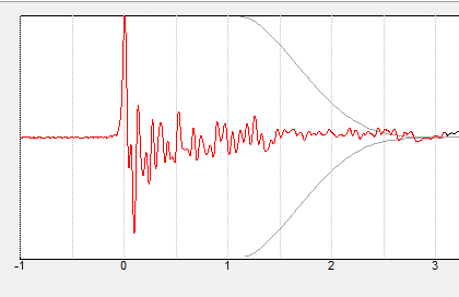

Today I made some measurements, like frequency response, impulse and waterfall.
The fr response looks good to me, it's tilted to the right - however, there is a through around 10 kHz, maybe a room issue (I have some high frequency echoes) and maybe a driver issue too, the A12P is somewhat uneven in this region. But - I don't care much, this is a region for people with 20-30 years of age, not 50+

The impulse response is - I think - not that bad, but please correct me.
And the waterfall... honestly, I can't interpret it
Here a picture with the new driver and the graphs 🖖

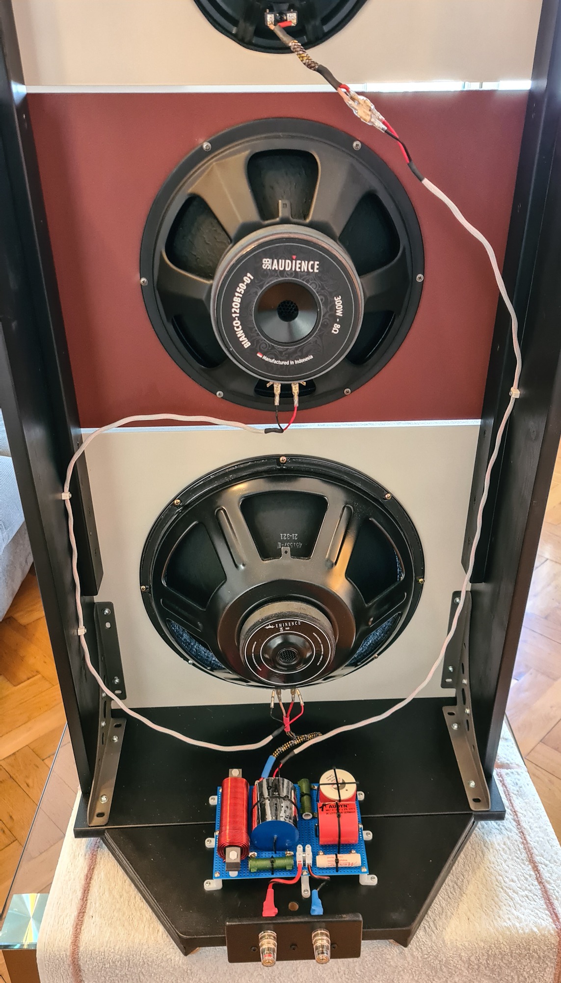

Moving to DSP with separate amps for each driver is quite different than what you’ve accomplished but may be worth a look. I currently have the MarkAudio 12P running full range in a MTM and enjoy them but have begun gathering parts to assemble an active 3 way using the driver’s from a passive open baffle system. Very much enjoying reading about your journey. I really like the brackets you used.DSP provides the opportunity to mess with crossover frequencies, slopes (orders), sometimes delays - etc - at the type of a number on a GUI. So you can experiment to your hearts content and when you find just the right combination that sounds how you want - then cast it to an RLC crossover network. That part doesnt happen just like that, as you already know, but the discovery part is much less painless.
The kicker is, for DSP each driver needs its own amp. So you'd need a six channel amp for the DSP box to drive for your 3 way, if you want to listen in stereo. (For measurement only, 3 channels would do). The reason why hardware speaker crossovers are still used? No one wants six channels of amplification when two would do.

It seems there are no further design changes required, so here the baffle sizes, made of 19 mm MDF:
15" woofer 550 X 450 mm
12" woofer 550 X 345 mm
FR 550 X 240 mm.
The baffle is tilted in about 5 degrees, with more or less tilt the amount of the bass is slightly adjustible.
There is a 150 mm wing on both sides along the woofers.
That's it 🙂

Next planned step: change the xo in order to get all three driver in phase, without connecting the FR inverted.
