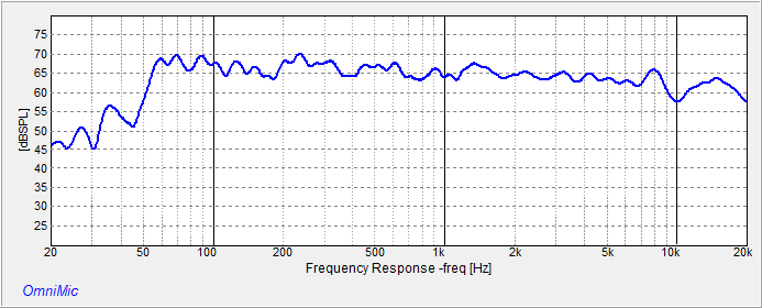

I understand what you mean, but I think that an assessment with a cell phone recording is simply not possible. Here is the measurement at the listening position:
